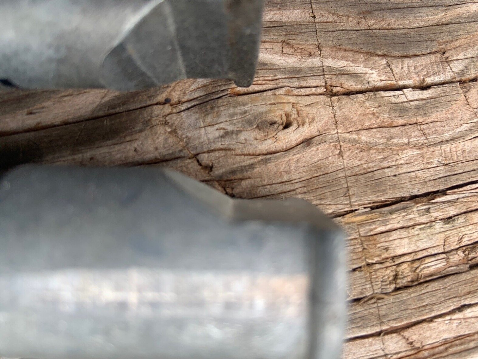

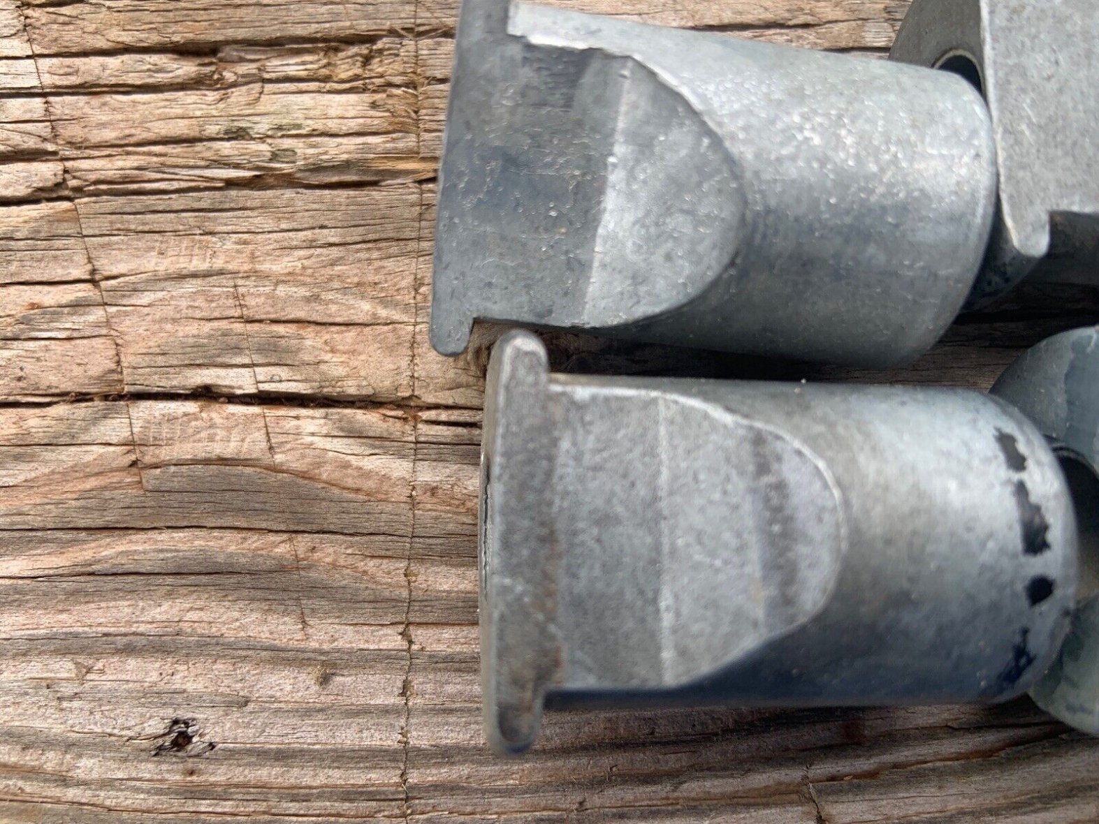

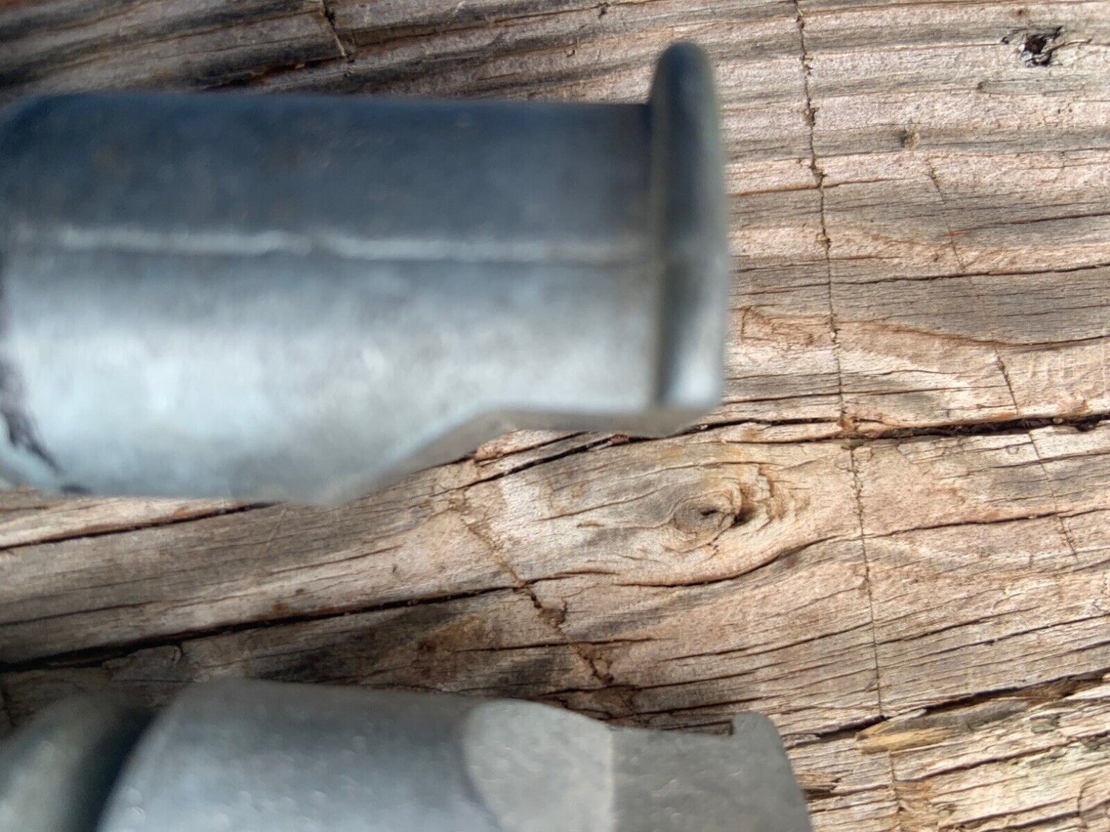

I'm in conversation with an eBay seller, regarding 4 used wedges he has for sale. He's unable to tell me about any wear on them, probably because he's not familiar with what new ones look like, but he's been kind enough to send me some images.
Can anyone please help me out, as I can't tell from the photos whether these are fully serviceable:

Those don't look like 520 Carriage wedge locks to me! What is wrong with your current ones?

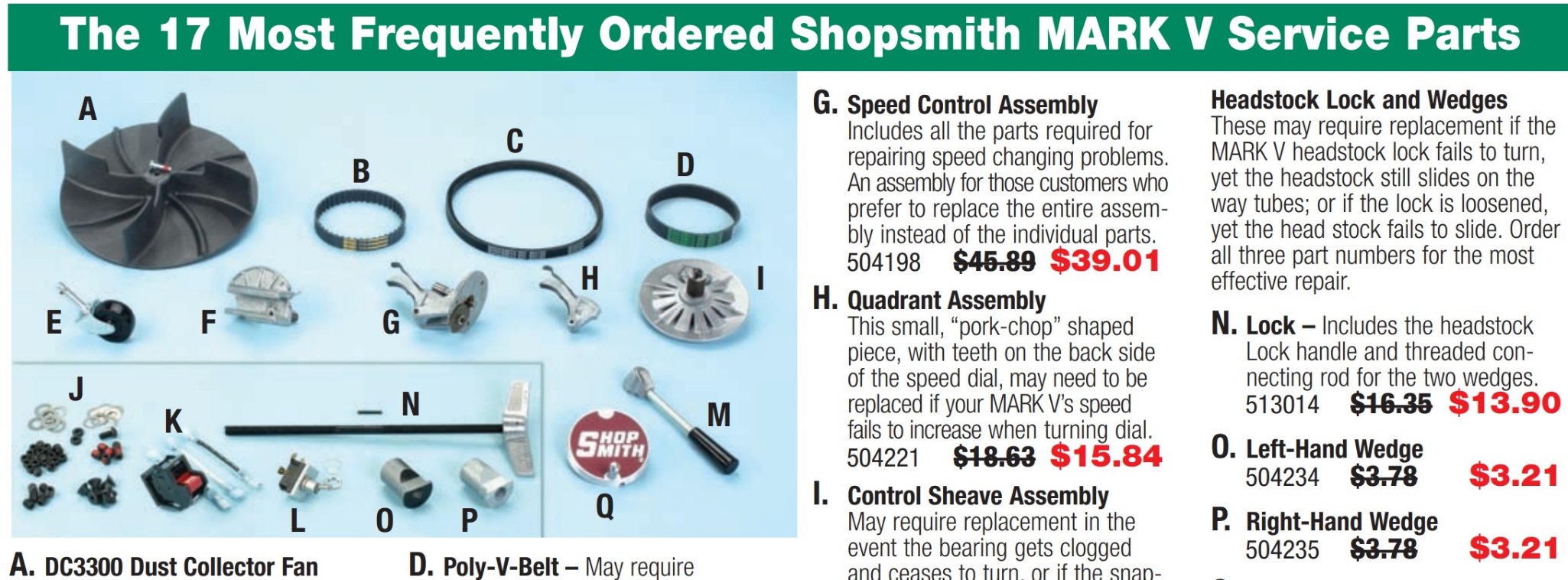

Sure looks like Shopsmith wedge locks to me (see "O" and "P" below in pic. Only question that I have is why buy them used? IF you intend to replace them they are dirt cheap so I don't really understand the desire to overpay for a used version on eBay...pic below is an old one so they are a little more expensive now but still affordable.
Re: 520 carriage lock wedges
This is not something to buy used. Those parts are inexpensive purchased new.
