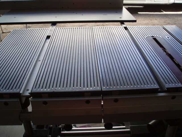

Make sure what you are wishing for and then go for it. I put mine on an extension table but I'm thinking about moving it to a floating table.
Then on the other hand, I may just make two more configured as floating tables with on tracks on opposite sides.
Crosscut Capacity Expanded.JPG (164 KiB) Viewed 18949 times

I have been making extension tables for the 500 from the 500 main table for many years. I started cutting the back leg off and rewelding the back leg (IMG-0498).
Lately, I have been cutting both legs and using a jig, reweld the legs to an extra bracket and trunnion so the 500 fence can slide from main table to this modified extension table. I have not tried any 510/520 modifications as I have dozens of the 500 tables and use the Gilmer headstocks for my MINI and SHORTY 500s.
