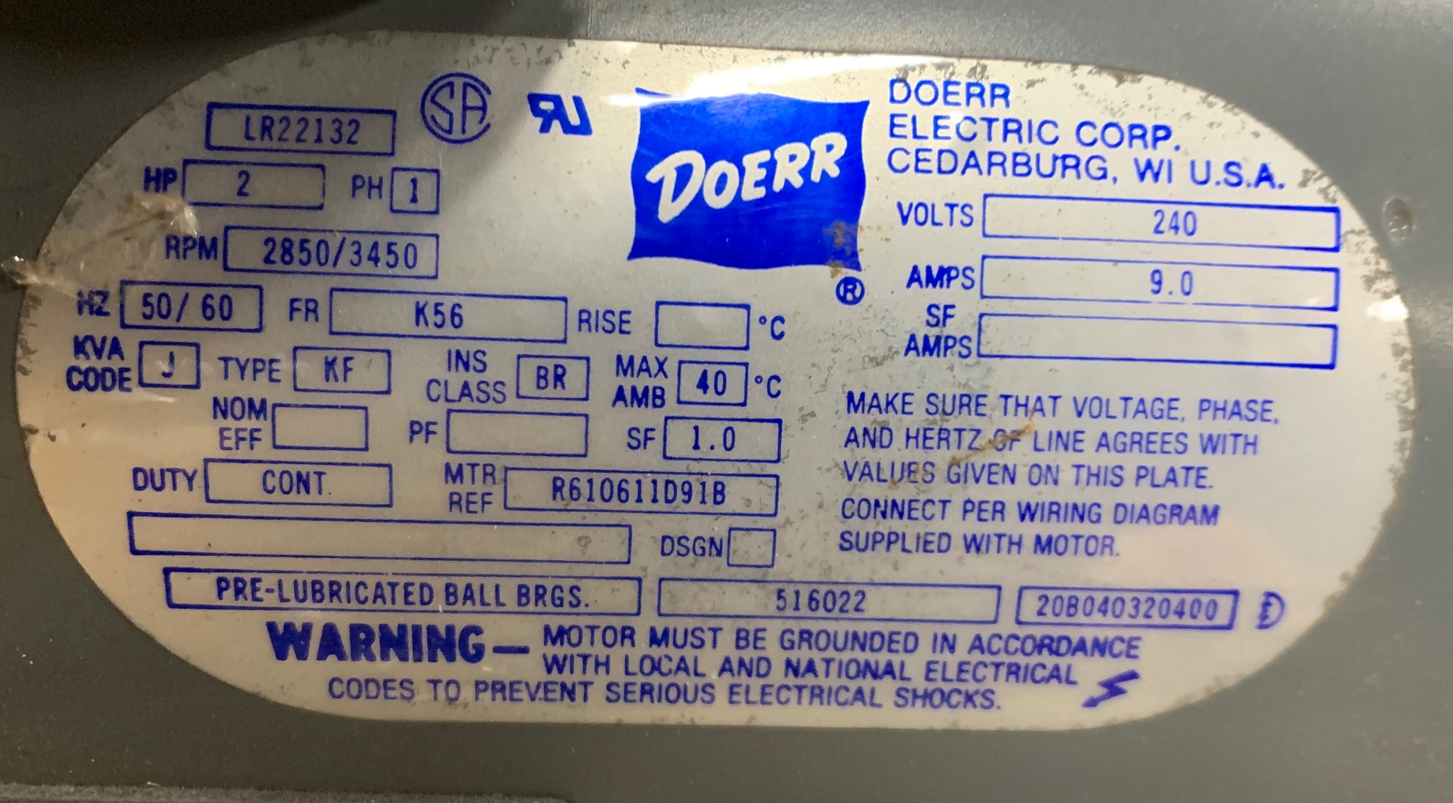

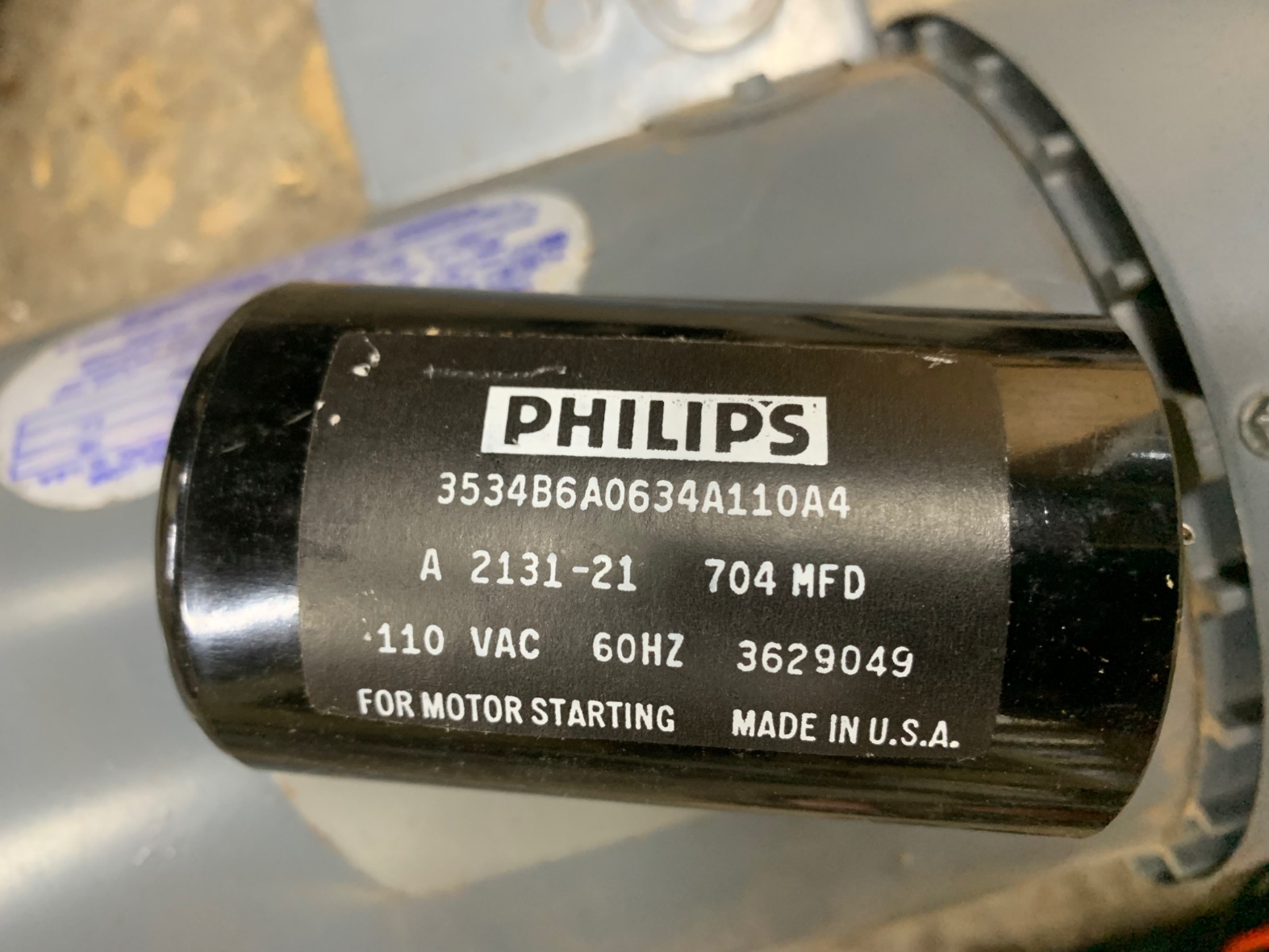

Can anybody check their start capacitor or calculate what I need? It has a 110V 704mf start capacitor which seems odd on a 240V motor. Maybe it just needs longer between duty cycles… I’m at a loss. Attached motor plate and capacitor pics if that helps.

Internally the motor has two run windings. They are connected in parallel for 115v use. For 230v use they are connected in series. The start circuitry is connected across one of the run windings termination. This creates a 115v scenario for the start circuit. It appears yours is not reconfigurable for the lower voltage, but all above still applies(the run windings are connected in series...).

Thanks, I will have to digest and do some reading since the last electrical engineering course I took was about 20 years ago. Memory and terminology on the theory and application of electric motors has probably degraded quite alot since then. What I mean by "locked rotor resting state" is the tendency for a rotor to resist spinning up when first switched on. Probably not the right term so please correct as necessary.
From memory a single phase induction motor uses the reversal of the current direction in a single A/C stator winding to flip the field poles and pull the rotor through 180* before flipping again to keep it chasing the field. If there are two windings in parallel at 115V then the start capacitor being a 110V in a 240V motor may not be the problem. Just struck me as very odd that the capacitor wouldn't match to kick the motor to life. Will have to check on a capacitor test procedure using a multimeter to find out if its good or not. Also if anybody does have the specs on a 240V Euro motor I'd appreciate knowing that the one fitted is correct.
