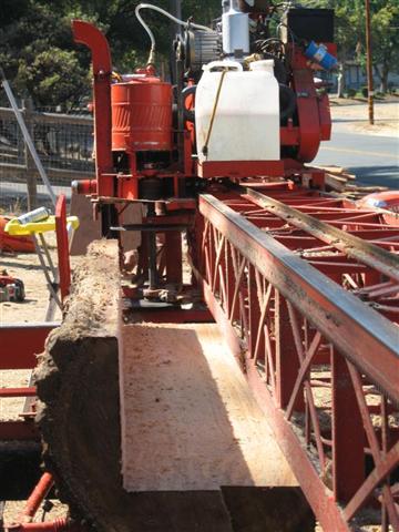

In September, I had a portable miller at my home to mill two Cedar trees that died, plus a Ponderosa that the power copy removed. In the middle of this, a large Cottonwood fell at a friends house, destroyed a toy trailer and hit her horse barn. We went over to clean up the mess and since the mill was already set up, the miller gave me a good price to mill the Cottonwood.

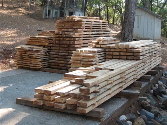

(In the photo, the Cedar is on the left, Cottonwood in the middle and Ponderosa (will be a storage shed) on the right.)

- Milled Wood (Small).jpg (72.34 KiB) Viewed 6047 times
- Millng the Ponderosa (Small).jpg (47 KiB) Viewed 6044 times
