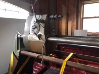

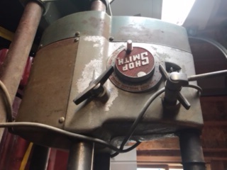

Right now the motor just hums and nothing turns, the speed control handle plate is unattached and there’s a ton of rust, but I got it with a (also rusty) jointer for $100.

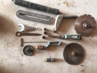

I took some pictures because I’m not sure what some of the parts are.

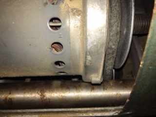

Opened her up and looks like someone’s been in here before, as it has a V belt instead of the older version.
Still just hums, shaft spins freely.

Welcome to the forum! A traditional V-belt is normal between the motor and Idle sheaves/pulleys. It is the upper belt that is typically different between 'old' and 'newer' machines.
There are a lot of things that can cause the machine to hum and not spin. First things first, don't leave power on it without it turning. Typically the motor is still good and we want to keep it that way! One of the most common causes of this problem is sawdust inside the motor, and particularly in the centrifugal start switch inside the motor. The problem can also occur if it was shut off at too high a speed, but from the belt position in the sheaves in your last picture I don't think that is the case here. Also if power is low due to anything, most often an extension cord that is too long, too thin, or both. Another common problem is getting the V-belt pinched between the sheaves so that nothing will rotate, this can occur when someone adjusts the speed control with the machine not spinning.

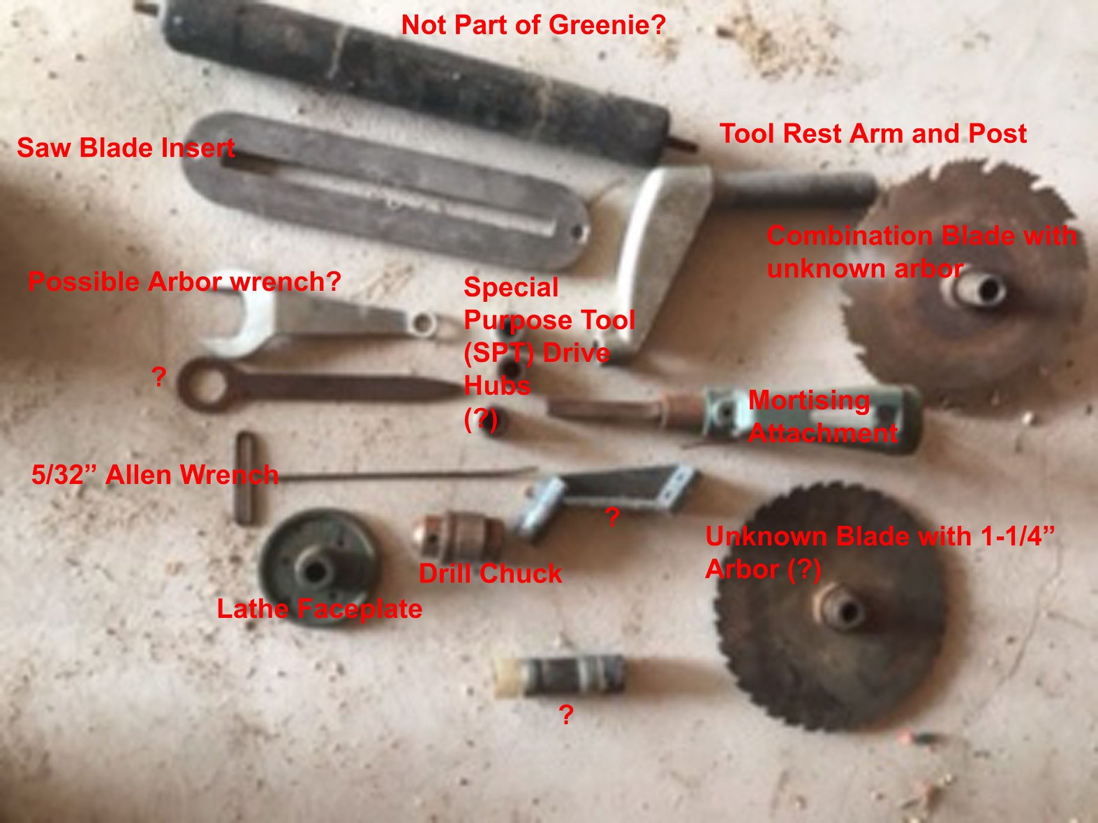

In case the picture you included of the various parts was for help in identifying, here's my guess on some of them. My machine is 1980's vintage, and some parts still looked the same then.
Suggestion for future pictures: Keep resolution a little higher. As long as each file is under 3 MB, you shouldn't have any trouble uploading. Higher resolution pictures will help show more detail.
- Parts Labeled.jpg (199.67 KiB) Viewed 1003 times
Re: New owner of a Greenie
That thingie at the top looks like a push mower roller.
That thingie at the bottom is an older power coupler.
That thingie in the middle is a mystery.

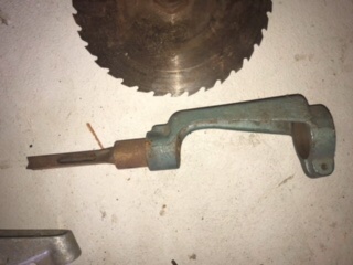

The thingy in the middle turns out to be an old Craftsman table saw blade guard mounting bracket (googled the part number).
