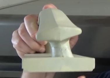

SS Push Blocks
Post by db5 »
Why are they canted?
Posts: 6585
Re: SS Push Blocks
To give your hand more room when running next to the fence or the saw guard???
Re: SS Push Blocks
And to cause downward pressure to exert a side force towards the fence.(as well as to create comfort when standing aside from the travel path).
