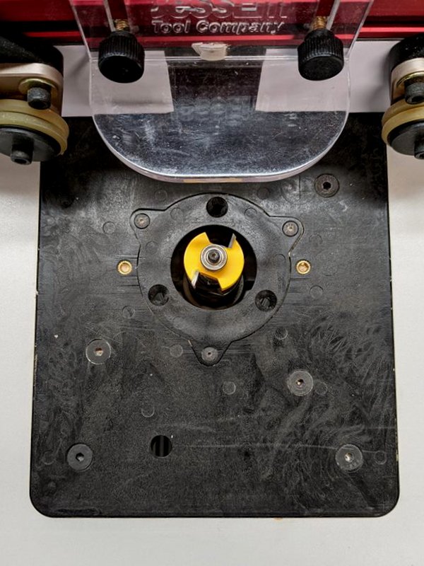

Ed, the 515498 Universal Router Table Plate Insert isn't the plate itself that the router mounts to. Rather, it's the circular insert with triangular mounting ears shown in the photo below, on my OPR table. The "Universal" insert has a clearance hole that's big enough for most router bits. The alternative part is the 515497 "pin insert". That one has a threaded insert in the center, rather than a clearance hole, for mounting the pins used for the overarm pin router function.
SS router plates.JPG (99.4 KiB) Viewed 2289 times
The typical router mounting plate is PN 515496 "Table Plate", which is pre-drilled, with many holes, for the common routers of the day. The one shown in the pic above is the "blank" table plate, which I drilled and countersunk to fit my undertable Triton router. I don't see either of the table plates listed in the sale flyer.

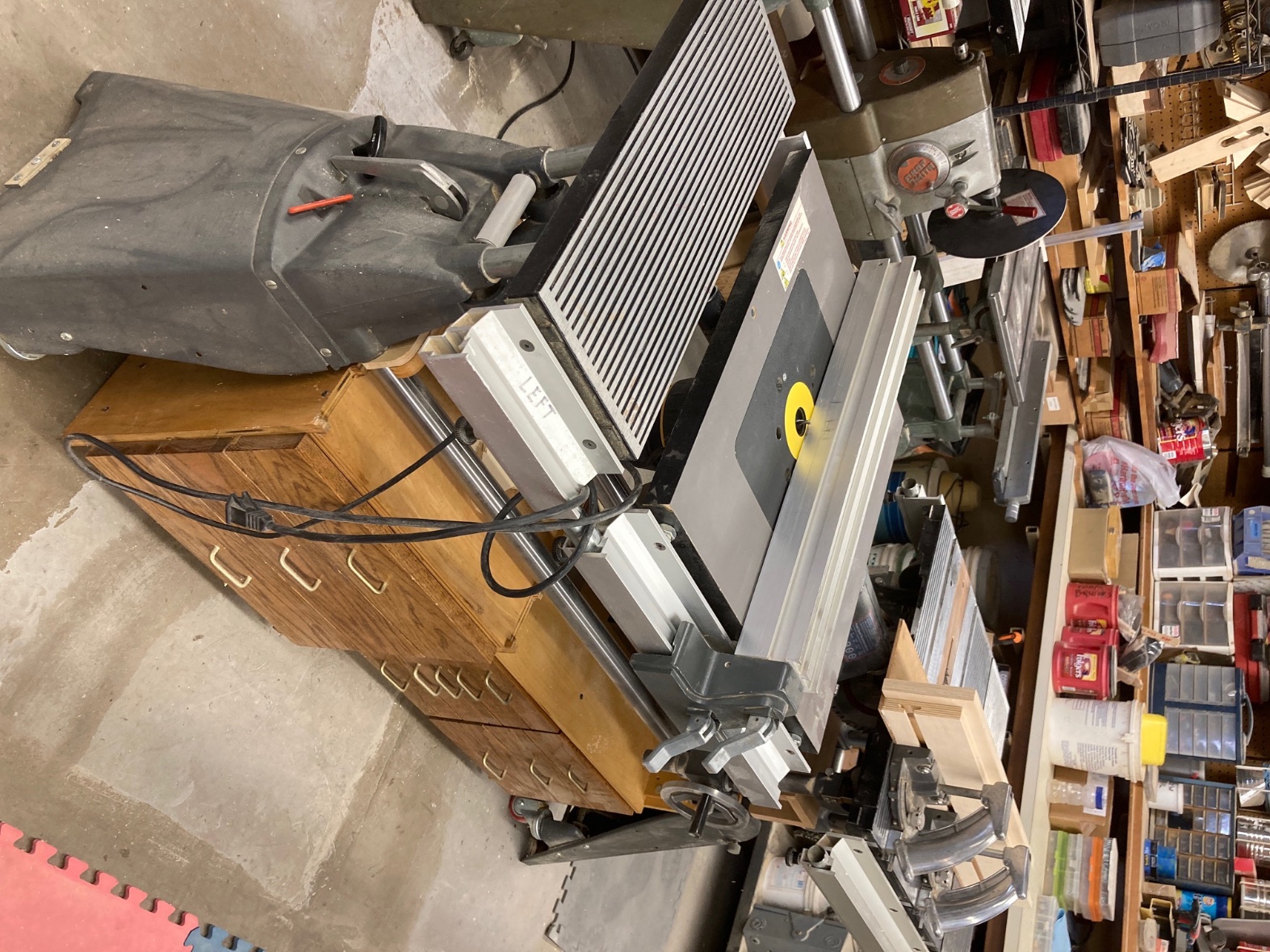

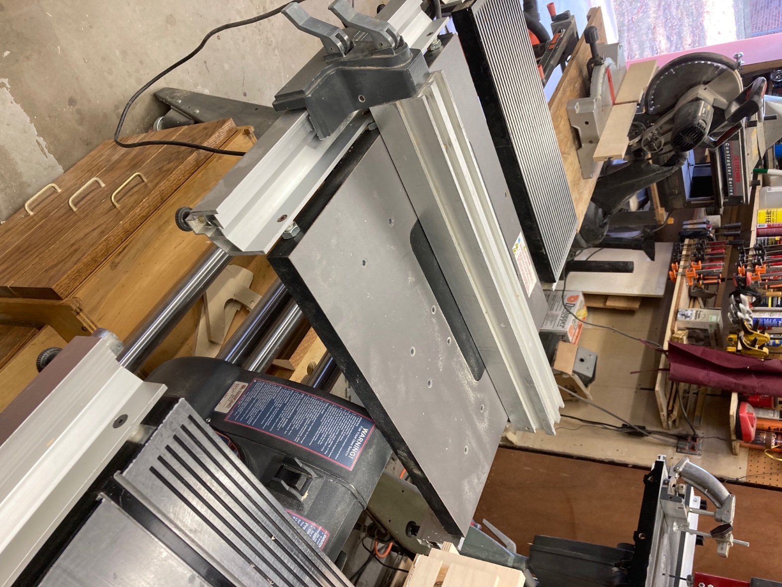

This is the description from the 2005 catalog, page 46. You can’t use the SS fence as far as I can see. I have the Pro router table with the 520 rails and can use my fence but it doesn’t have the miter slot.
I’ve added pics of my pro table. It is mounted so that the unsupported side is resting on the headstock. If you get the 518073 Universal Router Table(Table Only) I believe you would also need 515496 Router Plate and 515498 Universal Router Plate Insert to have a useable table. You would still need to rig a fence and a way to mount to your extension table.
Sorry about the rotation.
