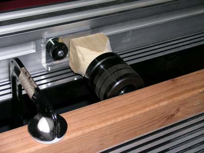

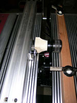

Reading Chapter 2 in PTWFE, where it says to use the quill feed to make fine adjustments to get the desired rip width, reminded me of the previous fence micro-adjuster threads. Many of us already have a microadjustment tool for table height, the adjustable stop collar (part number 555937). So we could just attach it to the back of the fence somehow, and push against a block of wood clamped to the table.
I turned a 1.25-inch diameter tenon on a chunk of poplar, attached the poplar to a T-track light support bracket (part number 521787), and fitted the adjustable stop collar over the tenon. Then the bracket was attached to the T-track on the rear of the 520 fence. I'm sure the engineers on this forum can come up with a much more elegant way to attach the adjustable stop collar to the fence, but this was quick and easy. See the attached pictures.
Sorry if this idea has already been mentioned, I only found one previous thread on the subject and I'm pretty sure there were more than that.
Gary

In today's venacular - That's WAY COOL! Gary. :D Useing what's available!!
Posts: 21481
Cool is, in my humble opinion, a gross understatement. That is absolutely ingenious. I never even thought about using the adjustable stop collar. Good show.:)

That is a wonderful solution!
Tim
These are the sorts of posts I love to see here! It is so nice to see how creative and interesting people can be, thanks ever so much for the post!

greitz wrote: I turned a 1.25-inch diameter tenon on a chunk of poplar, attached the poplar to a T-track light support bracket (part number 521787), and fitted the adjustable stop collar over the tenon. Gary
Wow! Kudos for coming up with another really fine use of the stop collar!
