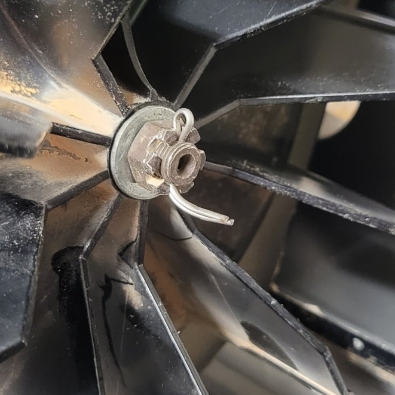

I realized the cotter pin is missing. Bought one and popped it on. Did I install this correctly?

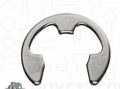

I have the exact same issue with mine. The groove on the motor shaft that the snap ring fits into is worn on mine which allows the snap ring to work it's way out. I ran the motor and used a needle file to clean up the groove and make the edges somewhat square again. I also switched from a snap ring to an e-clip which fit tighter. It worked. However, as mentioned, it's not a great vacuum. I removed it and use a shop vac. If the problem would have persisted my next fix was going to involve drilling a very small hole and adding a roll pin, but the SS vacuum performance simply isn't worth it to me.
As JPG mentioned adding the lock washer will help some, if you fix the snap ring issue. Maybe on yours the cotter pin is all you'll need?

I would be more inclined to install the cotter pin turned 90 deg, so the ends wrap around the nut, rather than sticking out.
