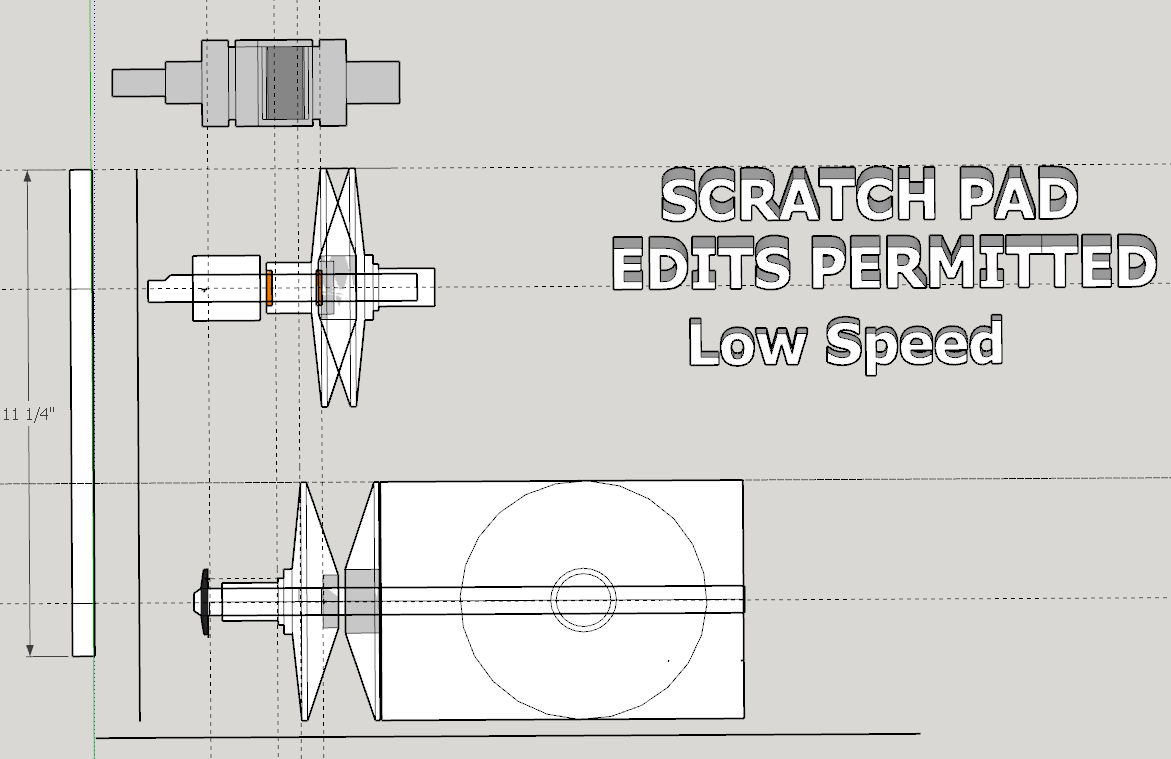

OKAY! I think I got it. The floating sheave and the control sheave move back and forth in lock step on their respective shafts under the control of the motor spring and the porkchop
The speed control (porkchop) pushes the floating sheave closed (against the spring) while the spring attempts to push back. The porkchop (with the mechanical advantage of the gears) controls all movement. If the speed control (porkchop) does not move -- nothing moves. The porkchop"pushes" the control sheave closed while the spring attempts to push the floating sheave closed. The belt is just along for the ride. It takes a position on the sheaves where evr the sheaves may push it.
The fan sheave and idler sheave do not change location with respect to one another.
The separation between the" fan sheave and the floating sheave" as well as that between the "idler sheave and the floating sheave" varies from 1/2" fully closed to approximately 1 1/2" fully open. The resulting ratio ultimately determines the speed of the idler chant. The diameters of these two sets of sheaves vary (depending on the speed setting) between 5 1/2" (fully open) and 2 1/2" (fully closed).
No matter what the speed is - the sum of the two diameters will always be 8".
I have been a long time coming to an understanding of how this all works but now, with thanks to all who have contributed to the many related threads, I understand.
