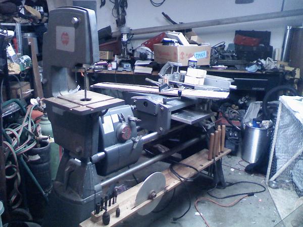

Hi guys I just got a Shopsmith V at an auction and thought I did pretty well. Much to my dismay I got it home plugged it in and turned on the power only to trip my gfi and my circut breaker. Reset the gfi and breaker and tried one more time after turning off freezer and any other extra stuff and got a spark from around the speed changer and from bottom of headstock. I don't know what to do next. Any thaks would be greatly appreciated. Thank you for your help and time. Chris

After disassembling the headstock, you might find an issue inside the switch. These are relatively easy to take apart and clean/inspect. Back cover pops off, inside are two sets of copper plates. You might have a grounding issue between them that is causing the short. Also check for any split wires. The headstock casing itself is not used for grounding (aluminum), so there should be no arcing "to" the speed changer.
Attached is a picture of the switch once it is removed from the headstock.
Recommend you find a copy of the service manuals, a huge help if you need to tear into the headstock and put it back together.
