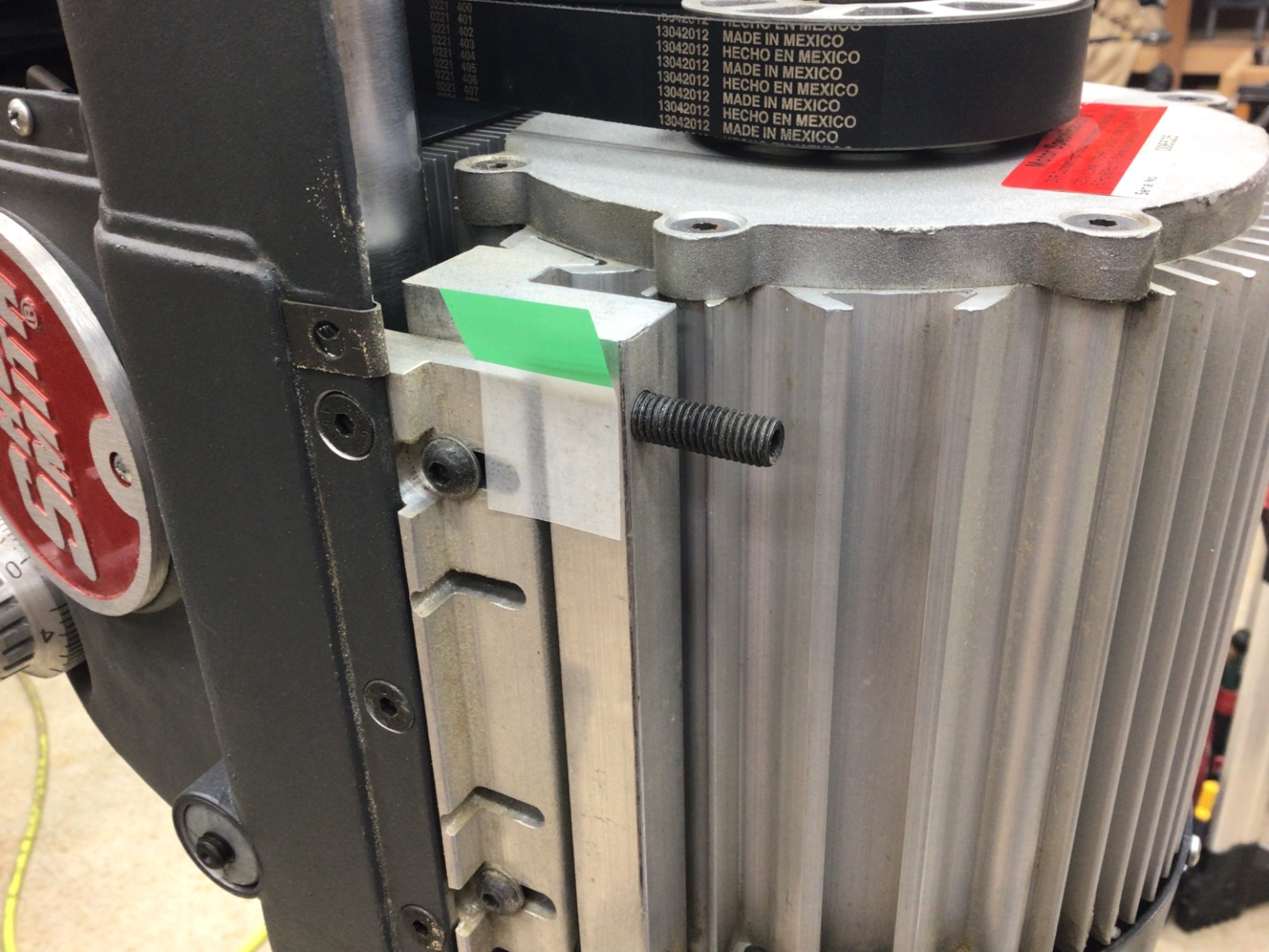

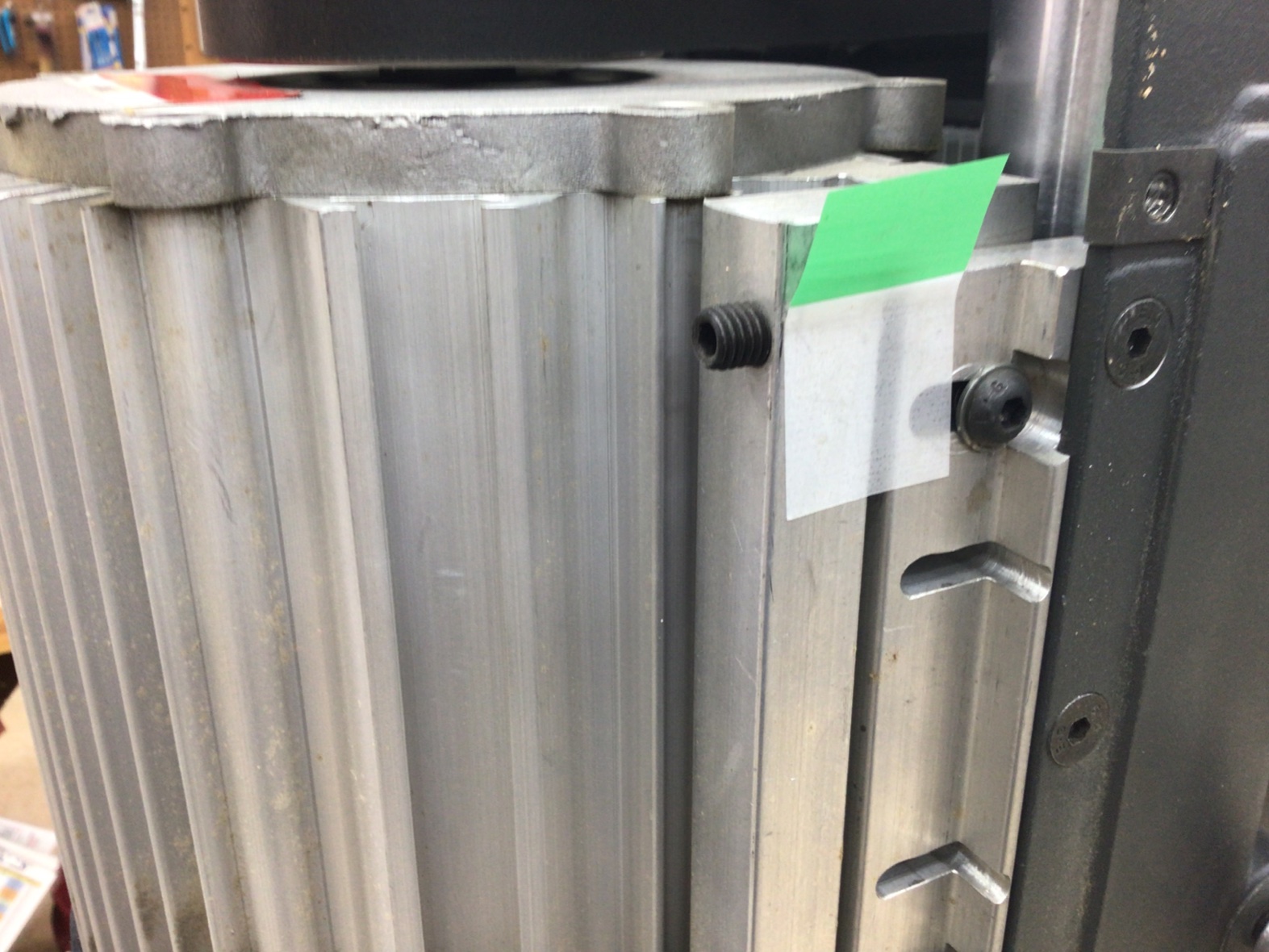

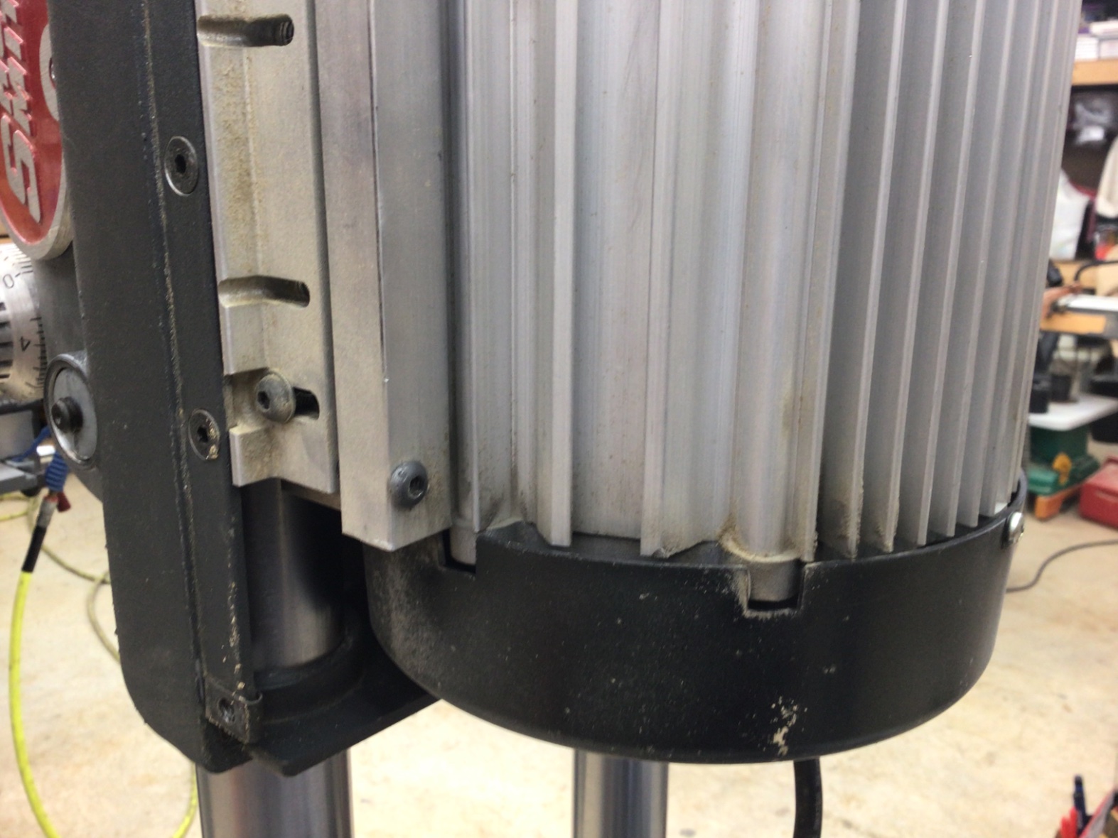

So I received my PowerPro replacement control panel part a couple of days ago (522646) (PowerrPro HMI) and just now starting to try to work through the repair. My PowerPro was bought as a complete headstock in 2012 and this is the first time I have been inside this headstock.
Was totally shocked at what I noticed after removing the motor pan cover. Thought I would share what I just found, totally loose belt tensioning screws (see pics below by green post-it tag) Two of the four screws have vibrated partially out. First I thought the factory used two different types of screws by mistake, but I looked at the parts manual and they list two different screw types,so they are correct. The two long set screws have backed out.

Anybody know how tight these screws are suppose to be?
Is their any tightening differences between the part reference number 102 (522660) SBHC screw or # 103 (522662) flat point set screw?
Wonder why they choose two different types screws?
Any help would be appreciated.

Re: PowerPro - Issue With Control Panel
I do have the PowerPro manual but I guess what puzzles me is why did the screws loosen after being set at factory. BTW I will follow manuals procedures for tensioning and balancing the belts. Just seeking insights on best way to prevent the set screws from backing out in future
