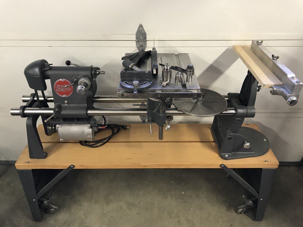

The picture below is a Model 10E I restored that is very similar to what yours would have looked like when new plus on a bench. It does have the later Miter instead of the one it would have come with originally. Your has the original Miter for this era of Model 10E's.
