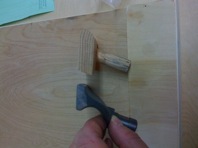

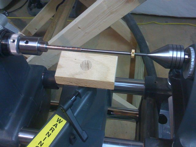

I recently purchased the Penn State live center and Shopsmith mandrel to turn pens. I to did notice that the standard Shopsmith tool rest is to long to get between the mandrel and live center (regardless of quill extension).
I also searched the forum here to see what the fix was and read the posts about extending the Morse Taper.
Here's an alternate approach - total Shopsmith time 35 min. A 3/4" dowel and a 4" piece of wood and bingo! Drilled hole in block at 17 degrees. Add gorilla glue and sand.
First pens have arrived successfully.

There you go shopsmith ingenuity. Nice job. By the way I use the 4in shopsmith tool rest its in the bowl turning sections.

Hey there Hud! You get a big ATTA BOY!!!
for that mini tool rest! As you have read, some have gone to great consternation and "almost great" expense to adapt the Mark V to pen turning. Looks like you did it in 35 minutes!
