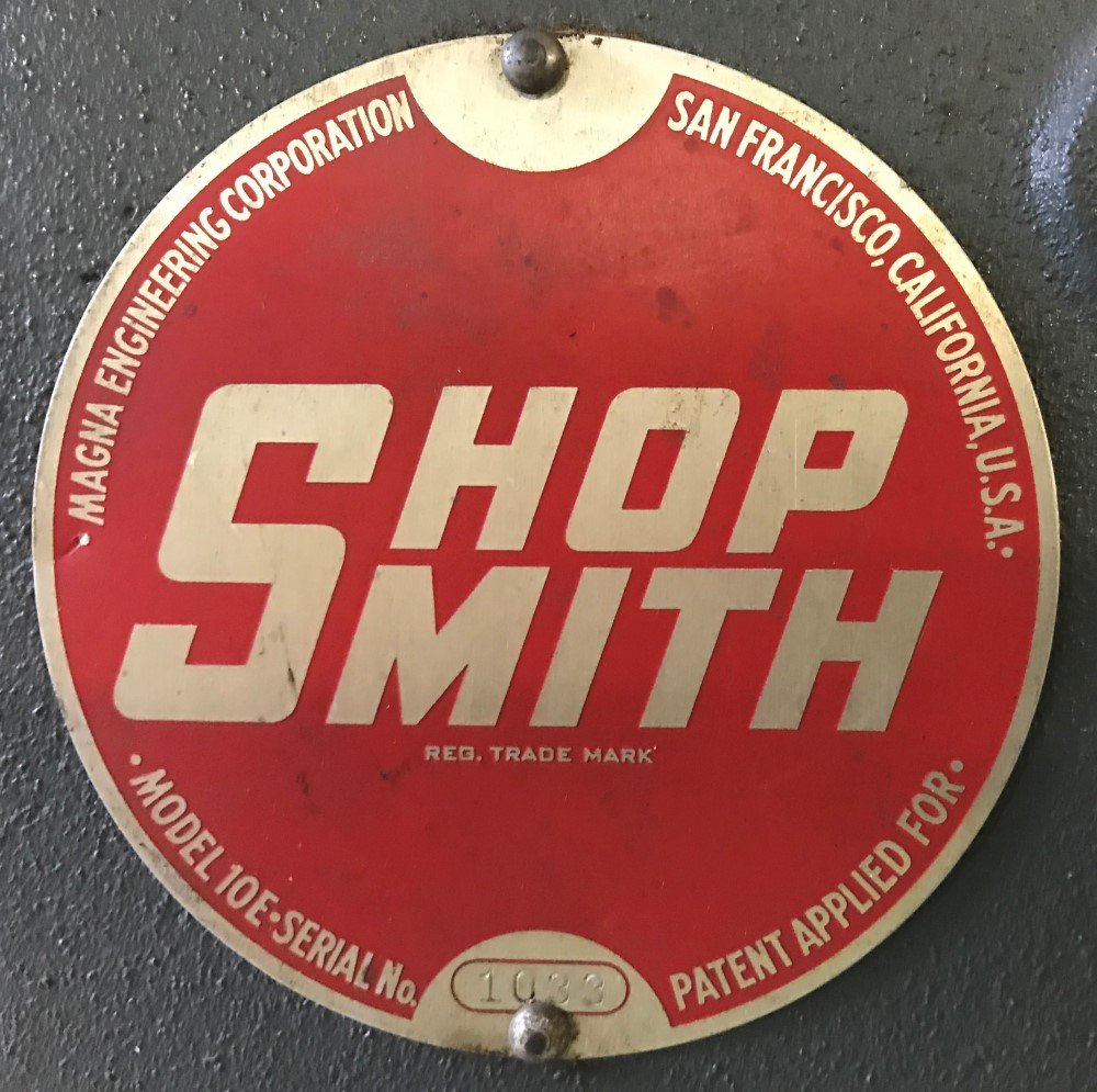

Although I do know a lot about the Shopsmith Model 10E and 10ER I cannot answer your question without a serial number. If 131-2 is what you are asking about, that is not a serial number I recognize. As an example, the Logo/Serial Number Plate shown below is from a US made Model 10E and shows serial number 1033 at the bottom. It is one of those first 250 tools sold.
_
There are serial numbers with an E, ER or R prefix which, for a time, indicates which plant, Eastern or Western, it was made in. I have not seen a serial number like 131-2.

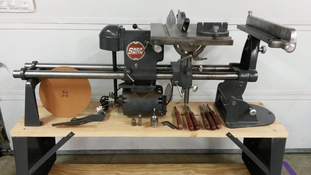

amorris,
Shopsmith Model 10E serial number ER16596 was made in the Eastern Plant. There are no records of when a particular tool was made so best guess estimates are all we can make. In this case it was likely later 1948 or early 1949. The picture below should be very similar to your Dad's Model 10E. It shows everything it would have come with originally plus it is on a bench and has Lathe Chisels in the picture.

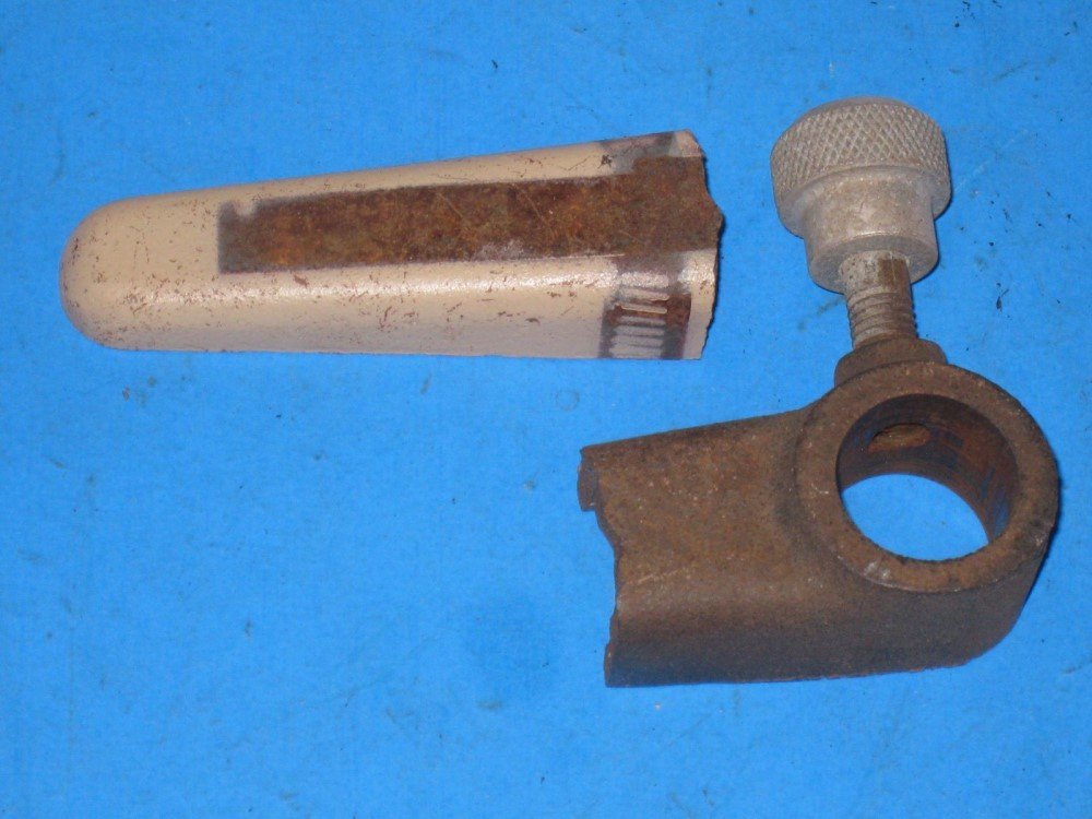

Is it possible to weld possibly with JB weld the table lifting arm?

I am guessing you have one that looks similar to the one below.
_
table raiser arm-broken.jpg (111.46 KiB) Viewed 1448 times
I have seen one brazed back together, but I don't know if JB Weld is strong enough to hold it together during use.

They do show up on eBay fairly often so just buying another one should not be a problem.

Russ, looks just like that even broken in the same spot. I did check ebay and will most likely order from there.
Thanks for the info.

If that's a weakness in them I wonder if there would be any value in placing a piece of steel rod in the well on the back of the new one and pouring it full of JB to reinforce it?
