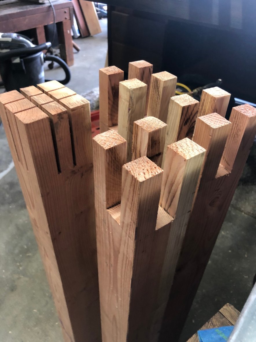

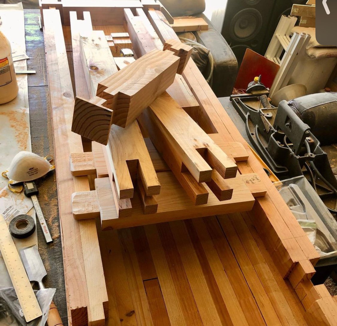

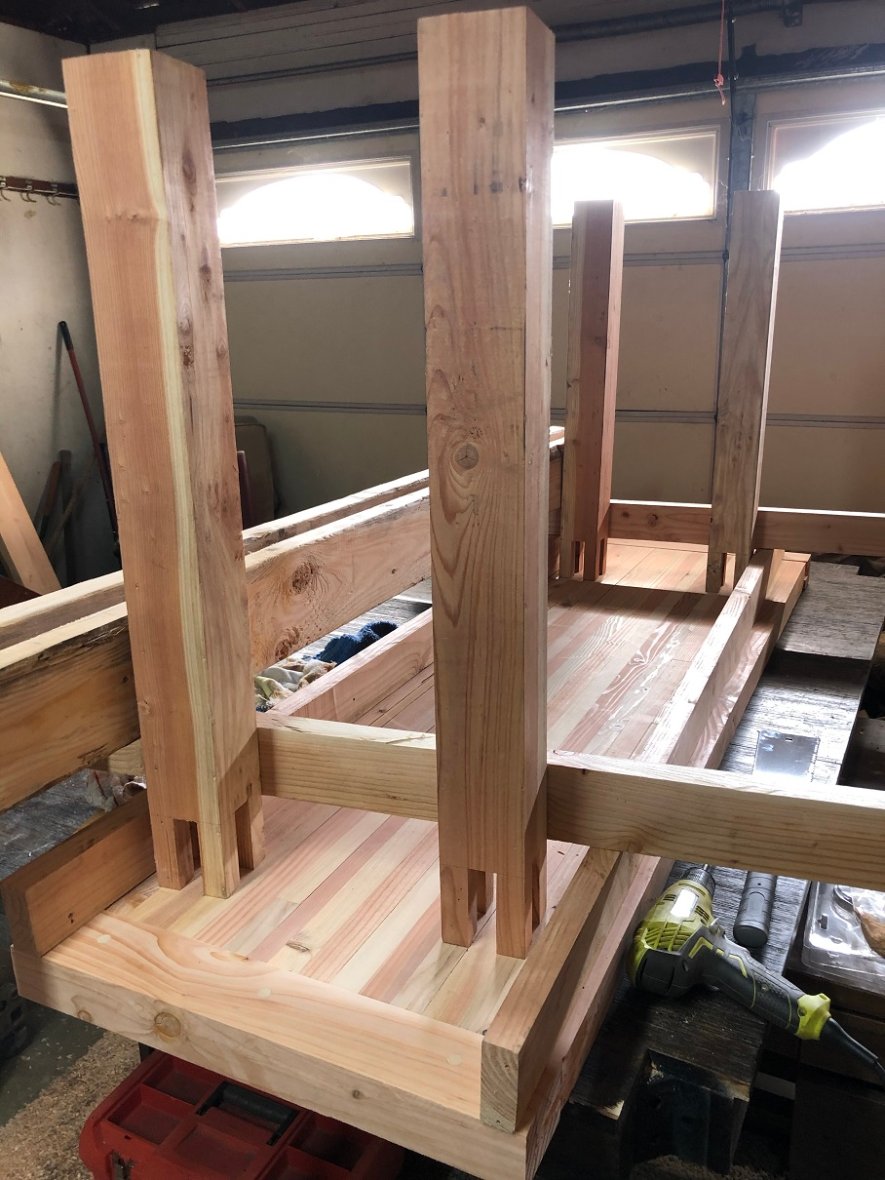

Hey everyone, I thought I would post my first Shopsmith 10er 'furniture': A workbench! The wood was free and I learned quite a lot between this forum, YouTube, and the manuals as input. One thing I wanted to do was make it without any nails or screws: It's all rabbets, mortise and tenons, glue-ups and dowels -- I even snuck in some castle joints. It was finished with a lot of sanding and two coats of boiled linseed oil (with a crossbreeze, natch).

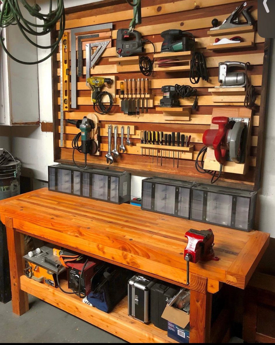

Next was a french cleat wall to hold all my tools (Which does have screws). I'm pretty happy with it, and look forward to now creating an imbalance by getting more tools.

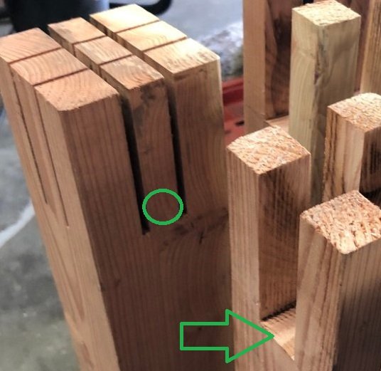

On the castle joints, I see by the toolmarks that a circular saw was used. Also some burning which indicates the blade labored making such deep cuts. Kickback hazard. Bandsaw would be preferred.
You got the bottoms very clean and square, what tool/technique did you use to cutout the waste? Coping saw? I have tried doing that with repeated sawcuts but that still leaves a ragged surface.

@SteveMaryland: Good eye on the blade marks - yes, I tried a dado stack but the cuts I needed were too deep, so I made a vertical table saw jig. The crenels were created by drilling a hole at the top nearly the exact width between the merlons, and any small attaching wood was flush-sawn out. (See circle on included image). You can see the vestigial rut indicated at the bottom. I then flattened these new ruts by passing them multiple times over the table saw on the vertical jig.
To flatten the castle joint merlon tops I used the Shopsmith disk sander until they were all equal height. I did this by clamping two together each time.

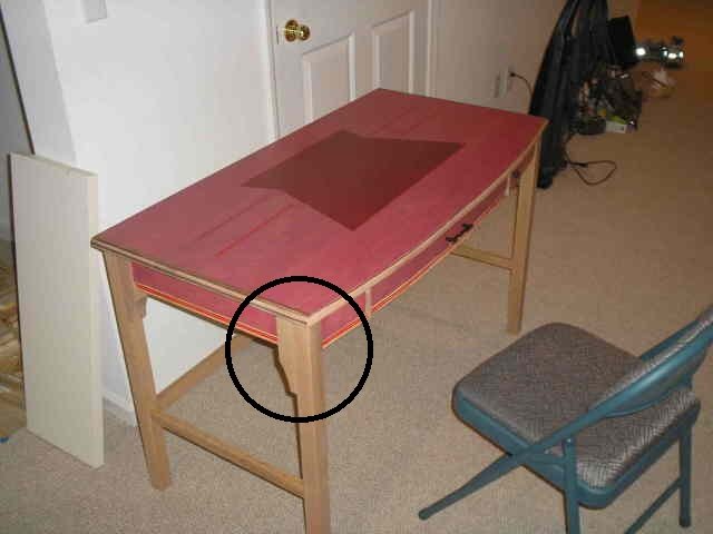

I remember my first Shopsmith project was a desk. I had the Mk 5 but I had no bandsaw. I made some thick "cove" pieces by taking repeated stopped cuts on the tablesaw:
