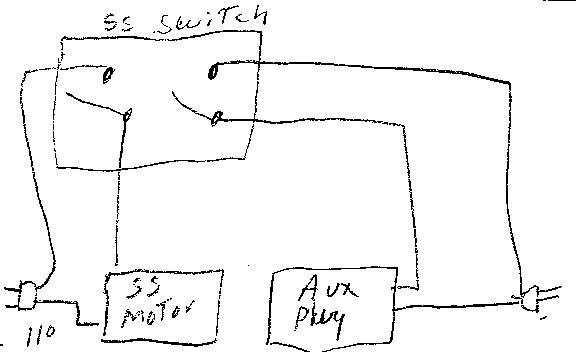

I think what this guy is doing is using one side of the SS switch to control the power to his box. Notice he specifies you must have a SS with a four pole switch.
On most SS that have a 4 pole switch one side of the switch isn't used. So the side not being used can be utilized to switch power to this box. I suspect all that in in this box is line cord coming with one side connected to the aux plug, the other side of the line is then connected to the switch and a return from the switch to the other side of the plug. When you flip the switch to power on the SS you also make the circuit to energize the aux plug.
There is no electronics required or anything magical just a box to hold the plug, a line cord, and 2 short pieces of wire, one to connect line to the SS switch and one to connect the other side of SS switch to the plug.

Dustydusty wrote:I did a double take on the photos shown in the ebay advertisement and it appears to me that the outlet box is connected with a two wire cord (black and white). This means there would be no ground to the accessory that gets power from that outlet unless it is applied within the box and is dependent upon the contact between the box and the Mark V.
I don't know but the ground could be in the line cord that is brought into the box. Ground wouldn't have to go to the switch.
Again don't lose sight of the fact that there is a separate line cord coming into the box that power the aux plug. The only thing this guy is doing is using the unused side of the SS power swithc to control the electricity to the plug.
Here is a real fast and dirty schematic
[ATTACH]3428[/ATTACH]
8Iowa
I think this would work since SS uses one side of the switch and this box uses the other. Neither side would see more amperage than the switch is rated for.
