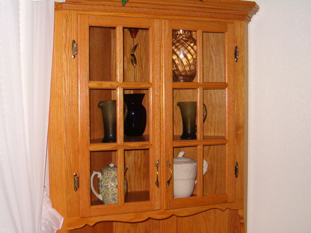

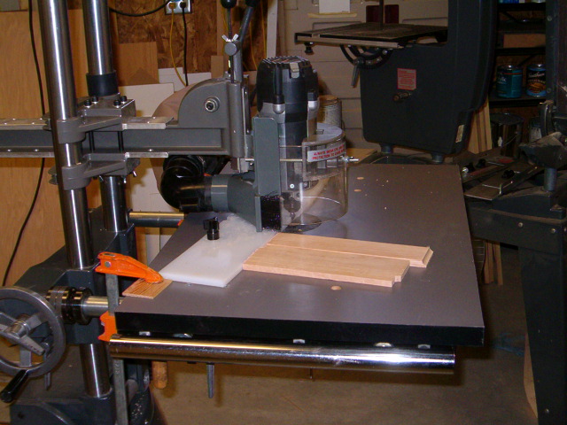

The material responds very well to sawing, and routing. Probably sanding too, but have never had the need to try sanding. This is a photo taken before I built the sliding table and fences for the OPR. I used UHMW to make a fence for routing door frames for a six light cabinet door. It was an excellent fence, very straight and very slick (no wax needed). The second photo shows the use of the work pieces
Note in the 1st Photo - I drilled a hole in the material to hold a screw down (SS factory) fence holder. That's the black thing in the foreground of the UHMW fence. This allowed me to pivot the fence to get the desired depth of cut. Then I clamped down the other side. Can't see that clamp in this photo. Also note the routed recess in the plastic to fit the bit. This small slot allows NO tipping of the work piece into the bit, as might happen in a "normal" router fence having a wider mouth. Also note the chewed up back side of the fence. These marks were from other routing operations.
