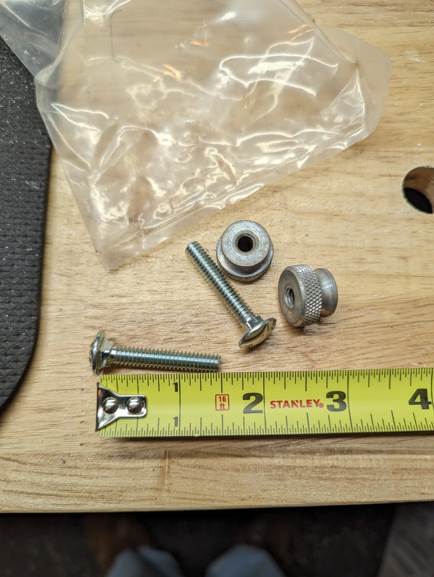

In assembling/sorting/aligning my new-to-me model 510, I found a small plastic bag with a pair of carriage bolts and knurled nuts that I can't figure out the purpose of. I had thought maybe one of them was the leveling bolt for the front edge of the bandsaw table, but the bolt seems way too long for that. Also, there being a pair of them is kind of confusing. I've included a photo of them and a photo of the box they were in (with the rest of the accessories). If it's at all helpful, this is a Mark V, 510, which came with a 6" belt sander, a jointer, a bandsaw (with all the accessories but without a table), a tenon tool, a mortising tool, and the universal lathe tool rest. Any ideas? Thanks!

My guess would be for the wooden auxiliary fence for the miter gauge......

I am not gonna guess. That is exactly what they are.

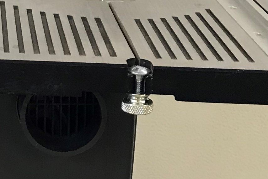

Since I don't have the bandsaw table leveling bolt, is there any reason I couldn't use a carriage bolt, 1/4"x1" with a flat washer and wing nut? I assume that's what the original would have been (but with knurled nut instead of wing nut).

The bandsaw table leveling screw part is a 5/16" - 18 x 1" set screw. You may find that a 1-1/4" set screw also works.

I believe nduanetesh is talking about the bolt at the front of the table that keeps the two halves level at the blade removal slot,edma194 wrote: Fri Dec 02, 2022 12:24 pm The bandsaw table leveling screw part is a 5/16" - 18 x 1" set screw. You may find that a 1-1/4" set screw also works.
Any bolt and nut that fits should work just fine.

nduanetesh,
The 1-1/2" Long Carriage Bolts are for the wooden auxiliary fence for the miter gauge. The Aluminum Bandsaw Table uses the same size Carriage Bolt except only 1" long and the same Knurled Nut as shown below. If you get an Aluminum Table to replace the missing one on your Bandsaw you could use the longer 1-1/2" carriage bolt. It would have about a 1/2" of thread extending below the nut so use caution not to get caught on it.
_ .
Depending how you buy a replacement table it may or may not come with the carriage bolt and knurled nut. If you have the trunnions on your Bandsaw, you can buy the Aluminum Table Upgrade which should have everything you would need or if buying one used check what comes with it.
If it were me, I would keep the 1-1/2"long carriage bolts as is and buy a 1" long carriage bolt for the Bandsaw Table if needed. You never know when having a wooden auxiliary fence on the miter gauge may come in handy and they are easy to make.

Russ and JSBurger are correct; I was referring to that carriage bolt that keeps the two halves of the table level to each other, which the manual calls the "table leveling screw". The set screw that acts as the table's 0 degree stop is referred to as the "Table height screw" in the manual. Personally, I would have called that the leveling screw, but [shrug].
