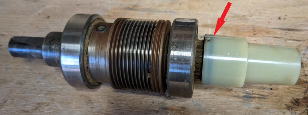

David mentioned most of the Bearings in the Mark V Headstock but don't forget to check if the Drive Sleeve Assembly Bearings need replacing too. The Drive and Ring David mentions is on the end of the Drive Sleeve Assembly and the Splined end of the Quill's Spindle goes into it. The Drive (plastic part) and Ring (inside directly under the arrow) is the parts indicated by the arrow in the picture below. The Splines of the Quill's Spindle should fit snugly into the Drive with no "slop" and the Drive should be tight on the Drive Sleeve Assembly. The Ring is inside the Drive and holds it on the end of the Drive Sleeve Assembly.
