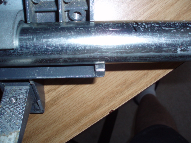

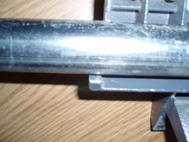

I took a couple pictures to help us talk about this problem. Do these shots reinforce your theory or not.
The part that I believe you have declared to worn do not even contact the rail. What am I missing?
[ATTACH]3580[/ATTACH]
[ATTACH]3581[/ATTACH]
I understand that you have ordered 514254 Fence Base. If you are in a trick, while waiting for this part to arrive, I have one that I am willing to send you. It is the Base only and contains none of the attaching hardware or adjustment knobs. If it would help, let me know by PM where I should send it.

Final Update
Dusty: The wear occurs behind the tube in your top photo.
Anyway I'm all set. Having a replacement on order bolstered my nerve.
I just started removing material from the other side until they matched up.
I tried the same thing on the other end but with little result. Now I'm perfectly square on the "operator" end of the fence. The far end still shows daylight but I can't get a piece of paper in there.
I'm going to cancel my order..... I need that money for drill bits!
