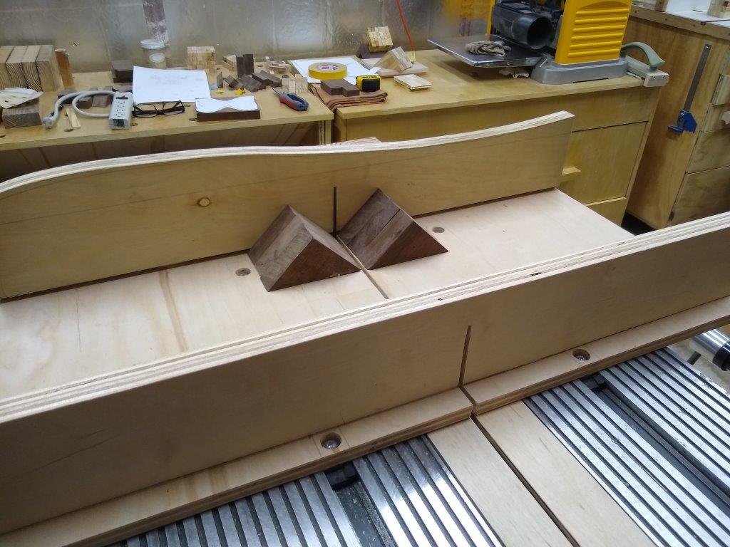

Re: V groove on tablesaw
I would probably try to use a cross cut sled with a couple of 45 degree blocks in it to support the stock.
kinda like this-but the triangle blocks should fully support the stock.
