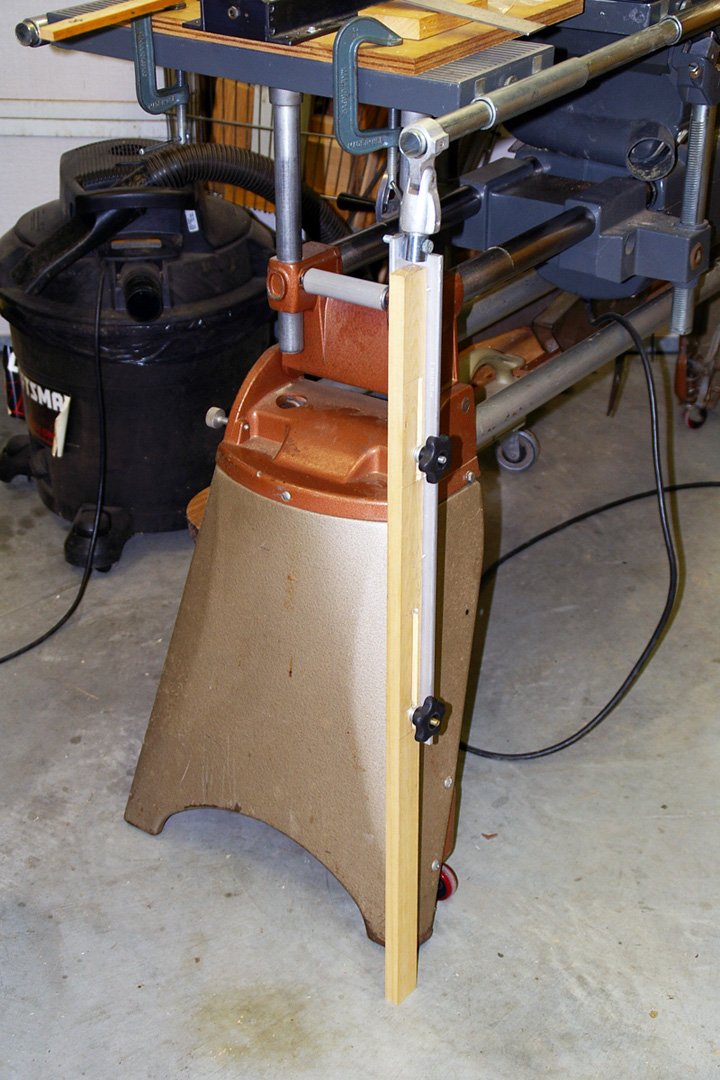

I just found a thread on this topic started by dgreen 810 back in 2015: viewtopic.php?t=15949
It looks simple and sturdy. I think I'll borrow ideas from that one.
- IMGP4076 re_edited-1.jpg (142.4 KiB) Viewed 2718 times
