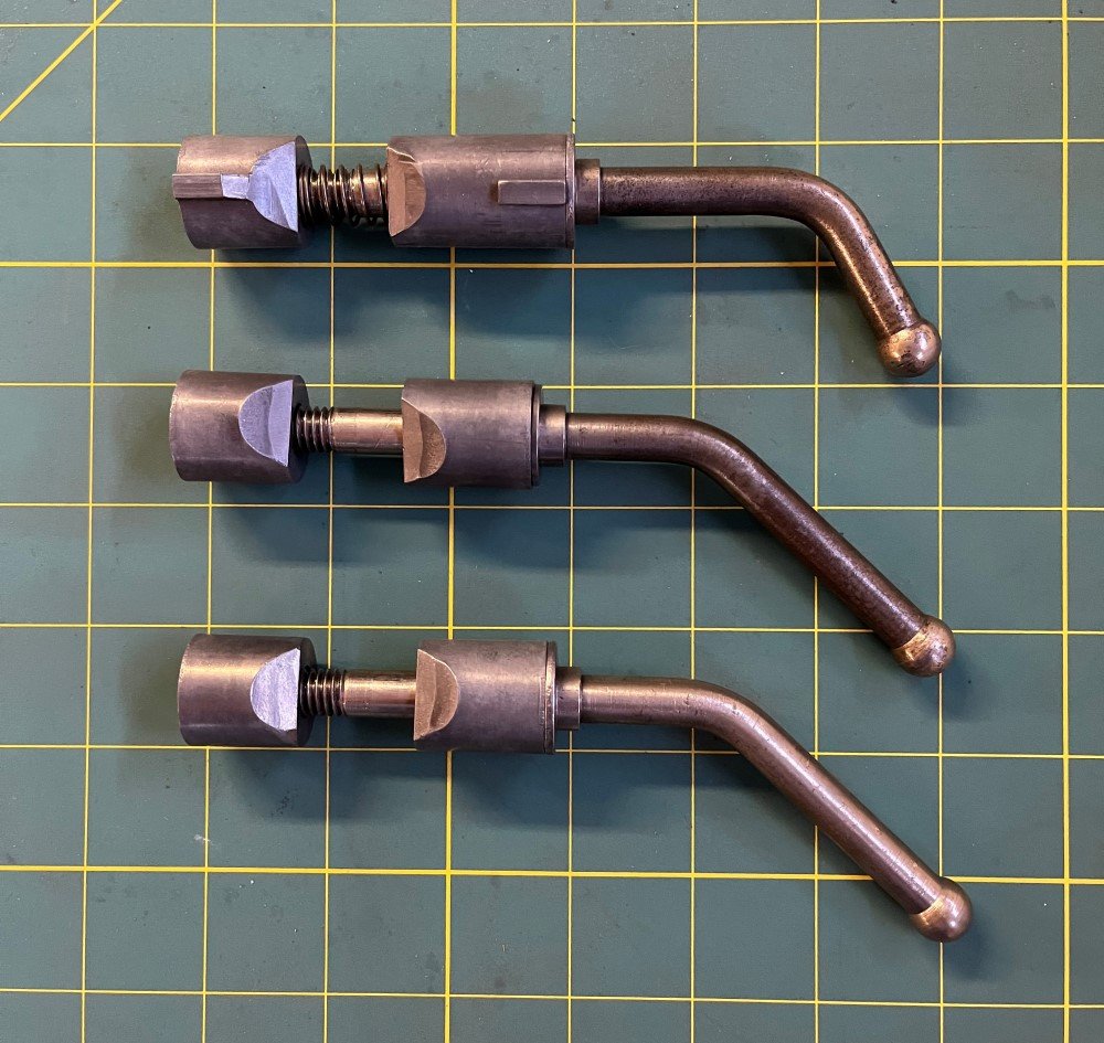

I'm a new user and a retired cabinet maker. I've been in possession of my late father's old Shopsmith Model ER SN R39127 for years and lately used it just as a drill press. I harvested two holly trees last week which somehow has inspired me to try lathe work. My dad's old tool would be ideal for turning. So here's my problem: the main part (headstock?) used to be moveable on the ways, even in the perpendicular position. I set it horizontally today and I now can't move the headstock. I'm only able to inch it along using a pipe clamp and silicon lube but can't push or pull it physically. Any suggestions?

Some history for your Shopsmith Model 10ER Serial Number R39127. It was made in the Western Plant in 1950. Although on the Logo/Serial Number plate it says Model ER it is a 10ER. It is an early 10ER and has double wedge locks. I mention this because if you need parts to complete it you should know there were a number of changes made to the Model 10's during their production from 1947 through 1953 and the wedge locks are one example. The Headstock's Way Tube Lock is one of the possible things causing the Headstock to not move freely on the Way Tubes. Even it the Lock Lever turns freely it is only moving the nut on the threads that goes in the back wedge and may not release the wedge from sticking. The picture below shows the locks that should be used on your Model 10ER. There is a nut in the end of the wedges on the left side of the picture. This nut is NOT a pressed in so it will slide in and out of the wedge. The top is the Quill Lock and for a time it was "keyed" as shown. The other two locks are the Headstock and Carriage Way Tube locks and are the same for each.
