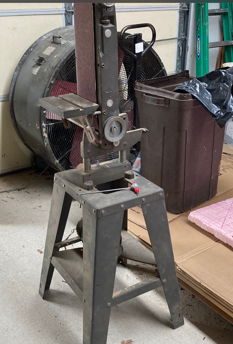

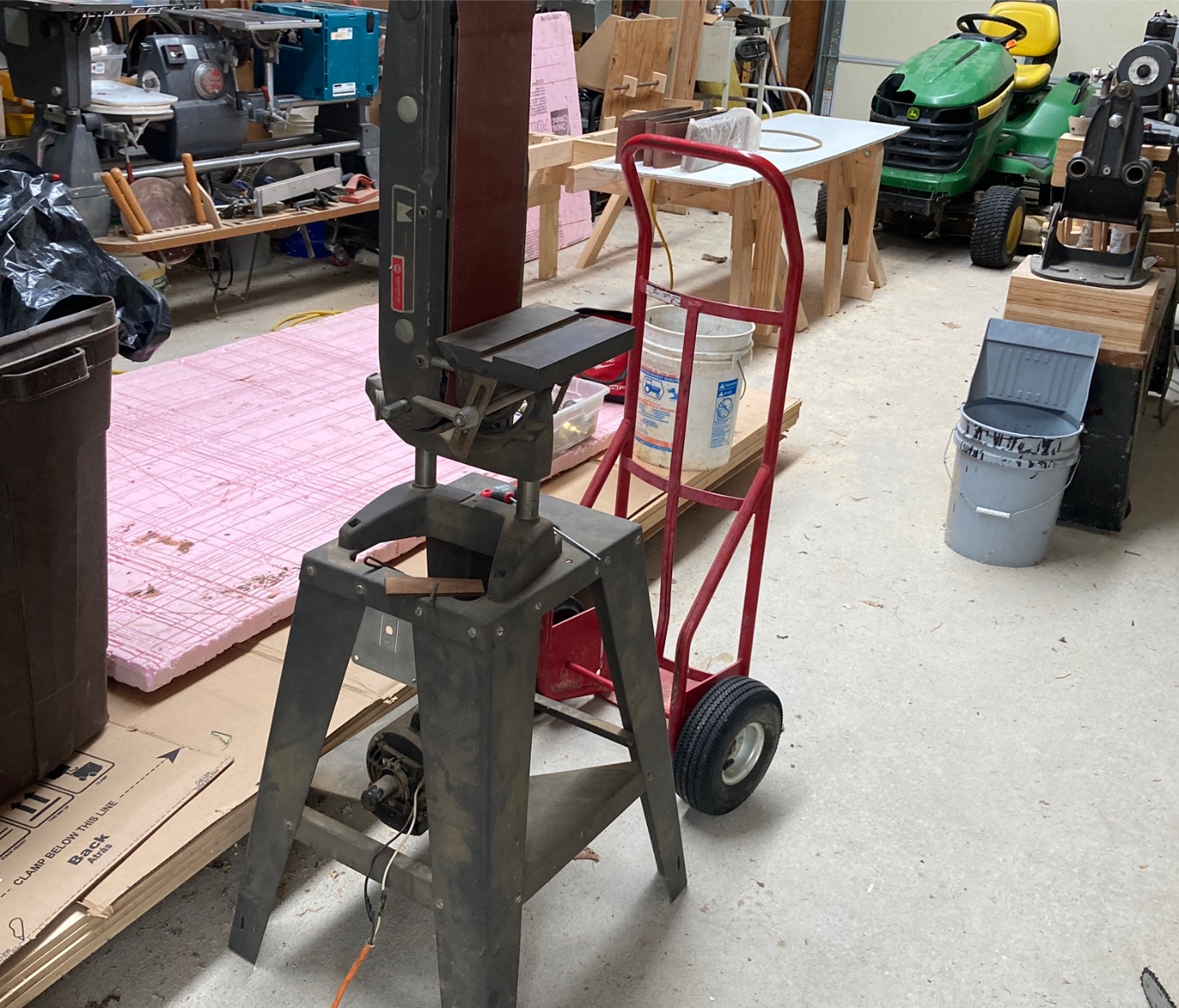

Picked this up on FB Marketplace today for $100. The belt sander Id tag is gone but it has smaller dust collection port so no idea of its age but older. The drive roller doesn’t have a rubber sleeve. Did they make any that did not have rubber sleeves? I need to work on the tensioner and get a 5 or 6” pulley to get the speed slower.

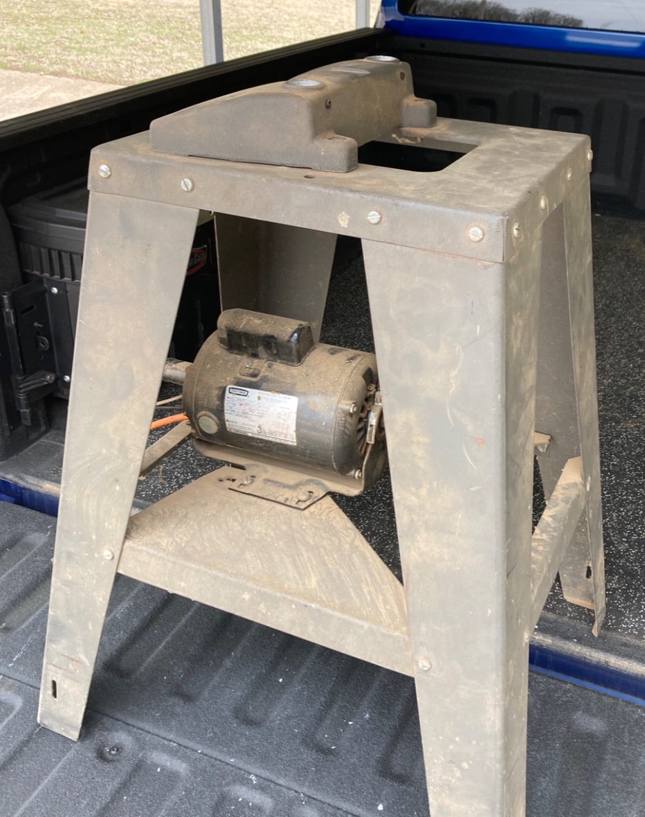

The stand seems to have the identical finish as the SPT base but I can’t find anything like it on the SS website, nothing I find has that type of motor mount. The motor is a 1 hp craftsman 3450 rpm for a table saw. My oldest catalog is 2001 and doesn’t have anything like it. Any ideas who made it?

It doesn't appear to be a SS stand. I have one of the SS stands from the 90's before they were discontinued. First thing I notice is the SS stands didn't have a shelf. The motor was mounted upside down under the top. Second, the legs are not drilled for castors and third the SS stands had a motor switch integrated on one of the legs.
Interesting that the top has the hole in it like the SS stands.

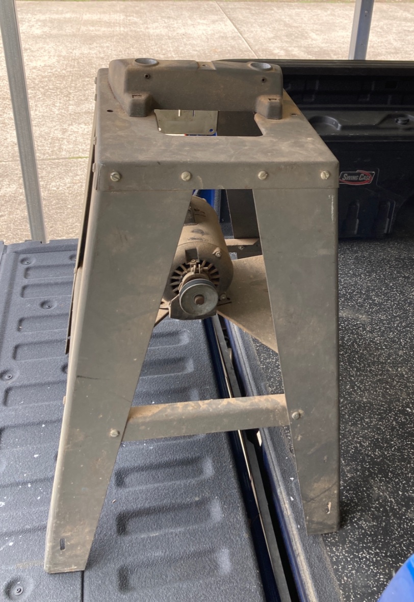

I’m suspecting something Craftsman but haven’t found anything with the wings like those the motor is mounted to. They are separate pieces and seem allow the motor to sag to provide belt tension. The opening in the top is not just a rectangle but has two witdhs, hard to see with the SPT base in the way. Texture and color seem identical to the SPT mount.
I did find the rubber sleeve by itself for the drive roller at the mothership and I found instructions to re-tension the idler drum. I’m hoping the idler has the crown too, will check next time I’m in the shop.

The Belt Sander having the Magna logo still with the Shopsmith Inc. sticker and from Tipp City it is probably one made in the 1970's.
Although I haven't owned one, I have seen that style of stand before so it could be a Shopsmith one missing the power switch box.

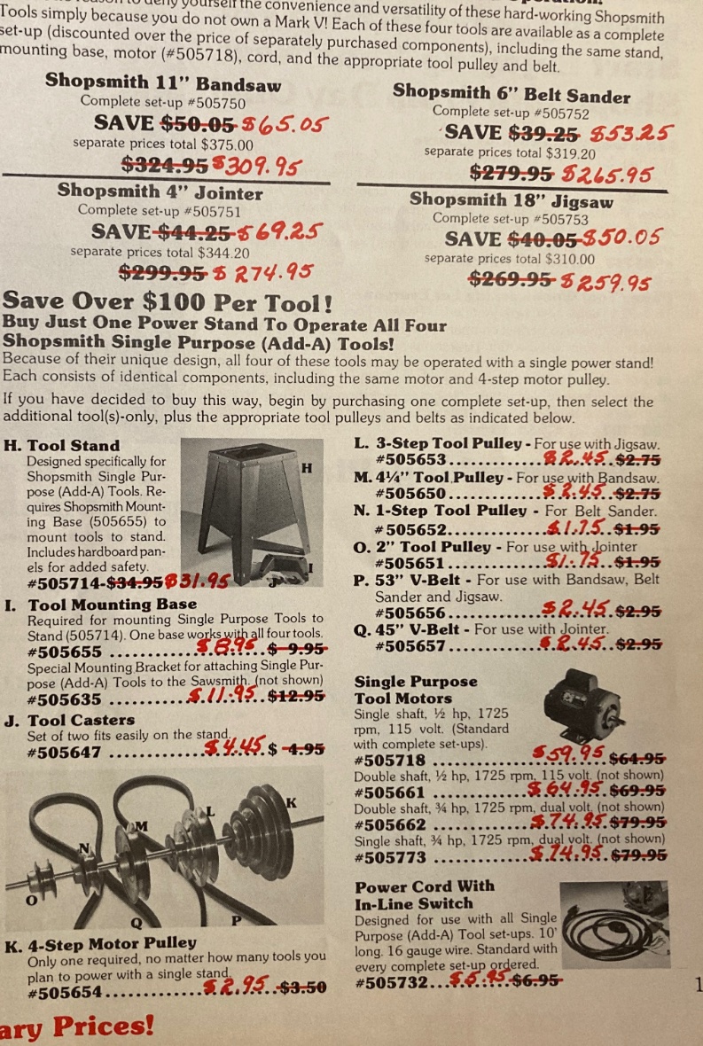

I think I may have found it in some old catalogs.
June 1978 catalog
Spring/Summer 1983 catalog
Apparently changed in the Fall/Winter 1983 catalog
