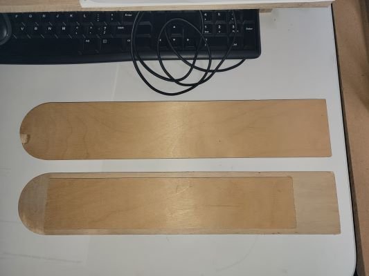

I use 1/2" Baltic Birch Plywood and route the under edges to fit down flush.
Ready to be drilled and slot cut.

Good idea Dusty, I’ll buy a 4 X 8 sheet of Baltic birch tomorrow just for that insert!

You probably will not find 4x8 baltic birch and you might not find it in a box store. I buy from Woodworkers Source and try to keep sizable pieces on hand. I enjoy working with it.

Harsh...you started this thread asking about HDPE versus Masonite. In my experience, HDPE is very expensive so I am surprised by your aversion to Baltic Birch plywood in comparison. IF cost is your primary concern, then by all means go with Masonite/hardboard or whatever you have laying around. Many of us have scrap pieces of Baltic Birch laying around from other projects so it makes sense to use those scraps for things like ZCI's. HDPE would have a much lower coefficient of friction though and would be the ultimate ZCI IMHO.steverboss wrote: Thu Mar 02, 2023 12:30 pmGood idea Dusty, I’ll buy a 4 X 8 sheet of Baltic birch tomorrow just for that insert!dusty wrote: Wed Mar 01, 2023 5:39 pm I use 1/2" Baltic Birch Plywood and route the under edges to fit down flush.

I've used Baltic Birch for ZCI's in the past, back before you had to take a second mortgage to buy a sheet. Fortunately, I still have a decent amount of it on hand, and I've been told (at my local Woodcraft store) that North American mills are currently gearing up to manufacture comparable plywood.
In the meantime, I don't see any reason that MDF wouldn't work just fine. I haven't tried it myself, but I do have a CAD model of a design that uses 1/2" thick material. I've attached a dimensioned drawing for anyone that might want to use it. Most of the dimensions would make more sense as fractional inches, but there's a couple that need to be decimal, and I haven't figured out how to mix those formats in a Fusion 360 drawing.
I've previously used a template and my overarm pin router to make these. But I now have a new CNC router, which should make it a piece of cake to batch these out. Can't wait to try it.
