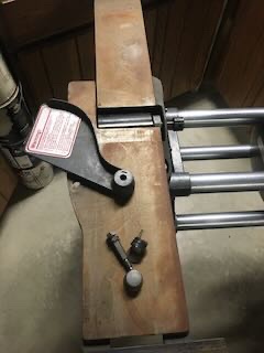

- Jointer IMG_6844.jpeg (21.42 KiB) Viewed 1670 times

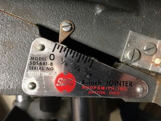

- Guage IMG_6841.jpeg (32.25 KiB) Viewed 1670 times

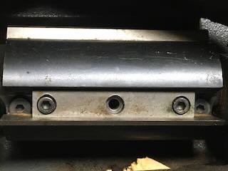

- Cutter Allen Sockets IMG_6837.jpeg (19.53 KiB) Viewed 1670 times

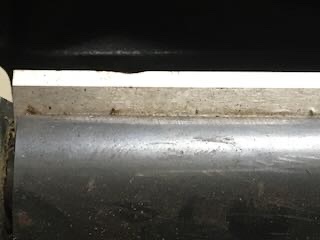

- Blade knick IMG_6835.jpeg (16.57 KiB) Viewed 1670 times

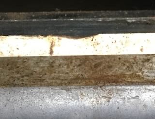

- Blade Knick close IMG_6833.jpeg (25.7 KiB) Viewed 1670 times

Assuming it includes a fence that isn't shown this appears to be a very rebuildable Jointer IMO. I would judge it primarily on whether the tables are flat relative to each other with cut depth set to 0. It is important that the fence is square to both tables. Also check the fence for cracks. You can upgrade to the later cutter head, dust collection, and the featherboard if you want to. To me, the only upgrade that is essential is the dust collection.

Nicked blades is a minimal concern, NEW blades are available from SS. Missing screws are a hardware store item.

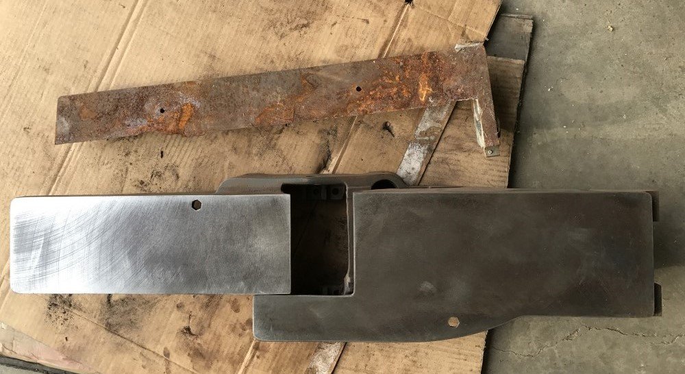

The picture below shows the Jointer Infeed and Outfeed/Base after they had the rust removed. The Fence still has the rust and the tables were in worse condition.

Re: Should I rebuild THIS jointer?
Thanks Russ. Great before-and-after comparison picture.
The only obvious missing part is one of the cutter head wedge screws which should be easy enough to replace. I recall reading that the design of the new cutter head holds the knives a little more securely, but other than that, is there a good reason to upgrade? In other words, if this earlier version cutter head was fitted with sharp knives, will it perform just as well as the newer style?
What was your process for rust removal/restoration of the indeed/outfeed bases? I've used an electrolysis setup for small hand tools, but was going to tackle the jointer with Eastwood Rust Dissolver. Am I on the right track?

The Cutter Head you have already is fine to use. The newer Cutter Head is a little larger in diameter so a bit less of the knives are exposed. The old Cutter Head holds the knives just as securely as the newer one. They both use the same tapered knives and hold them in place with wedges which get tighter on the knives as the screws are tightened.
The knives you already have can likely be resharpened if you choose. A new set of knives are currently 49.99. A bit costly if you replace the knives anytime they get dull or nicked. If you end up using your jointer often you may want to consider getting a sharpening setup. The Shopsmith Planer/Jointer Knife Sharpener with the Conical Sanding Disk work great and all three Jointer Knives can be sharpened at once. I have used mine many times to sharpen both Jointer and Planer Knives and wouldn't want to be without it.
