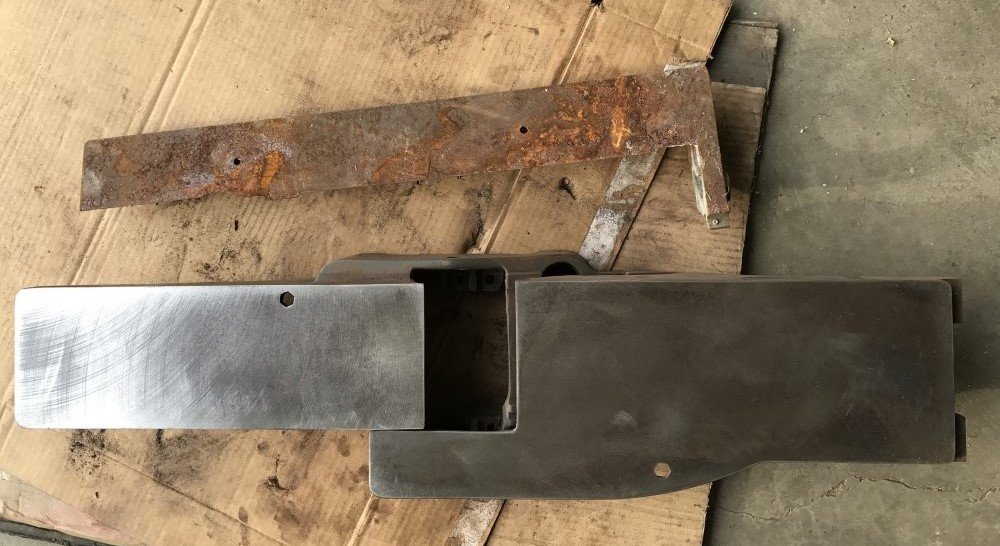

I restored one in a lot worse shape than yours. Good news is any needed parts can be replaced with new OEM parts from Shopsmith. That being said the Cutter Head changed and with that the wedges and screws changed. The older Cutter Head wedges are not interchangeable with the new ones. Changing the Cutter Head would be a major expense if needed. The Knives are the same for both versions of the Cutter Head. Old part can be found from time to time at online auctions.
The picture below shows the Jointer Infeed and Outfeed/Base after they had the rust removed. The Fence still has the rust and the tables were in worse condition.
_
- 11458 Jointer.jpg (130.37 KiB) Viewed 1624 times
It was missing two of the wedges, 1 knife, all of the wedge screws and the leveling screws. With patience I was able to find a used complete Cutter Head.

Thanks Russ. Great before-and-after comparison picture.
The only obvious missing part is one of the cutter head wedge screws which should be easy enough to replace. I recall reading that the design of the new cutter head holds the knives a little more securely, but other than that, is there a good reason to upgrade? In other words, if this earlier version cutter head was fitted with sharp knives, will it perform just as well as the newer style?
What was your process for rust removal/restoration of the indeed/outfeed bases? I've used an electrolysis setup for small hand tools, but was going to tackle the jointer with Eastwood Rust Dissolver. Am I on the right track?

I don't know anything about Eastwood Rust Dissolver so I cannot comment on using it. If it works similar to and is a similar chemical formula to Evaporust then it should work fine.
The Cutter Head you have already is fine to use. The newer Cutter Head is a little larger in diameter so a bit less of the knives are exposed. The old Cutter Head holds the knives just as securely as the newer one. They both use the same tapered knives and hold them in place with wedges which get tighter on the knives as the screws are tightened.
The knives you already have can likely be resharpened if you choose. A new set of knives are currently 49.99. A bit costly if you replace the knives anytime they get dull or nicked. If you end up using your jointer often you may want to consider getting a sharpening setup. The Shopsmith Planer/Jointer Knife Sharpener with the Conical Sanding Disk work great and all three Jointer Knives can be sharpened at once. I have used mine many times to sharpen both Jointer and Planer Knives and wouldn't want to be without it.
