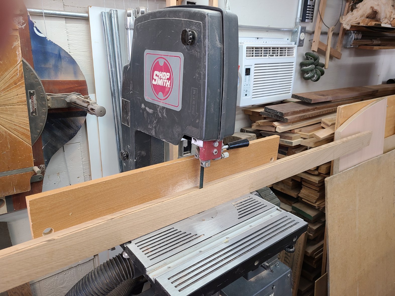

It seems when one honey-do project is completed two more appear in its place.
Cutting veneer for decorative edge.
Glenn

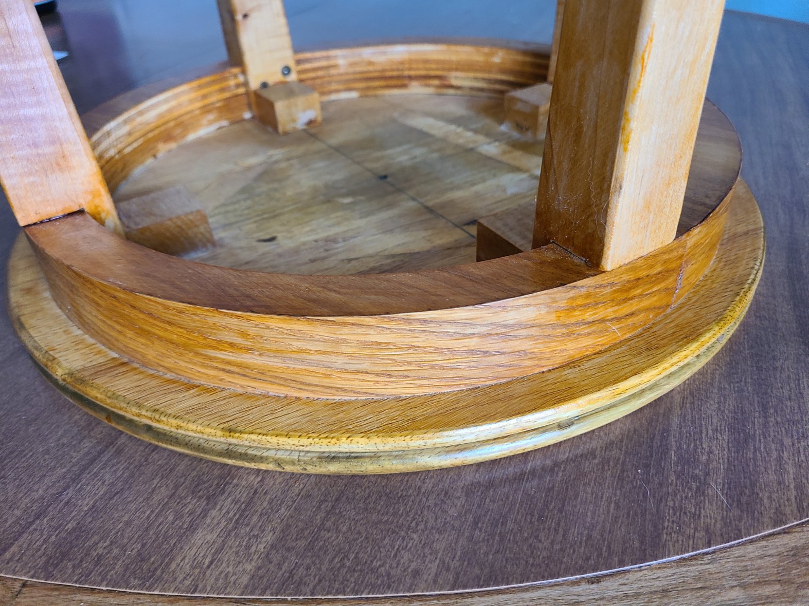

Very nice. How did you construct the skirt?

Matanuska wrote: Mon Apr 10, 2023 8:16 pm Very nice. How did you construct the skirt?
I second that question...and also would be interested in hearing how you built the lip around the top. BTW, great project!

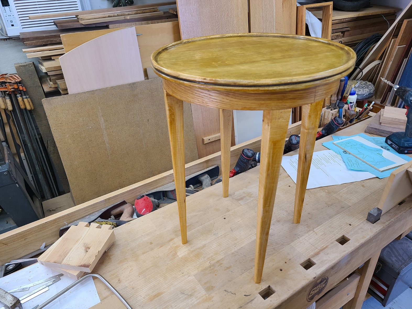

edflorence wrote: Tue Apr 11, 2023 12:42 pm
The skirt was constructed by gluing two 3/4 plywood sheets and using the ss band saw circle jig to cut the skirt base then gluing on a veneer strip.
The top is a solid piece of 4 quarter Butternut that was holowed using a SS over arm router.the outside edge was formed using a SS shaper and the inside of the lip was hand formed using various hand tools rasp, gouge ect. note Butternut is easy to carve/shape by hand.
