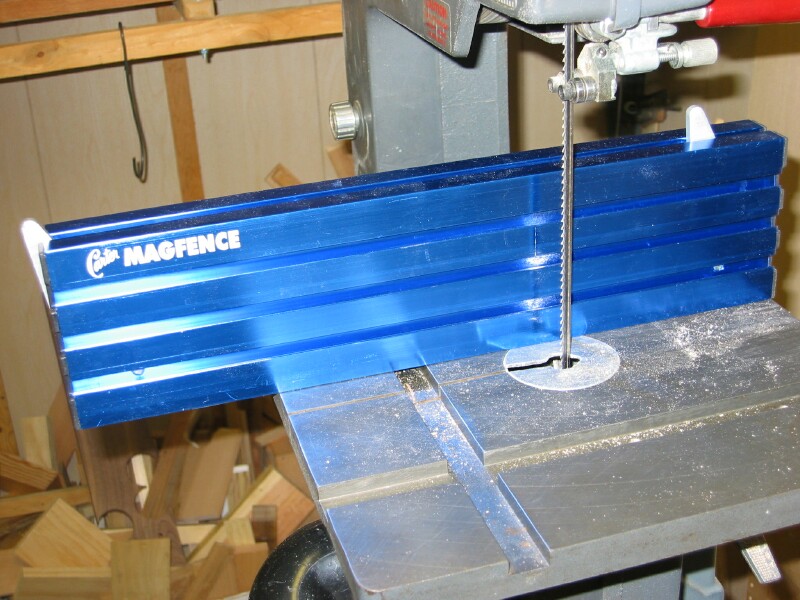

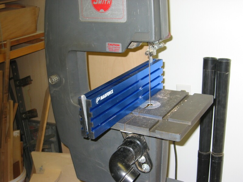

I did get another Carter gadget, called a "Mag Fence". It is a magnetic fence for band saws. If you have the newer aluminum bandsaw table, this won't work for you, because it is held in place by six large rare earth magnets.
I tried it, resawing some pieces of 4/4 cherry. It cut true & clean without any burn marks. I've never resawn cherry, before, without some burn marks.

I see you have performed a dust collection modification on your band saw. How does that work?

I made the mod to my older bandsaw and the one on the 520 came with it alread incorporated. I'd say it collects 70 - 80% of the sawdust vs no system.

I'd guess it collects about 90%, but that may be due to my poor shop vac (about 12 yrs old). I still get stuff, carried around by the blade, dumped on the piece while cutting.
I'm upgrading my dust collection to a medium sized dust collector that will pull about 1250 cfm through four inch duct. It that doesn't help, I might "upgrade" the connection to a 4-inch port.
