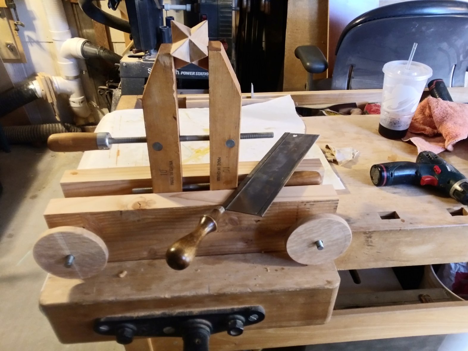

I don't know how to take a picture showing all eight points with the same shot. So the star on the right show the front and top the picture on the left shows the bottom and the back.

Interesting one person saw triangles. One person saw pyramids. I saw a six-sided cube with eight points and twenty-four faces.
I am not showing the jig attempts they were clumsy complicated to make dangerous and didn't work very well. (I like all my fingers just where they are) Day one I used the table saw after several attempts I failed. Next was the band saw another fail. Next was the router and a 45 deg bit but very hard to set up fail number 3. Then while contemplating life in the throne room the solution came to me a clamp a hand saw and about ten minutes. The picture shows the results.
