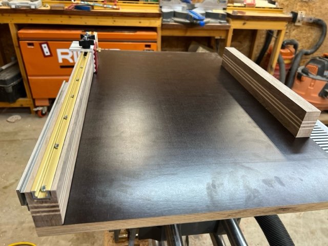

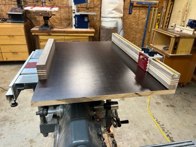

I've been working on it here and there. So far my dimensions are 28" x 18 1/2". I had to make three jigs before starting on this. Two came from Scott on My Growth rings ( the outfeed support and Jack The Stripper) and a ZCI. For that I followed Mike Young's video and made three blanks from a piece of 1/4" poplar. I needed all three jigs to cut 1/8" strips of walnut and maple to get the look I wanted. The other thin strips were wider. I decided that back support was indeed needed. I did not have enough material to run the entire length of the backside, but this will cover out to beyond both sides of the miter bars.
I have most of the pieces made. I need to route out channels for the T Track on the sled, and a 4" wide channel 1/2" deep to lay a piece of MDF. This will allow me to keep a ZC on top because I can replace it as needed.
My plunge router is not well, so I can't use it. My palm router is (I think) not up to the task.
So, unless someone has a better idea, I will use my special 10" blade for cutting phenolic and plastics and make many, many 1/8" passes. I have the adjustable stop collar so I am comfortable with getting a precise depth. But so many cuts can make lots of chances for errors.
Here is a mockup of the parts made so far. I'm liking the look it is taking.

Looking GOOD!

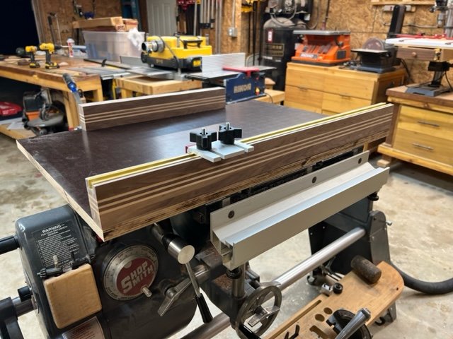

I blew a big chunk of the day due to Dr appt, so I came home early and got a bit more work done on the sled. I made the handles. After this it may be awhile before I make any more progress.
I noticed two issues when drilling. One was that the downward force of the quill shifted the table position. So I tightened that up a bit. Also I noticed the depth stop slipped. I checked to make sure the knurled ends of the washers were correctly installed. They were, but the knurling looks worn. I think I should replace them.
