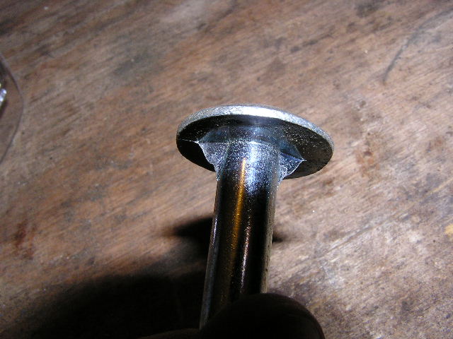

Starting to rebuild an older (82) bandsaw and ran into a problem at the tilting table function. The front bolt that has the handle on it is psinning freely. Checking out the rear bolt, can see that the bolt has a couple of small wings that rest in a notched housing that keeps it from turning. Picture of wings:
[ATTACH]3828[/ATTACH]
The housing on the front bolt is spinning in the hole, so I cannot back the nut out enough to tilt the table. Can't find any set screws in the frame that keep the housing in place.:confused:
Any ideas on how to back the nut and bolt out?

Yep, just got it off with the vice grips and PB Blaster. A little frustrated I didn't think of that earlier!
After I backed the bolt out, cleaned and put it all back together to see if the table would lock down tight. As soon as the nut was tight enough that I needed to use the handle to further tighten it down, the bolt and housing moved again.
Anyone know what holds the housing in place? Is the housing called a "Trunnion?" SS is having a sale on bandsaw parts, this would be a great time to pick these up if I knew what the blazes I was looking at...

SS site was the first place I went for the exploded parts diagram. However, there must have been an update from my 82 version to what they have posted. Looking at my original owner's manual and its diagram, there is no item called "Trunnion Support" and the bolts are different part numbers. Bushings (correct term, not "housings" I was initially using) are the same P/N, so I'm wondering if the Trunnion Support helps lock the bushings in place?

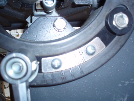

Assuming that the bolt we are discussion is the one associated with the trunnion tilt lock mechanism, I do not have a bolt like the one you pictured.
Mine is a standard hex bolt and I am not certain that I have a "trunnion support". The one bolt (the pivot point) appears to be something else. I can't see very well because it is behind the wheel and can not be removed without pulling the lower wheel.
Incidently, when I tighten down the trunnion tilt lock, there is a point where the bolt turns. It seems to prevent me from tightening the lock too much. I have to look at it better (in the daylight) to say for sure. I may have your problem developing as well.:(

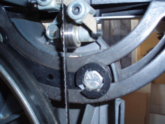

Bandsaw Trunnion Support
Matt,
If misery enjoys company, may I join you, please.
I do have a similar problem developing with one of my bandsaws. The trunnion support is suppose to hold the heads of the two bolts so that they can not turn. The support is some sort of plastic or phenolic. You can see from the photos I have attached what is happening to mine. The bolt head has turned slightly.
[ATTACH]3832[/ATTACH][ATTACH]3833[/ATTACH]
dusty wrote:Matt,
DUSTY: 515013[38] Plastic. Been there done that. I would think it a common problem. Fortunately it is inexpensive. Relatively easy to replace(back bolt can be onerous to get loose). The back nut is a nylock nut and is almost impossible to remove without breaking the other [38]. So, I recommend ordering TWO of them.;)
