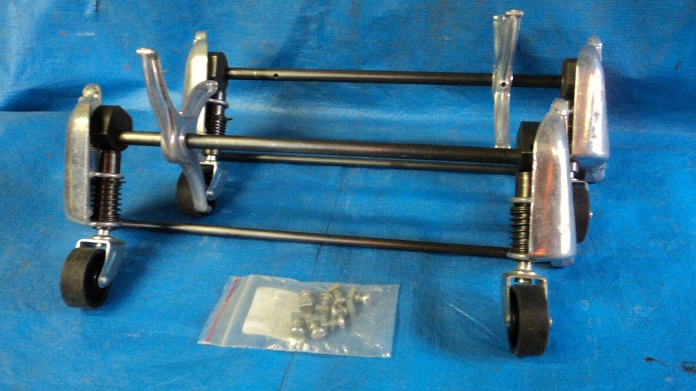

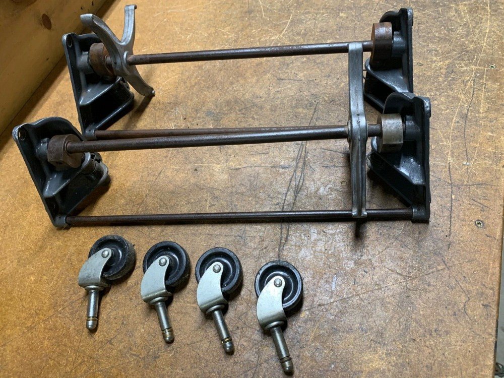

The one problem that I know of is putting the 3" Casters on the older Retractable Caster Assembly. The older set has the foot pedal wheel closer to the Cam and apparently hits the Casters when raising or lowering. I know of one owner that has trimmed the foot pedal wheel to clear the Casters. I have not tried the 3" Castors on an older Retractable Castor Assembly to see how much interference there is.
Below is the early Retractable Caster Assembly.

Below is the later/current Retractable Caster Assembly. note the location difference of the foot pedal.
_
Retractable Casters - Mark V.jpg (116.91 KiB) Viewed 8050 times
