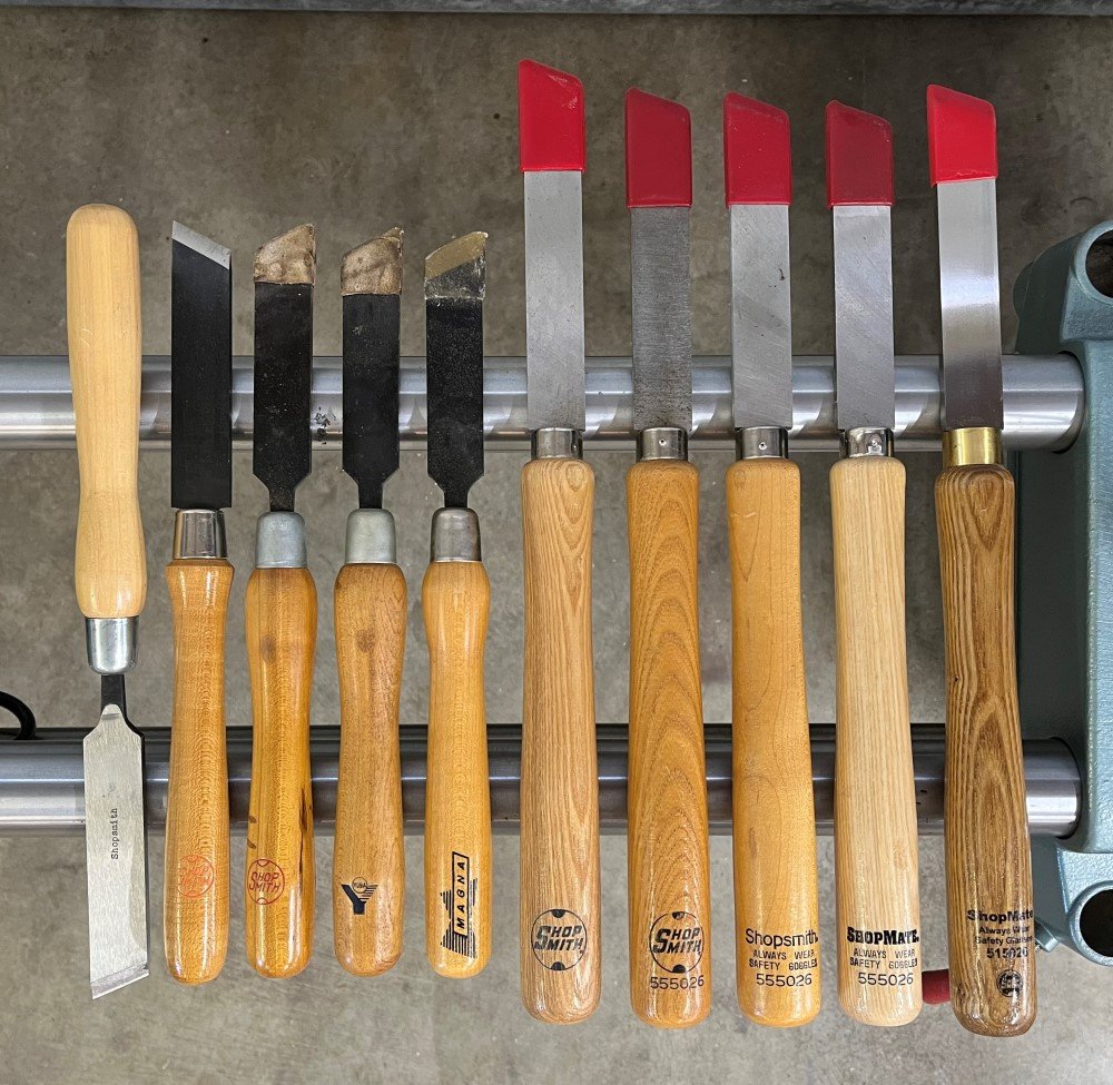

Need some clarification on SS lathe chisels what is the difference between 515027 and 555027? The shape of the 515027 chisel is different that the 555027 chisel. The handles are different types of wood. 515027 is a nicer material wise chisels. The 5151027 wood handle looks like oak with a brass ring clamp and the blades are stamped HSS. The 515 series chisels look and feel like a much better SS 555series chisels. Does anyone know what year and how years the 515 series was sold by SS. The 515027 looks to be a true 1/2in 45deg angled parting chisel where the 555027 looks to be 1in 45deg angled parting chisel. The 515027 is the chisel with the darker handle and heavier shank. The 45deg angle concave is a true 1/2in as you can see in the pictures. thanks

Lathe Chisels Class 101
There have been 10 versions of the 5 piece Lathe Chisel set over the years. The picture below is of those 10 versions.
_ .
As you can see from the picture above the 5 early Lathe Chisel versions were smaller and except for version 2 which has a different handle they varied only by the label they had. Versions 1 to 5 include 1” skew, ¾” gouge, ¼” gouge, ½” round nose & ½” parting tool and only came in sets.
When Shopsmith Inc. formed in 1972 they changed the Lathe Chisels beginning with version 6 going through 10. Again, these Lathe Chisels varied only by the label they had except for version 10 which has the brass ferrule and the part number on the handle starting with 515. Versions 6 to 10 include 1” skew, 1” gouge, 3/8” gouge, ½” round nose & ½” parting tool. These Lathe Chisels could be purchased in the 5-piece set or individually.
Version 11 a Boxed 8-piece chisel set that became available in July 2017 replacing the standard Shopsmith 5-piece Lathe Chisel Set. Handles and labeling are different from previous versions since Shopsmith is buying this set from Savannah Woodworking Tools & Accessories. It includes 1" Gouge, 3/4" Gouge, 1/2" Gouge, 1" Skew, 5/8" Skew, 5/8" Roundnose, 3/16" Parting Tool and 5/8" Spear Scraper.
Version 12 is a Boxed 8-piece chisel set that has been for sale since March 2022. Shopsmith is apparently now buying this set to sell labeled Benjamin’s Best.
The part numbers have changed over the years and began with 171-1X for the original 5-piece set. As for the quality of the version 10 Lathe Chisels over the earlier ones haven't used them enough to determine any differences. For the Shopsmith Lathe Chisels I primarily use a version 8 set and have the 7 additional Lathe Chisels that were available for a time. The 7 piece completer set (no longer available) included a ½” Skew (555031); ¼” Skew (555032); 5/8” gouge (555033); ¼” round nose (555034); ½” spear point (555035); ¼” square point (555036) and ½” square point (555037).

Re: Shopsmith lathe chisels
Thanks Russ for pointing the differences of all the SS lathe chisels versions. You must have quite a collection. Do you think that SS used a different species of wood with the 515 series than on the previous of their chisels? It sure looks different. This is the only version that the brass ferrule is used. Even the present chisels don't have the brass ferrule or the same species of wood as the 515 series.
It is very possible and likely that the wood used for the handles has changed over the years, although I cannot confirm that. As for the 510--- part numbered (version 10) chisels being darker I can't imagine they took an extra step to stain them to make them darker and different from the wood used for the previous chisel versions. They could have used a finish with a stain in it. It would take cutting a handle open to see the wood inside. I don't have a damaged one from the version 10 chisels to do that.
