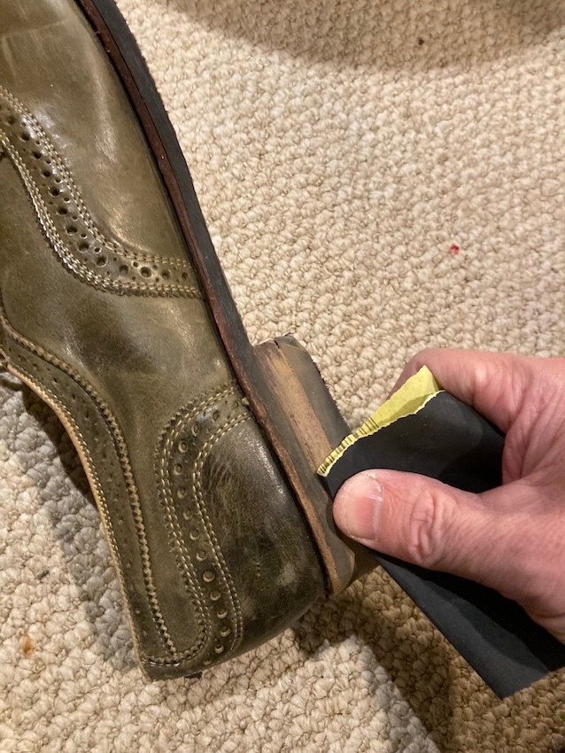

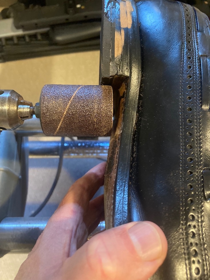

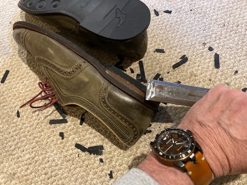

Having recently got a detached heel-lift on a pair of good shoes I enjoy (which were already recrafted already when I bought them), I thought I'd do my own repair. The new lifts were over-sized, so they had to be trimmed to size after gluing on. Shopsmith sanding accessories worked pretty good!

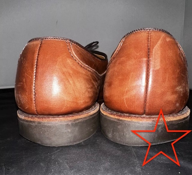

As it happens, I went "shoe thrifting" again just lately.

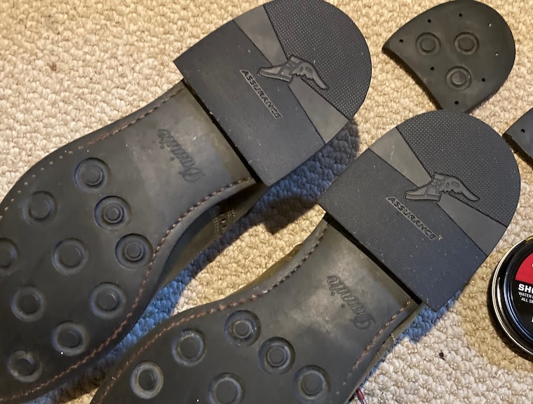

Here is the pair of USA-made shoes I bought very cheap:

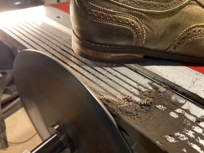

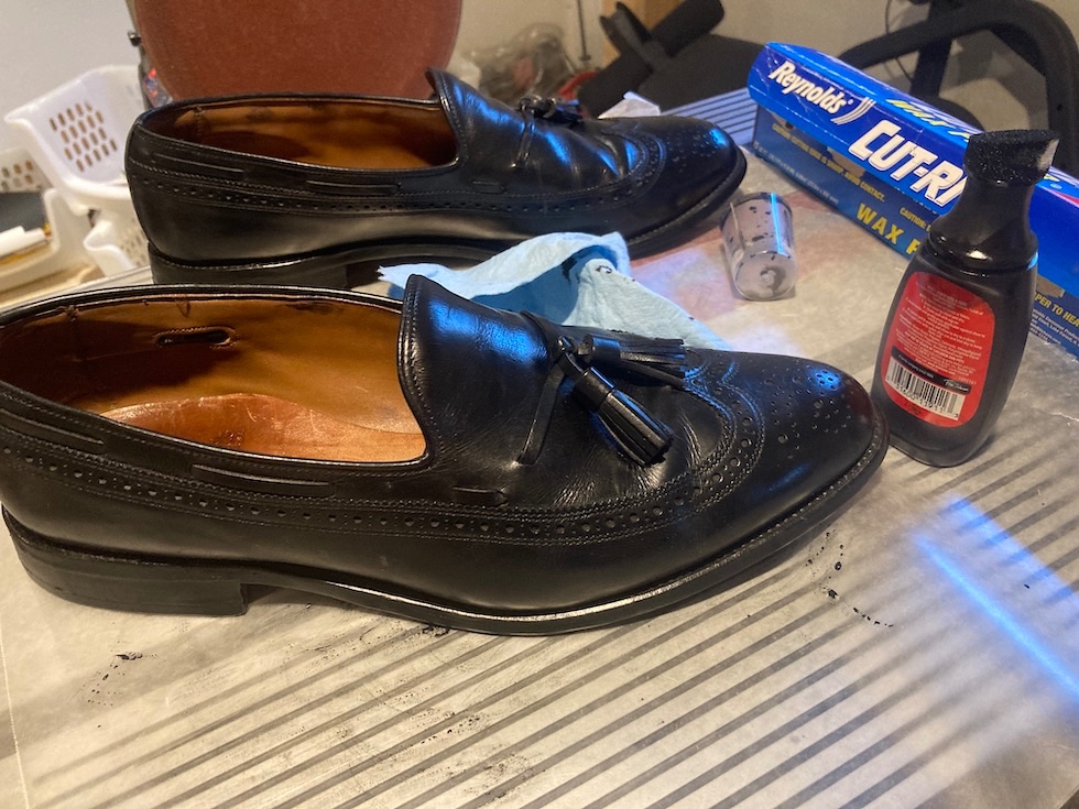

Here are my snips of replacing the worn-corner heels. We "Won't" show the extensive rubber heal removal process at the beginning. The bandsaw didn't like that job, so I hogged off a ton of material on the disk-sander instead. That disc sure stayed clean when working the rubber heels!

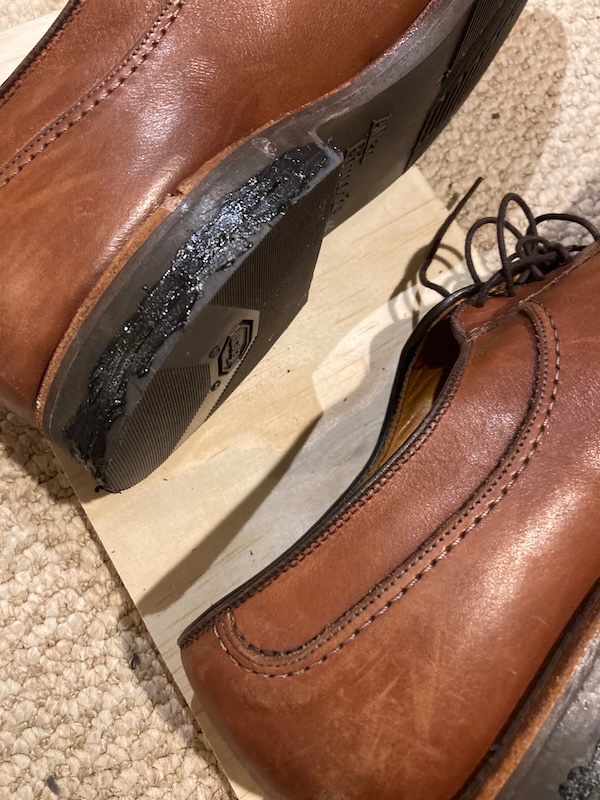

After contact-cement, I slathered on a bit of shop-dyed epoxy in any edge gaps:
The disc-sander, along with a slight table tilt, allowed making things flush between old and new parts:

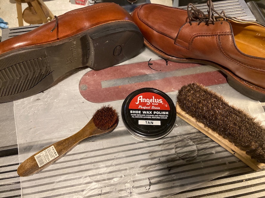

Then, some dying, cleaning, and waxing!
