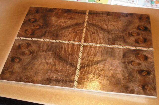

Hello,
This job is TBD for final destination. I didn't know if my amateur techniques in mind would work, but indeed they worked out pretty well.
To take some frustration out of a veneer glue-up, I just glued the four walnut quarters in a rough orientation, not minding their gaps (up to 1/4") and non-parallelism. (This is all atop a piece of salvage plywood at least 50 years old.)
Then I used the OPR with a 1/4" straight bit to "scribe" straight shallow channels from each board-edge toward the middle. I was a bit hasty and the lines aren't all perfectly centered, but mainly I was relieved to see how perfectly clean these channels came out. Then I was able to glue in pieces of store-bought 1/4" marquetry strips -- tightly.
After this I ran the board over my (home-made) Sand-Flee gadget several times, and shot it with shellac spray to check out the approximate final appearance. Now I'm taking a break to figure out which of my wish-list jobs this board will be used in.
Happy woodworking!

Post by Gene Howe »
Now, that's pretty neat.

Post by a1gutterman »
That is a good looking panel, Chris! Looks like a table top or cabinet door to me. :cool:
Tim
Hi Chris! That turned out to be a super looking matched panel! Very nice work!:D
Good use of the OPR. I just learned something. Thanks! This may be the push I needed to get me into veneer work.

Thanks for your kind words, gents. Looking forward to picking up this project again soon.

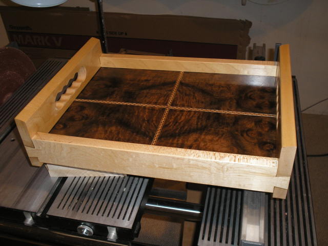

Tea Serving Tray
Post by nuhobby »
Well, this continued with some "design on the fly" to become a Tea Serving Tray (attached). There's a few things I'd do better if I knew what I was aiming toward from the beginning, but aren't they all (projects) like that....
[ATTACH]4145[/ATTACH]
Happy Woodworking,
Tea Serving Tray.jpg (47.32 KiB) Viewed 8226 times
Chris
Gene Howe
Posts: 3219
Location: Snowflake, AZ
Post by Gene Howe »
Quite nice. Really like the DTs.
Edited: DTs = dovetails NOT delirium tremors
