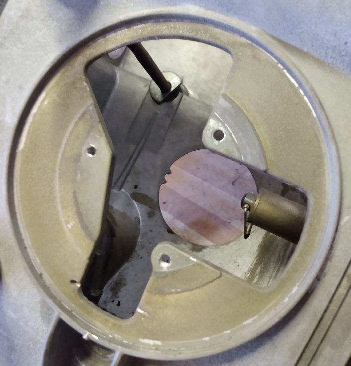

Mark V Model 500, Serial #321013 makes Bad metal-scraping noise.
Hello, people. I'm new to Shopsmith, and so far,
I Love the plentiful information that's available on the website.
OK, I acquired this machine just a few days ago, from a guy who said it "needed work".
It makes an ugly screeching noise, sorta' like metal-on-metal or even fingernails on a chalkboard.
He thought it might be motor bearings.
I've now removed the GE 3/4HP motor, and it runs nice and smooth and quietly by itself.

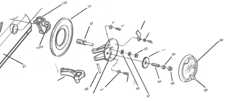

No motor bearing problem, me thinks. Hand-turning the SPINDLE KNOB (65) (not shown, with the POLY BELT (55) still attached)
makes all of that assembly turn smoothly and quietly.
Hand-turning the SPEED CONTROL (84) via the HANDLE (85) creates that metal-on-metal sound.
Seems like the SPEED CONTROL (84) and/or the (ROUND THING WITH TEXT) (77)
and/or the HEADSTOCK CASTING (67) are rubbing against each other.
With that picture of the insides, can ya' see anything that needs a correction?
HOW to disassemble those parts, to figure out what's rubbing / making some Ugly noise?
I did rotate that SPEED CONTROL (84), looking thru the hole; couldn't see how to remove it.
Note that this machine does not have the (PLASTIC?) On/Off switch (130 / 130a).
The On/Off is a metal toggle switch with four attached wires.
Thanks.

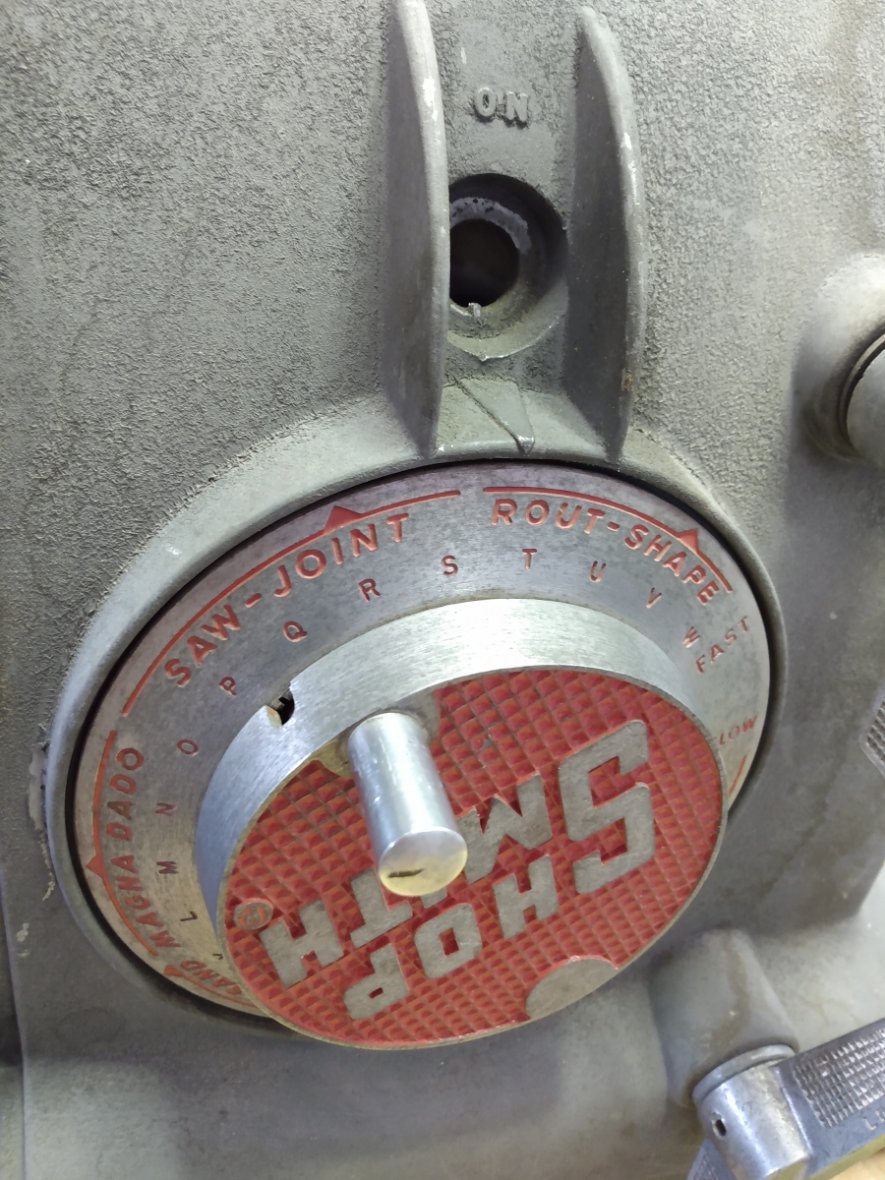

Re: Mark V Model 500, Serial #321013 makes Bad metal-scraping noise.
Thru that small hole under the "W" in saw joint insert a 3/32? hex wrench to loosen the set screw securing the knob to the worm gear shaft.
It may be the knob rubbing against the outer dial - if so there should be some wear marks.
I suggest lubricating the control sheave and a single drop of oil at the worm gear/casting gap.
Actually a complete lubrication should be done.(control sheave and floating sheave).

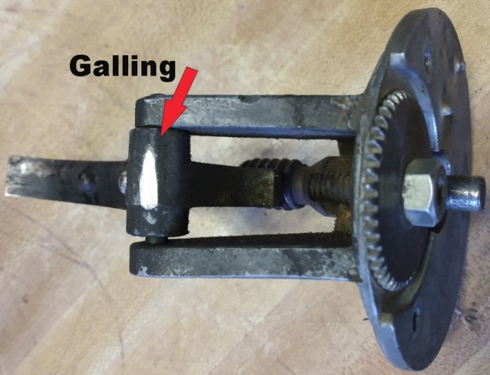

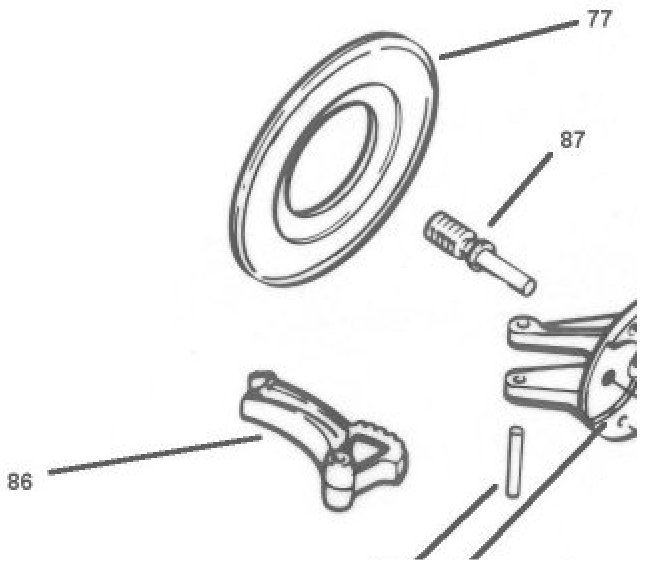

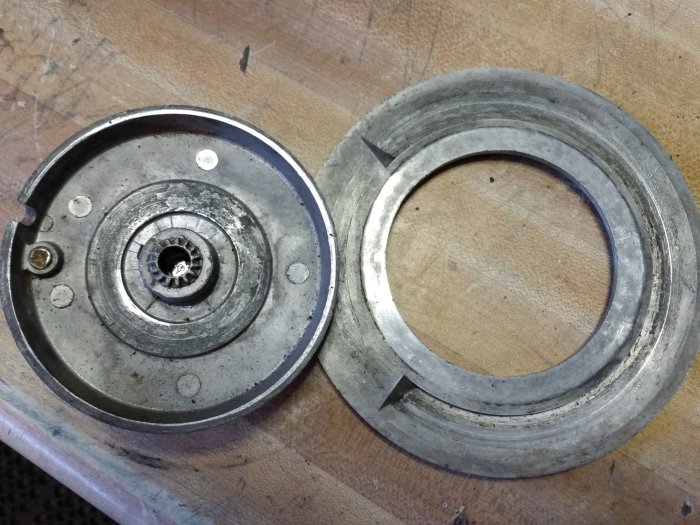

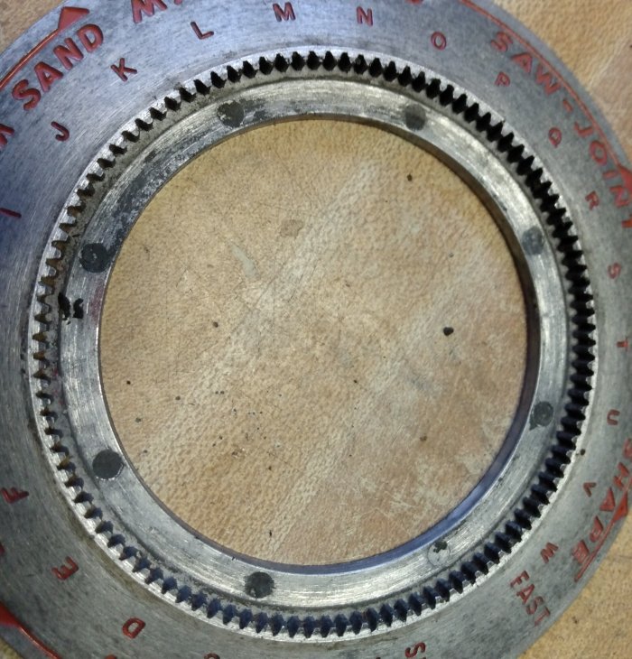

It doesn't make much difference, but your drawing is for a "C" headstock and your pictures are of a "B." The SN and 3/4 HP motor indicate an early version, a "Greenie" that's no longer green from ~1956. If it has not been upgraded, this means it has a "Gilmer" belt rather than Poly V. That gets into quite a few more internal differences. But none that I can think of relating to the speed control. I think of the Gilmer as similar to an automotive timing belt, it will not allow any rotational slip between the Idler shaft and main shaft. While a Poly V is more like a modern automotive fan belt and will allow some slippage.
Your pictures, first one after the diagram, shows what looks like metal to metal wear (galling) on the back side of the speed indicator dial. But does the noise only occur while adjusting speed? If it occurs while running normally I'd guess there is another problem as well.
- David
- David

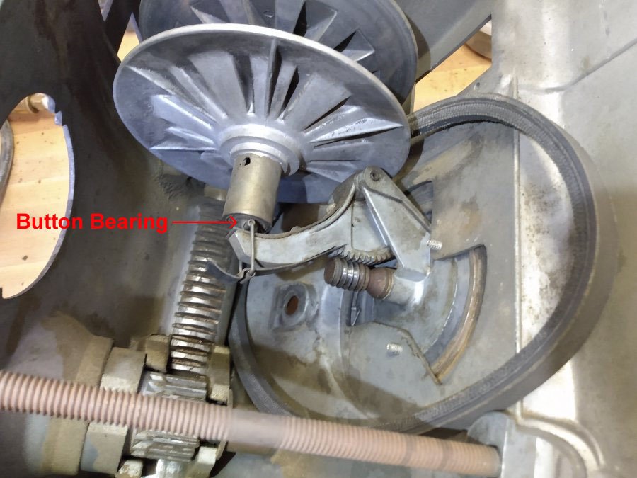

The type of noise you described sounds like what I heard when my button bearing needed replacing. If it is the problem, yours may be too far gone to save, but lubricating the control sheave (thru hole seen in same picture) and allowing machine to stay in drill press position overnight will let oil soak into that bearing.
Here is a link to my repair story: viewtopic.php?t=19133&start=20

DLB, I got that Parts Diagram from
https://www.shopsmith.com/service/heads ... iagram.htm
Where can I find a similar drawing for THIS machine?

BR549, that BUTTON BEARING has no play in it, seems tight. And the IDLER SHAFT SHEAVE (109) now slides nicely.

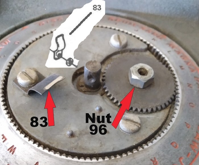

Looks like half of that (SPRING DIAL?) part (83) broke off. I did not find any piece that had broken off.
And that NUT (96) was only hand-tight. That just seems curious to me.

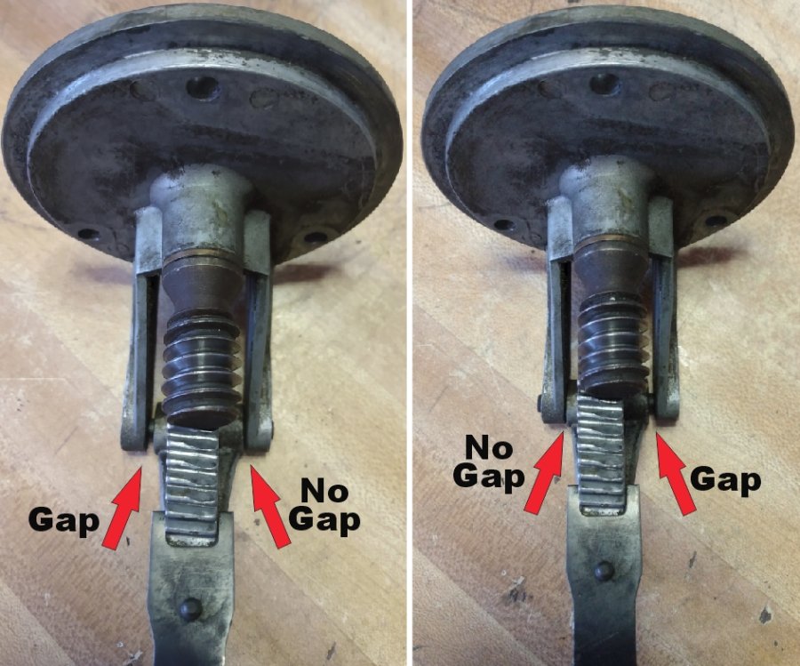

I cannot see a LOT of Galling on any of these parts:
The WORM GEAR (87) looks OK, but the QUADRANT ASSEMBLY (86) looks worn.
And there is some Play where (86) can slide sideways.
There is some evidence of Galling on (86) where it apparently rubbed against the IDLER SHAFT SHEAVE (109),
but there's little or no wear showing on that (109).

Suggest new quadrant, but, fix arms etc. on speed control. They are splayed. Replace pivot roll pin with bolt.
Somebody refer him to Bill Mayo's fix.
Here is Bill Mayo’s fix
Bill Mayo - Mark V Headstock Improvement - Repair Kit for Speed Control and Eccentric Bushing v1.01 13 Jun 2016.pdf- (949.91 KiB) Downloaded 227 times
