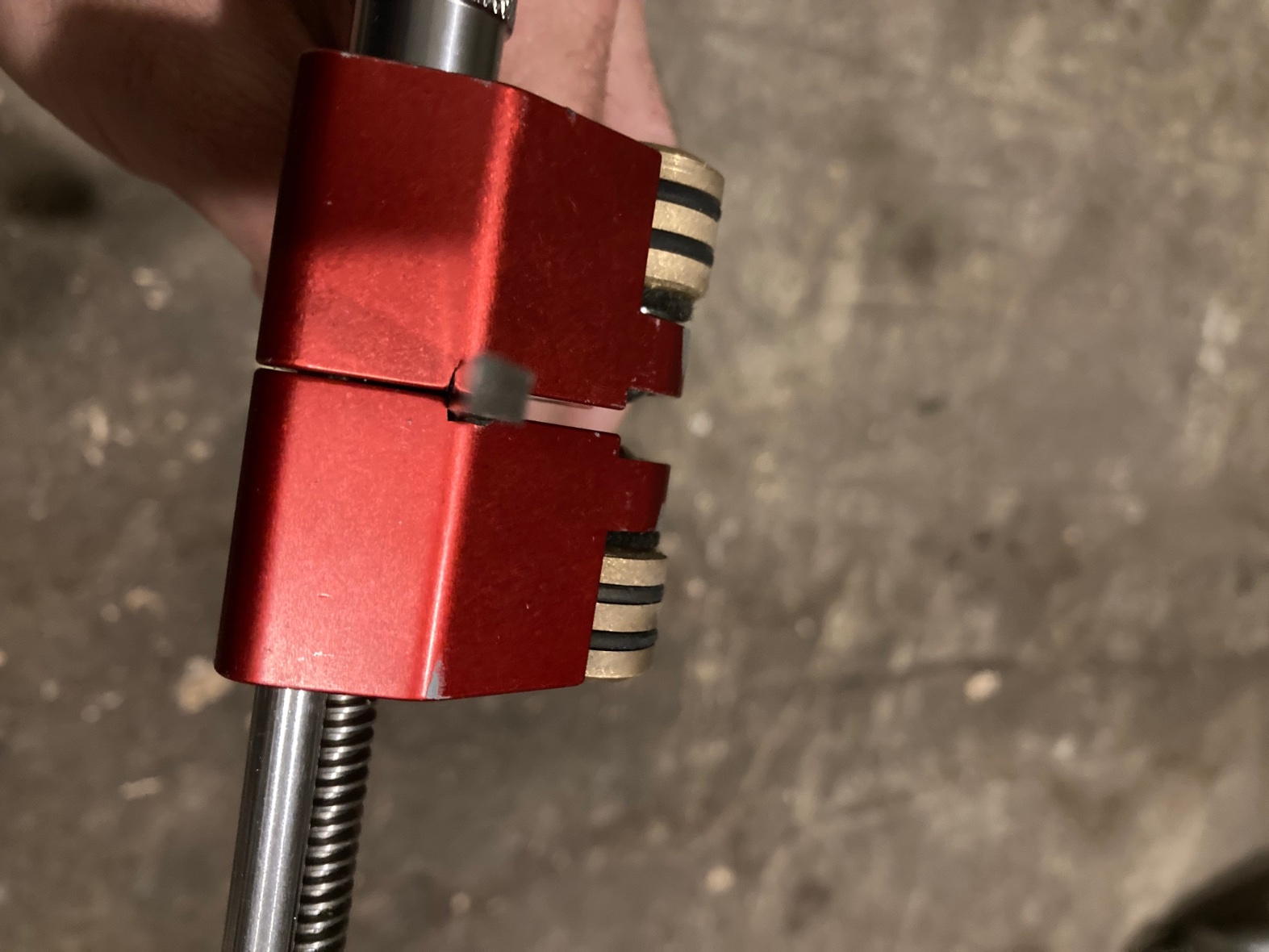

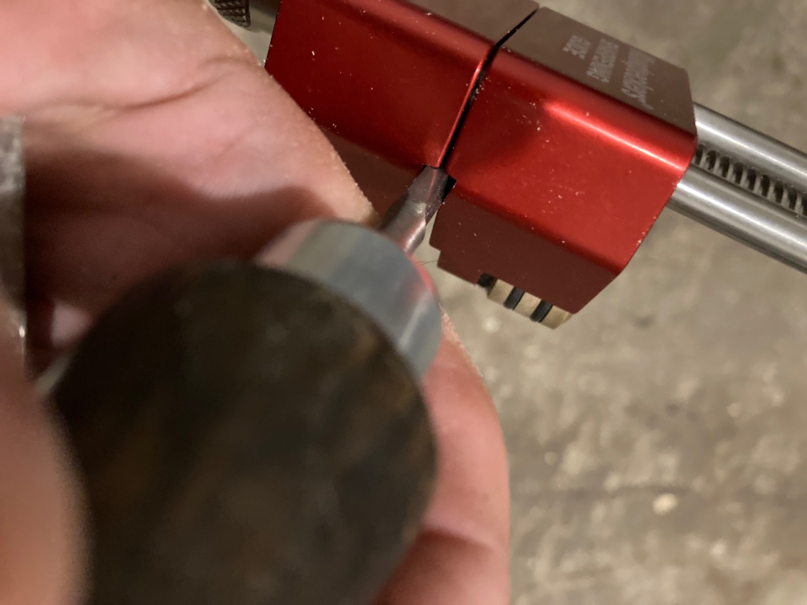

I purchased a Woodpecker’s sharpening kit online brand new and when I started using it I noticed my plane blades would get a sharp edge that was uniform, however they were uniform to an odd angle. It wasn’t until I tried using it on my 1/8” chisel that the problem was revealed. The workpiece was small enough to actually roll over in the rounded grooves at the shoulders that should be square. I tried squaring up the workpiece and clamping down even harder, to the point I took a channel lock to the knob to squeeze it down as tight as I could and still it immediately rolled over from the rounded corners.
The anodizing isn’t cracked or anything, there isn’t a scratch on it, so this wasn’t worn into the tool, it was machined out of square from the factory. That’s obvious. And Woodpeckers also verified the UPC label and said it was a legit tool. However, because I can provide any receipt that states it was purchased “new” implying that I could’ve bought it used, so they will not honor the warranty. I was shocked. I didn’t even ask for a refund, I simply wanted a tool that was machined properly and was willing to exchange it but they refused.
First of all, it shouldn’t even matter. This specific issue was clearly from faulty machining, likely a broken bit or maybe the workpiece wasn’t clamped down properly, but it’s clear that the shoulder is not square and it wasn’t from wear…because both sides are uniformly out of square. Now if this had been a craftsman or snap-on wrench, you can walk in and swap it out no questions ask. What else is there to warranty on a chunk of aluminum other than simply cutting it to the right specs? There is nothing else that can go wrong with a block of aluminum and yet they won’t even honor that much.
$200+ dollars for a paperweight. I’m in absolute disbelief this company is acting like sone Chinese-made toy factory and trying to use a technicality as a cop-out by claiming it might have been purchased used and so the warranty is void. Especially when it’s clear this defect was there from the beginning. If it it WAS purchased used…they sent out a defective tool and then referred to their shady fine print to avoid replacing it all for the sake of $200?! Can’t imagine what they will weasel out of with more expensive parts.
Do not buy from these scammers. They are not a proud USA company, they are a joke and they clearly build crap and then dodge accountability when someone expects their tool to work. I could’ve bought a veritas honing jog for half the price and it would probably work 100x better. Lesson learned I guess.
- IMG_2816.jpeg (344.79 KiB) Viewed 18807 times
- IMG_2815.jpeg (375.46 KiB) Viewed 18807 times

That tool was retired in 2020 so if the OP just bought it (which he doesn’t explicitly say but seems likely), then by necessity he was not the original purchaser.
And if I’m understanding the “problem” correctly, it’s made as designed. The surfaces which hold the tool aren’t supposed to be 90 deg and parallel, they’re slightly “wedge-shaped” to hold the tool securely and against the bottom (top?) of the channel. At least that’s how my non-woodpecker sharpening aid is made. Works great for wider tools but for extremely narrow tools I could see running into the problem the OP describes. Woodpecker states a maximum tool width for which it works; they should have stated a minimum as well.

I doubt Woodpeckers envisioned any one sharpening a 1/8" chisel.
I think thee envisioning a work around will be more productive than bashing the manufacturer.
