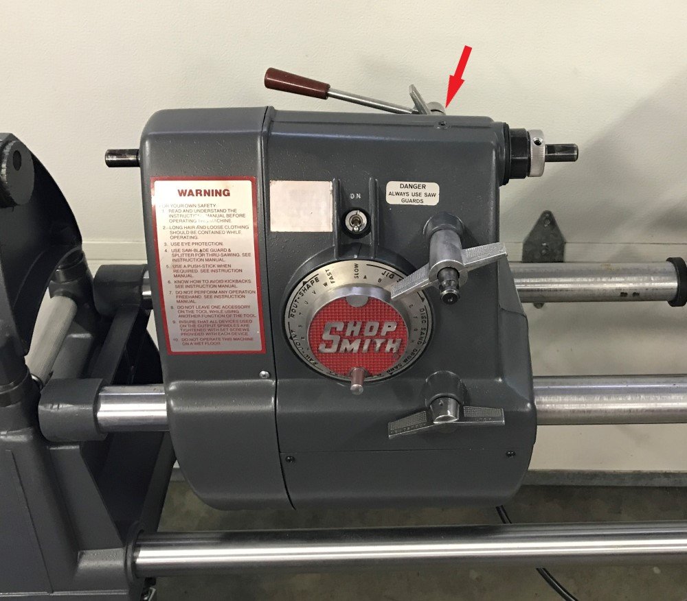

As David said you can try just the Quill first which is an easy change. The picture below shows a Headstock and the arrow shows where the Special Set Screw is located that needs to be un-screwed partially to release the Quill. If it has never been done before it may be covered with putty from the factory. Turn the Quill Feed Handle until the Quill stops advancing. While still holding the Quill Feed Handle remove the old Quill and insert the new Quill keeping the groove in the top of the sleeve up. DO NOT let go of the Quill Feed Handle while changing Quills. Retract the Quill Feed Handle until the Quill is fully retracted which may require some turning of the Quill's Spindle to line up the splines into the Drive & Ring on the Drive Sleeve Assembly. Advance the special set screw back in and ensure it is positioning in the groove on top of the Quill's Sleeve. This keeps the Quill in proper alignment using a Full Dog Set Screw. Once lightly snugged down back it off a quarter to half turn to keep it from locking the Quill in place. Unlike normal set screws in use this Special Set Screw is a guide and not used to lock something in place.

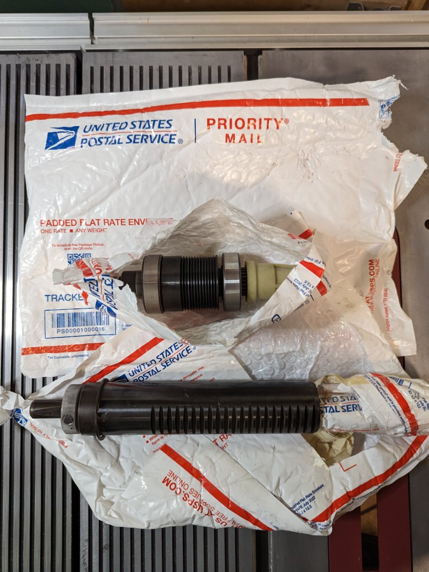

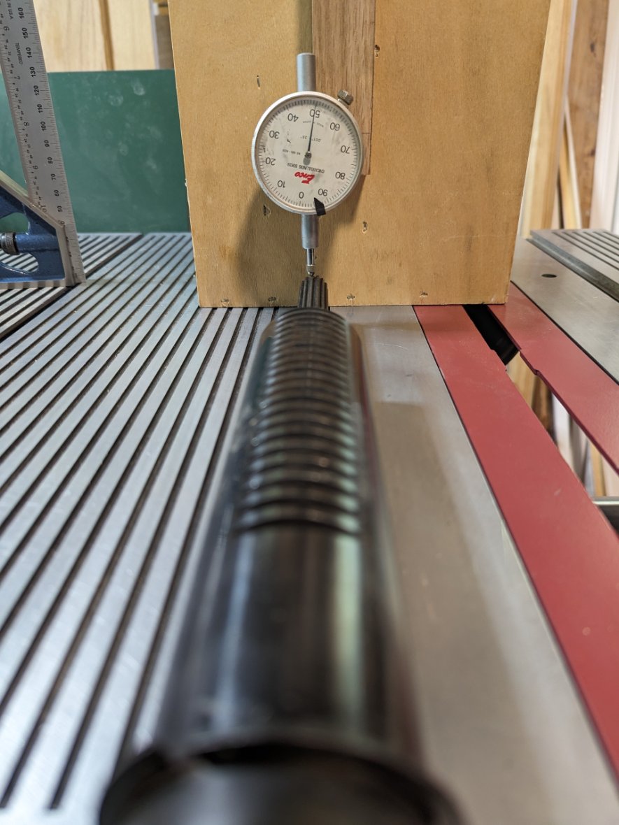

Re: Quill Questions
Argh! "Lightly used," but maybe heavily abused! Just got the parts in the mailbox and as soon as I pulled the quill out of the questionable packaging, a quick spin by hand showed a visible bend in the splined shaft. About .050" total variance per my measurement. The business end has less than.001. As far as the version of this double bearing shaft goes, the outermost bearing is about 4.25" back in the quill tube.

Re: Quill Questions
Could easily been bent in shipping. This is the packaging the seller sent it in. Note the splined end wrapped in one more (thin) layer of USPS Priority bubble wrap.
