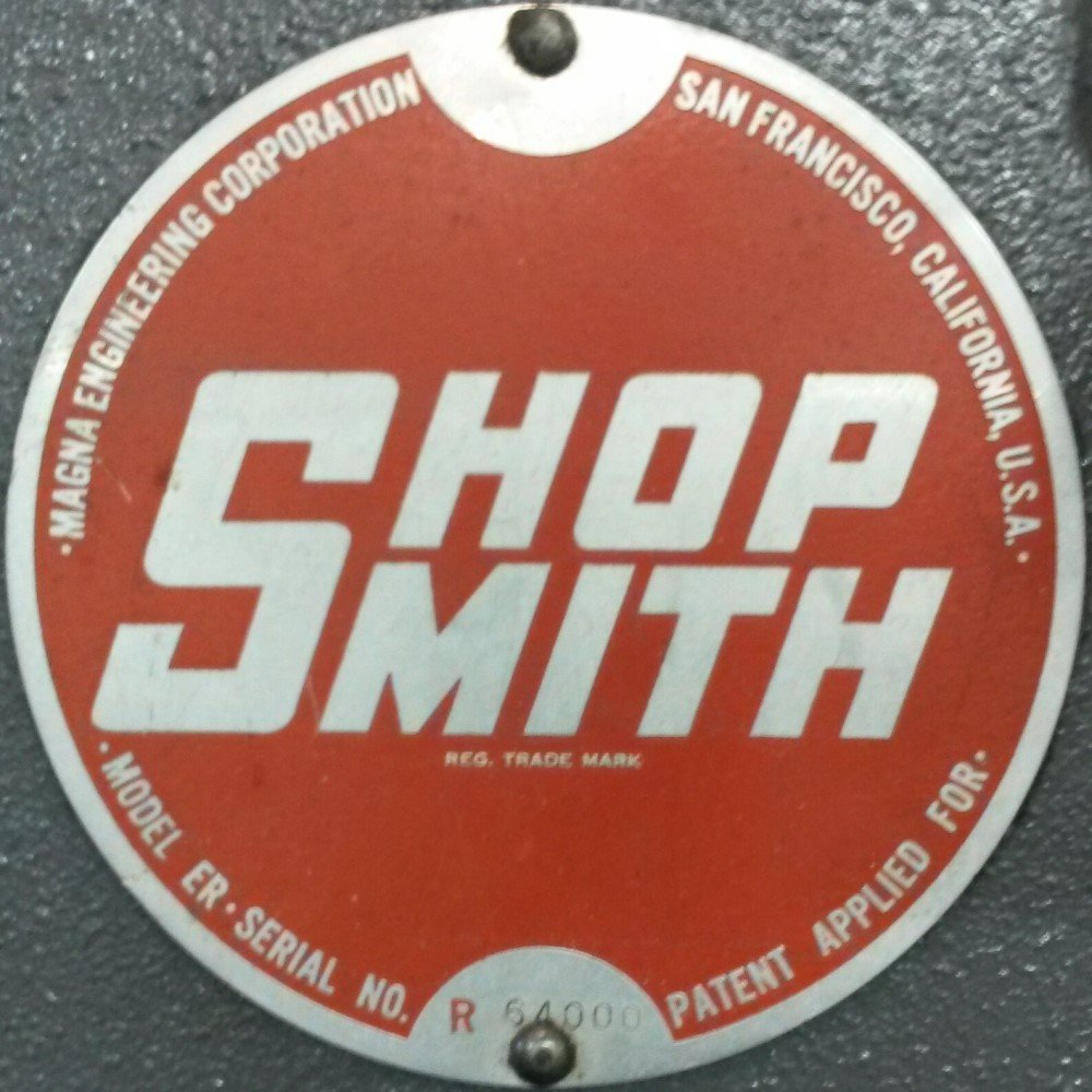

I came across this machine the other day, and was wondering where it fits in the grand scheme of things. The round data plate says "Model ER Serial Rxxxxx". I went here: viewtopic.php?t=20615 and followed the bouncing ball to the google drive, and followed that to some of the pdf's that discuss early machines.
Here's the conundrum, and maybe only an old guy chasing shadows.
Am I correct that all "ER" models are "10ER"?
The S/N is in the low 5 digits. It has a 1/2HP tan/blue motor and needs complete restoration.
Have I found a post-war classic machine that has any historical significance?

Yes it is a model 10ER. There was a point in time when the data plate only said ER. Russ will chime in with the details on that. No there is nothing special about it only saying ER on the plate.

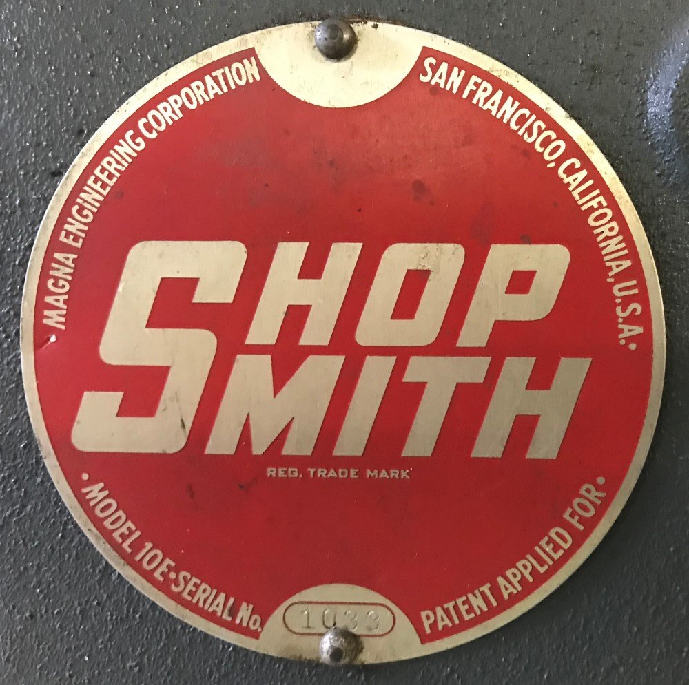

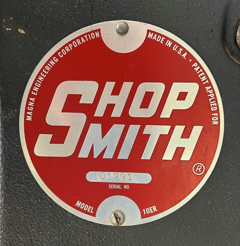

As John said I would I am chiming in. Here is what I believe is the reason for the 10ER Logo/Serial Number plate only saying ER. When Magna Engineering changed from the Model 10E to the 10ER they made only minor changes to the Logo/Serial Number plate. There was no longer a red printed oval around the serial number allowing more room for the longer serial numbers to come. The other was changing 10E on the lower left side of the plate to only ER as there wasn't enough room for 10ER unless the area was redesigned. About half of all the Model 10's made had only ER on their Logo/Serial Number Plate. The tools having only ER on the Logo/Serial Number Plate did have Model 10ER on their Owner's Guides. Later the Logo/Serial Number Plate was redesigned and stated Model 10ER. Below are examples of the different Logo/Serial Number Plates starting with the 10E followed by the ER and last the 10ER.
_ .
As for any particular Model 10E or 10ER being special that is a matter of opinion. There are some I feel are special. Everett has one of the chromed Model 10's Magna did to celebrate a milestone or for other special reasons. The first shipment of 250 Shopsmith Model 10E's made, to me deserve being considered special. The first logo/Serial Number Plate above S/N 1033 is one of those first Shopsmith's made. Of other interest is Model 10's with strange anomalies related to their serial number and the Headstock/tool it is on. That and the rest of the information above is discussed in the thread I started titled Shopsmith Model 10's What When and Where which can be found at the following link.
_ .
