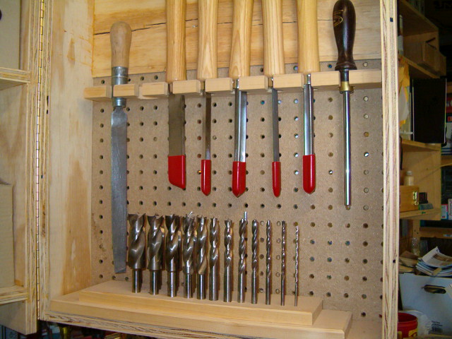

I just can't recommend screwing around with the bits. I know a lot of folks do, but other than polishing the shafts and sharpening, I don't mark them. To solve the problem of identifying bits, I made a simple stand where they are stored. Each of the smaller bits drilled their own hole. Because bits only fit in their own hole, I haven't bothered to mark the wooden stand, but it could be marked to identify sizes. The bits larger than 1/2" can be mixed, but really that is no issue.
[ATTACH]3956[/ATTACH]
- HPIM1784.jpg (110.54 KiB) Viewed 7893 times

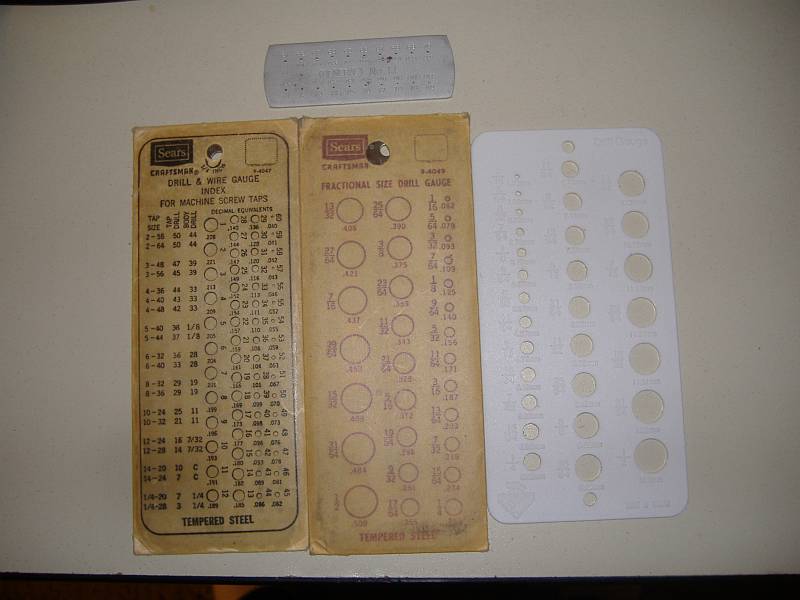

Hi,
You might want to invest in a drill gauge(s). They are useful for more then sizing drills but when your vision isn't as good as it use to be they are a must have.
Pictured at the top is a 61-80 for number drills. Left is a 1 to 60 for numbered drills, center is a 1/16 - 1/2 fractional. The plastic gauge even works fine and it was free from Handyman when they use to try and sign me up...
[ATTACH]3957[/ATTACH]
- drill gauge.jpg (57.94 KiB) Viewed 7894 times
