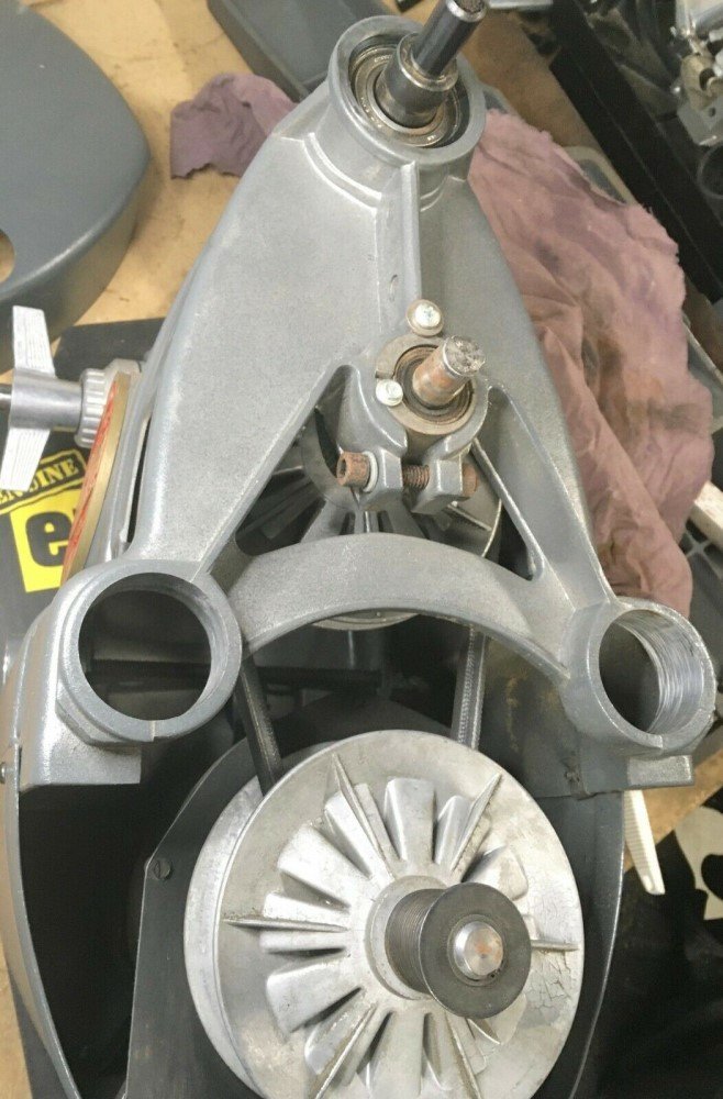

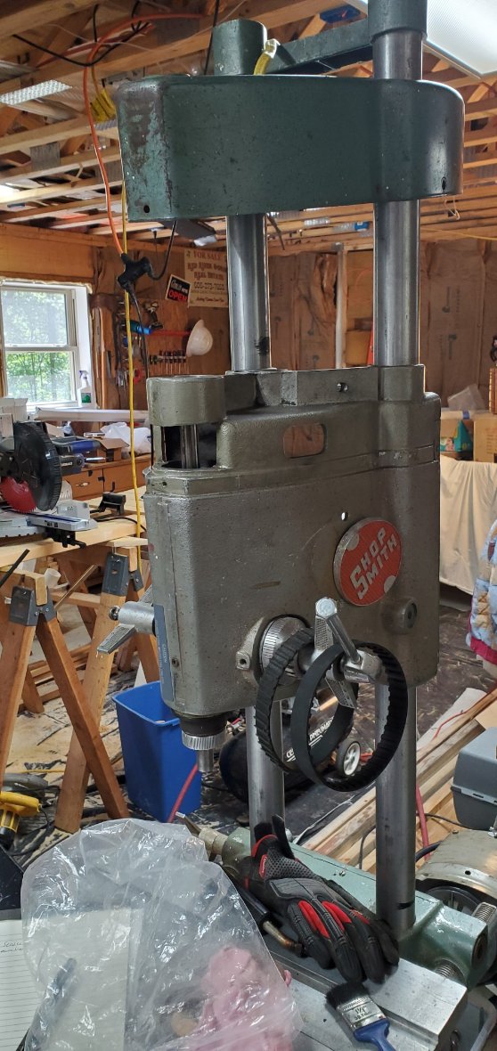

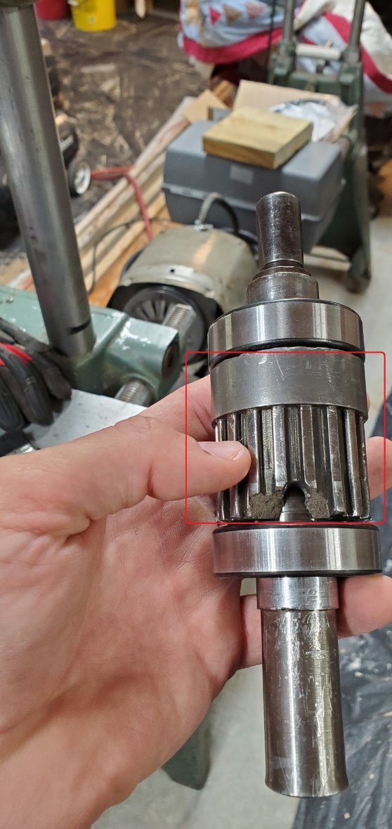

I am hoping to find the part circled in red. I have been unable to find this piece part anywhere.
I was in the process of restoring the power head. New drive belt, new gilmer belt, new control assembly, new control sheave, and $70 for two new timken ball bearings for the drive sleeve. Everything was going smoothly until the cast part chipped off where the setscrew fits while installing the new bearings. I am pretty sure that this was the worst part for this to happen to knowing the part evolution for this assembly. I don't think it is the clutch version of this part (I can't even find what SS calls this ''sleeve gear'') but I am sure someone here can clarify that and if it is the clutch version. My issue is that I have half of the cost of the poly drive system in parts for the gilmer system and would prefer to finish out the work as it is unless there is a cost effective solution I am unaware of.
I was hoping to find help tracking down this part or what course of action you guys think I should take.
I know I will have to remove my brand new bearing which is fine. I even considered removing my hopelessly broken ''gear'' and drilling and tapping a new hole for the setscrew in an undamaged section, but there are several potential problems with that. The vibration might be pretty bad. There are also a few small other cracks in the teeth so I'd really be pressing my luck if I have to go this route. I checked ebay with no luck so far but will keep checking.
Thanks in advance for any help anyone can provide.
Dan

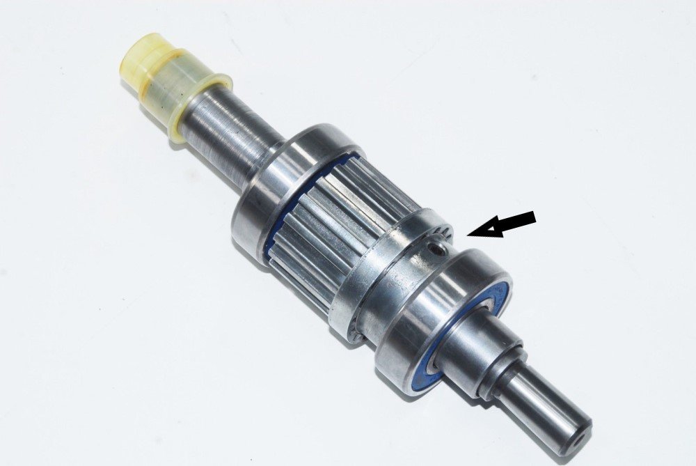

Your Drive Sleeve is the non-clutched one so I expect you have an early Greenie. It should be replaced. Good news is you can replace it with either the non-clutched like you currently have or the clutch version of the Gilmer Drive Sleeve Assembly. If you go with the clutch version, it won't be original, but the change was made to help reduce breaking belts.
Below is a picture of the clutched Gilmer Drive Sleeve Assembly for reference.
_
Gilmer Clutch Type Drive Sleeve - arrow.jpg (53.35 KiB) Viewed 4951 times
See where the set screw is on this clutched one compared to your non-clutched Gilmer Drive Sleeve Assembly. That is the easiest way to tell the difference when looking for one. I do see them for sale from time to time so be patient and you will find one.

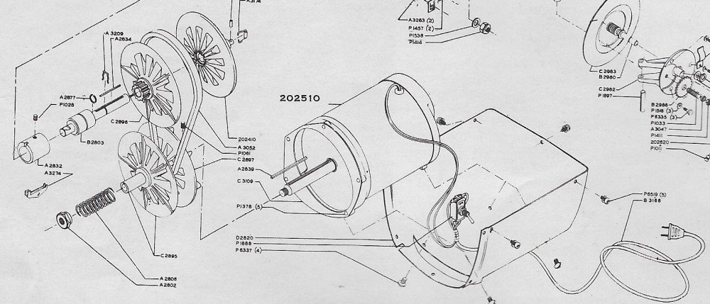

Since it appears you likely have an early Mark 5 Greenie there is another problem that arose with the original Headstock design. This has to do with the Idler Shaft remaining in the correct position. In the parts drawing below from the April 1955, 3rd edition of the Owner's Guide you can see part number A3274 the Bearing Retainer (near the left edge of the drawing) that was added to keep the Idler Shaft from moving in and out of the mounting point of the Headstock Casting. Trying to keep it in place by over-tightening the bolt & nut around the Eccentric Sleeve (P/N A2832) will break the casting.
_
Motor p26 8-55 .jpg (105.66 KiB) Viewed 4951 times
These Bearing Retainers were made available to owners of the earlier Mark 5 Greenies made so you may already have them. They come in pairs and go in-between the Headstock Casting slot that the bolt goes through. In late 1955 a screw was added to the Headstock Casting as shown in the picture below to keep the Idler Shaft Assembly from being pushed out of position.

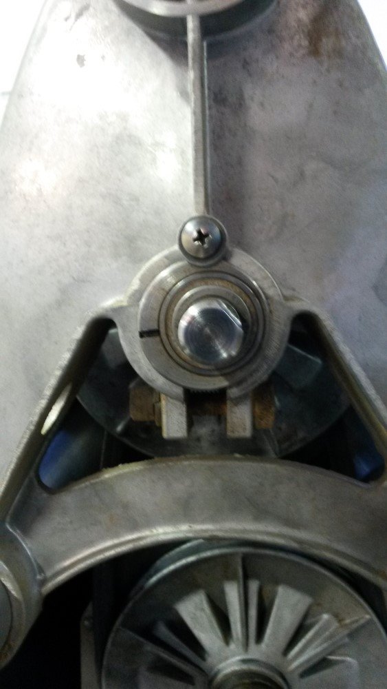

Later a screw was added to the Eccentric to keep the Assembly from being pulled in as shown below.
_
inside belt cover.jpg (124.25 KiB) Viewed 4947 times
Some owners have added these screws to their Headstocks. Sorry I do not have a picture showing the Bearing Retainers in position.

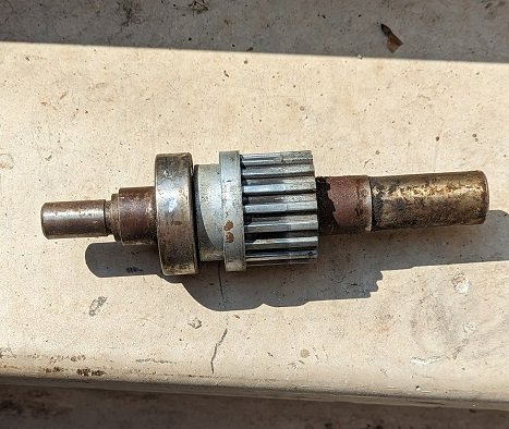

I can't look until later, but I have parts left from 2 Gilmer drive upgrades. I'll let you know what I can find. I do recommend an upgrade to the Poly-V belt if you can manage it but just this part could get you up and running for now.
ETA: I remembered exactly where one part was and got it out. Does this look right? I don't know where the plastic piece is though. You can have it for the cost of shipping and some time spent cleaning.
gilmer drive part.jpg (49.65 KiB) Viewed 4932 times
Ed from Rhode Island

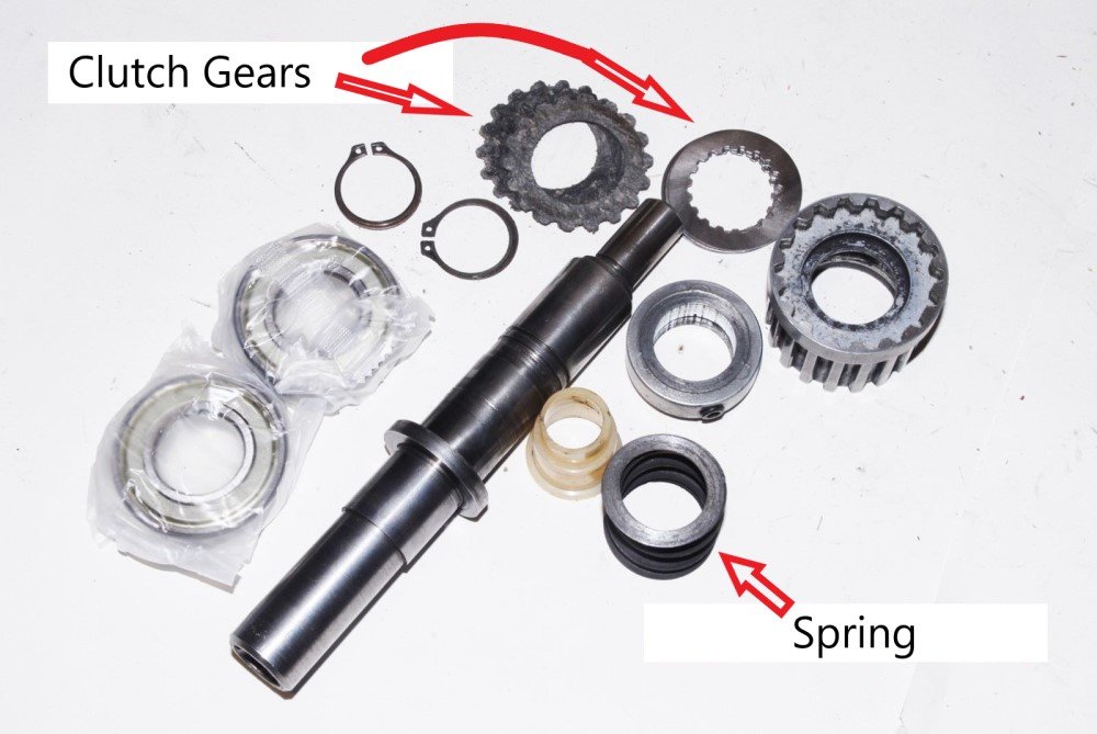

The Gilmer Drive Sleeve Assembly Ed shows above is the later clutched version. It is missing one of the bearings. Since you are going to all the trouble of restoring this Drive Sleeve Assembly the bearings should be replaced anyway. The plastic part has no mechanical use for the Gilmer Drive Sleeve Assembly but if I recall correctly was for some noise dampening. It will work without it.
The picture below shows the parts of the clutched Gilmer Drive Sleeve Assembly.
_
Gilmer Clutch Type Drive Sleeve Parts.jpg (89.21 KiB) Viewed 4906 times
I show this because unlike the non-clutched Gilmer Drive Sleeve Assembly this one has several internal parts for the clutch. Taking it apart is not difficult, putting it back together is another story. When reassembling it the spring must be compressed and the clutch gears (internal and external like washers) properly placed to get the correct friction from the clutch. If it doesn't slip it would be like having a non-clutched Gilmer Drive Sleeve Assembly. If it slips too much, trying to work could stop the Spindle and what is attached to it.

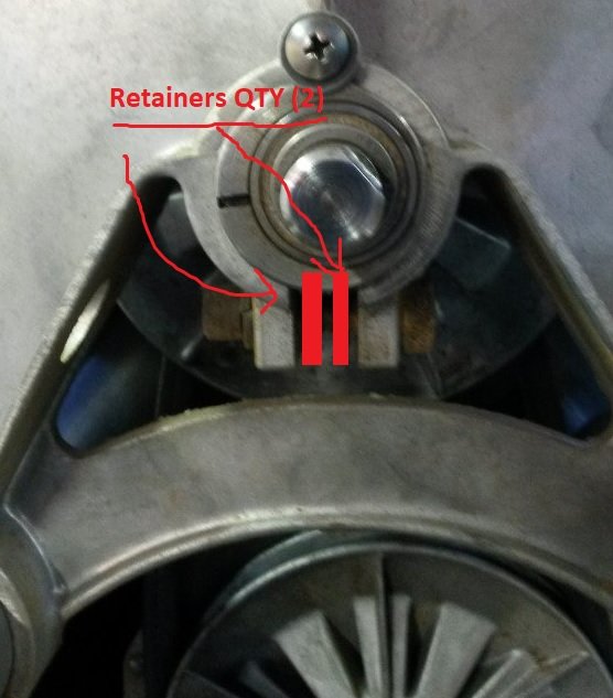

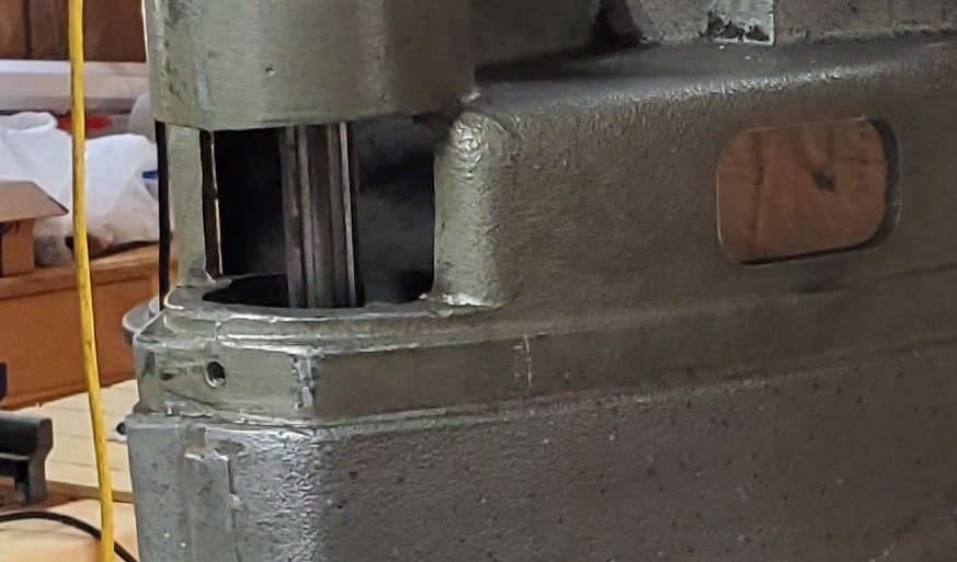

Russ, Thank you for the detailed explanation of things. The setscrew hole is where the gear shattered. My old greenie does have the pair of bearing retainers you mentioned and are positioned in red (I borrowed your photo :D)
Retainer position.jpg (51.21 KiB) Viewed 4737 times

The Quill (splines) is the same for both the non-clutched and clutched Gilmer Drive Sleeve Assemblies. The Splines changed going from the Gilmer to the Poly V Drive.
It is not necessary to dis-assemble the clutch in the Drive Sleeve Assembly to replace the bearings. The reason for dis-assembling it would be to check and clean the parts if needed. If the assembly is in good condition and has the proper slip, then go ahead and use it. The concern is too much slippage or too little slippage which would be like your original non-clutched Gilmer Drive Sleeve Assembly. For the one Ed showed if you are comfortable using it without opening it up I would clean off the surface rust on the shaft ends and install the new bearings.

Russ answered those questions for you. I found the second one I have and it's cleaner on the interior end, but the aux spindle needs cleaning like the one in the photo above. No idea what condition the clutch is in. PM me with your address and I'll send it out.
