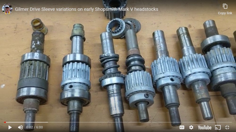

Jacob Anderson has a video on variations of the Gilmer drive sleeve that he had seen.

I’ve seen the video. That and a past post here made me think that my drive sleeve (like the second from the left in the video) was newer than 1956.

2) From what you say this is a clutched Gilmer Drive not the earlier non-clutched Gilmer Drive. The change from the original non-clutched Gilmer Drive to the clutched Gilmer Drive occurred by July of 1954. The beginning picture (shown below) from Jacob Anderson's video shows a non-clutched Gilmer Drive on the left and several clutched Gilmer Drives in various stages of disassembly to assembled. In 1956 the nylon cap was added to the drive sleeve to reduce noise.

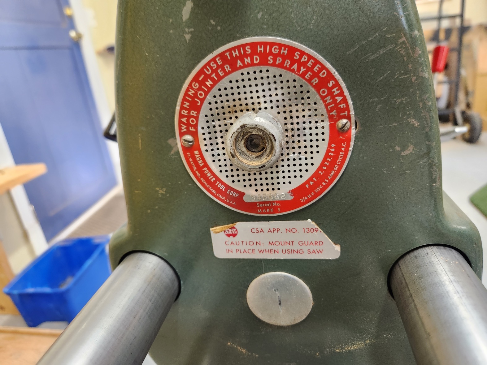

What is the serial number? That could help but the serial number is on the vent plate attached to the belt cover. If it is not the original Belt Cover for that Mark 5 it may not be the original Vent Plate and serial number either. There is a lot of missing information for 1956 and 1957 as to beginning serial number for each month's production.A couple of weeks ago I bought what seemed to be a 1956 (from the serial #) Greenie. While investigating a slipping Gilmer drive I found a few anomalies.

Serial Number 345662 would have it likely being made in May 1957. That is one of the months not having a starting serial number on the old production chart. See attached PDF below.

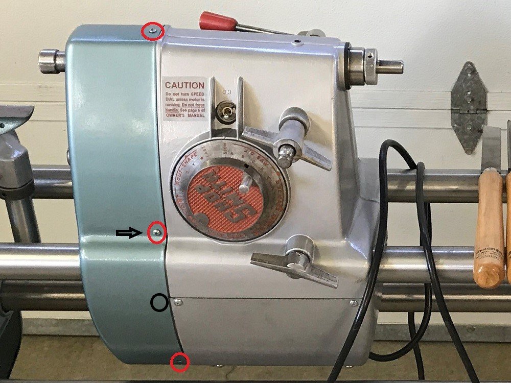

If there are only two holes on the Headstock casting and none in the Motor Pan to attach the Belt Cover then those parts match for being a mid 1957 or later Mark 5 Greenie. The Screw locations for 2 screws are one each side of the Headstock casting which is the location still used today indicated by the arrow in the picture below. For 6 screws the additional screws are one at the top of the Headstock, one at the bottom and one on each side of the Motor Pan above the Bench Tubes shown in the red circles in the picture. For the 8 screws the additional 2 are located on each side of the Headstock Casting where it meets the Motor Pan Indicated by the black circle.
_ The above is a "B" Headstock having 6 screws to attach the Belt Cover, but the lower Motor Pan Screws are missing. This "B" Headstock is typical of those beginning with the change to the "B" Headstock in October 1955 until the change to only 2 screws to attach the Belt Cover in early 1957.
_

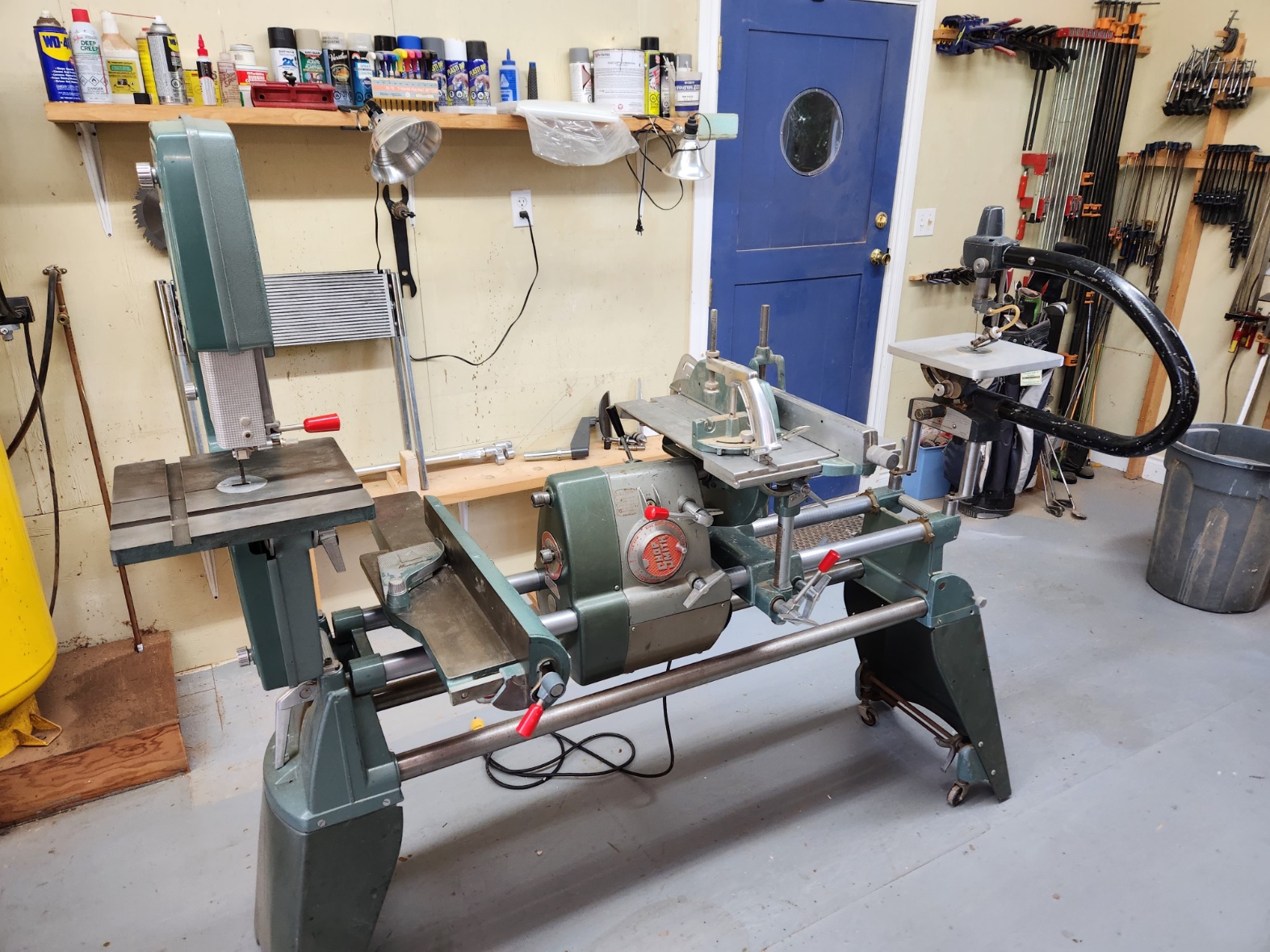

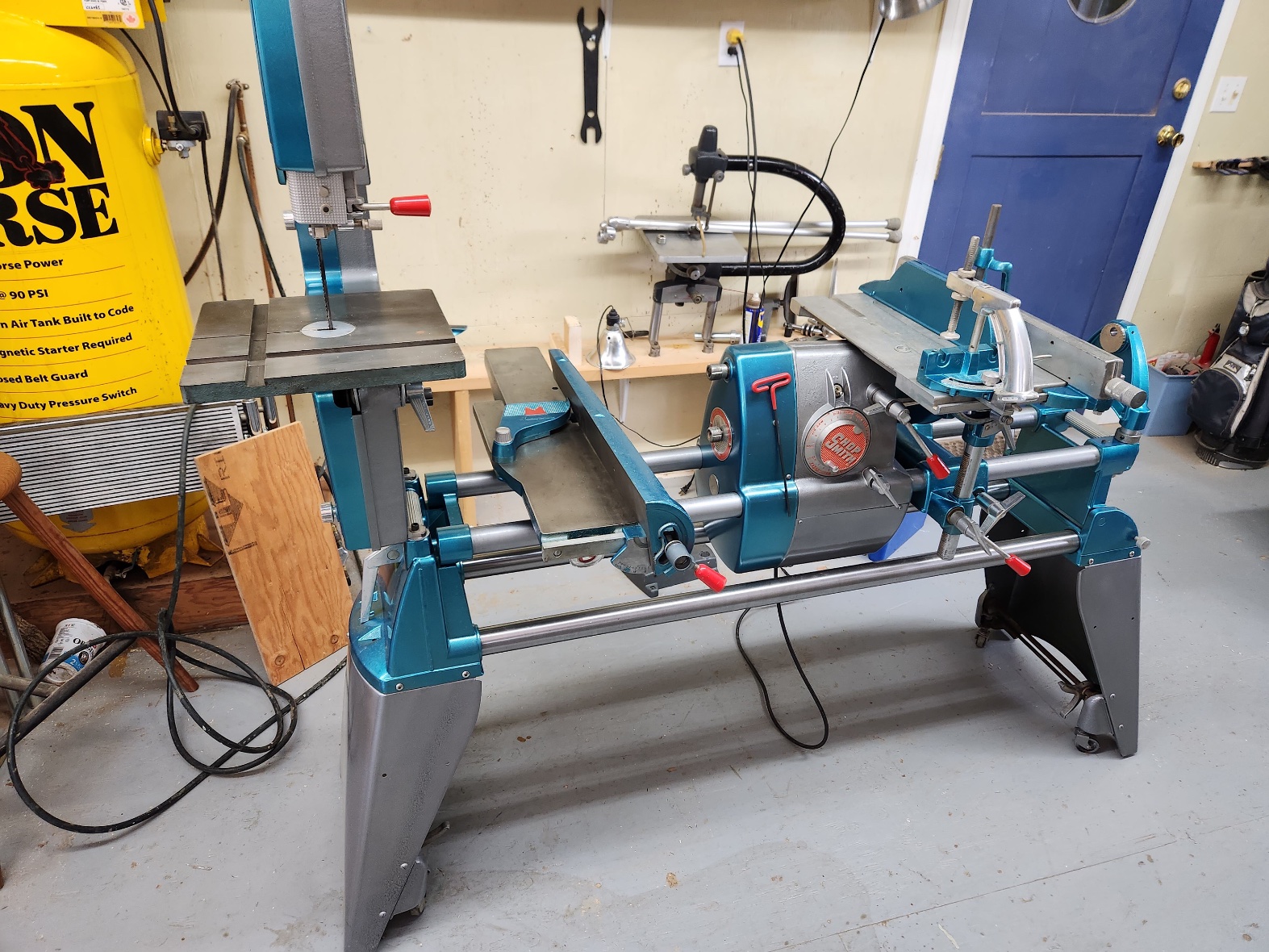

Only two holes in the headstock and none in the motor pan (but it appears to be from a Goldie …. maybe)
Hard to tell from the pic but the pan is definitely not silver or green. It’s brownish Anyway it looks like this now.
