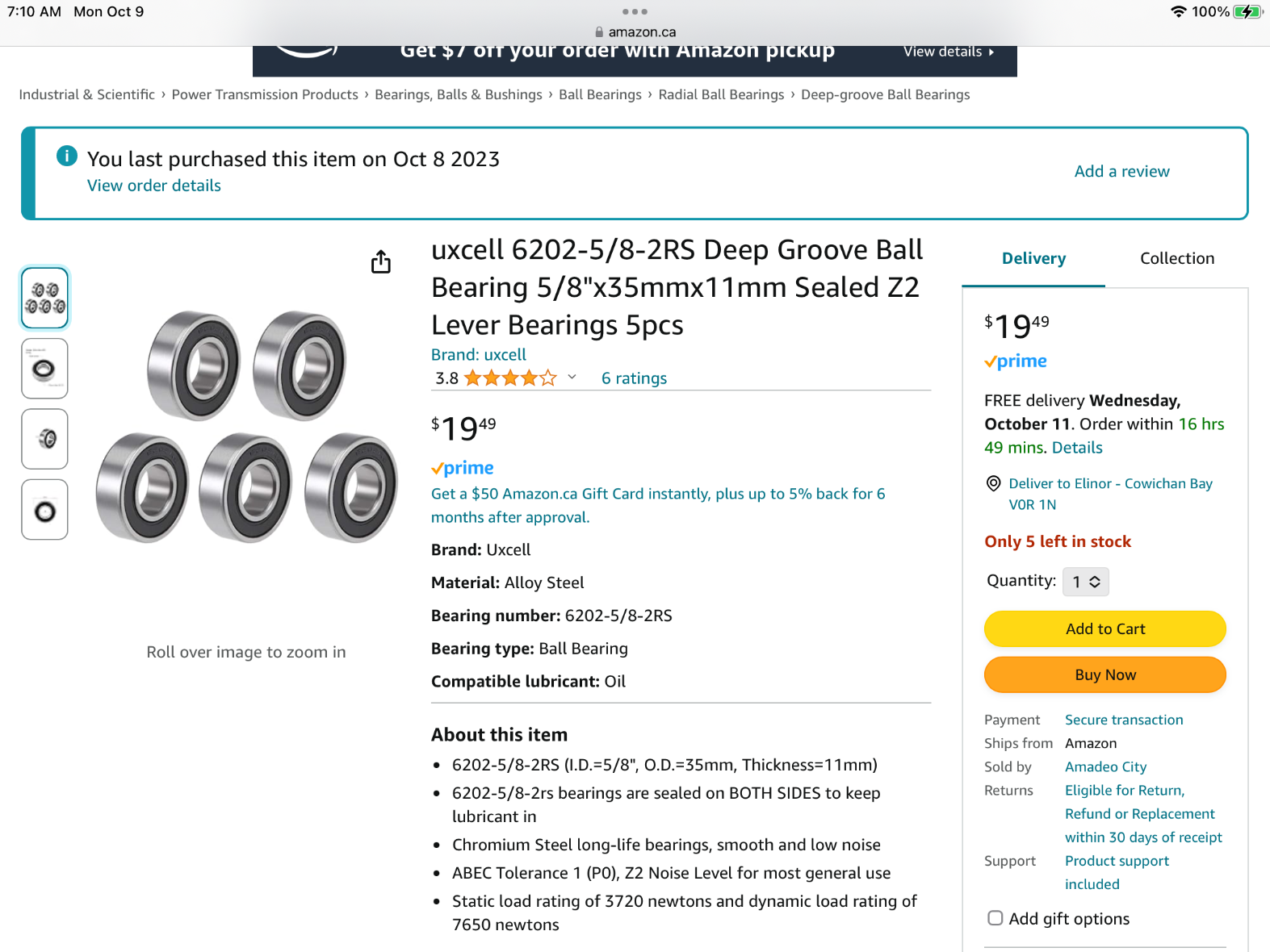

I am replacing the quill bearings on my three machines. I got a bag of five on Amazon and have fitted two to the Mark VII and the Mark 5 but when I pulled the shaft on the Mark V (510) I noticed the front end bearing was 3/64” less in thickness than the other two (and my replacements). Does anybody know if that 3/64” will prevent the snap ring from going back in the quill end? The ones I bought exactly match the measurements of the old bearings in the Mark VII and the Mark 5 and are pretty bang on 1 7/16” thick. The one in the 510 is about a 64th over 1 3/8”. Obviously I don’t want to pull the bearing and press a new one on only to find that I can’t get the snap ring back in.
Thanks In advance for any help.

Thanks. The bearings I have are 6202 and as I said they are just a shade thick. Otherwise they match perfectly. I’m tempted to press one on and see if I can still get the snap ring in but thought I’d ask first to see if someone already had.I’m not very worried about the second bearing. Personally I’m not convinced it does enough to get much wear.
Re: Quill Bearings
FWIW the M5/MVII quill bearings are 5/8" x 35mm x 11mm [6202-10-2...]

Yes, those are the ones I have, an odd mix of metric and British.

Thanks. I’ll check the number today but they are definitely not 12mm wide and are almost certainly the 10mm as you say.
Strangely the bearings I bought that fit the other two press tight were sold exactly as JPG a posted, 5/8” X 35mm x 11mm which i do find strange.
As for shaft size the 510 seemed identical (5/8”) to the others with dial caliper anyway. 5/8” is only 15.9mm so 17mm should show different.

Just FYI the ones I bought didn’t have the -10 marking, just said 5/8”.
