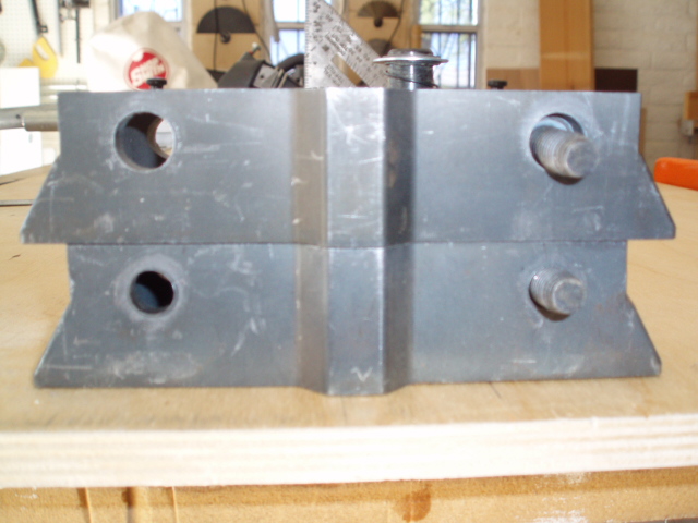

I have two photos that were taken for another purpose but might help you.
[ATTACH]4023[/ATTACH]
This photo shows the table stop pin. It is on top of the trunnion and has a spring that you can barely see in this photo.

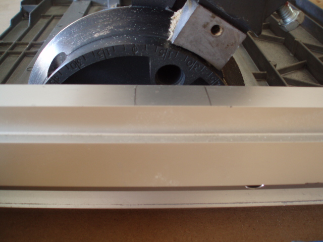

[ATTACH]4024[/ATTACH]
This photo is of the other trunnion which is obscured somewhat by a piece of aluminum rail. I hope thesehelps you locate the stop pin.

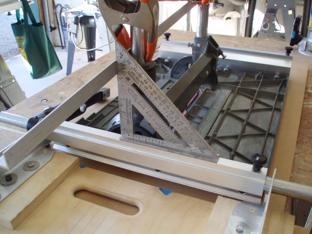

[ATTACH]4025[/ATTACH]
Underside of Main Table.

The stop pin that you had depressed strikes a bolt head when you tilt the table to 0*. There is another bolt identical to it on the other trunnion. You must adjust these bolts to acquire the proper table position.
NOTE: The stop pin is NOT part of the adjustment procedure for 0*. Adjust for 0* by using a good square or some other sort of angle indicator (I use a Wizey Gauge). Using the square, set the table for 90* to the blade and then set the stop bolts using the stop pin.
The stop pin is for use when returning the table to 0* after doing some other operation.
