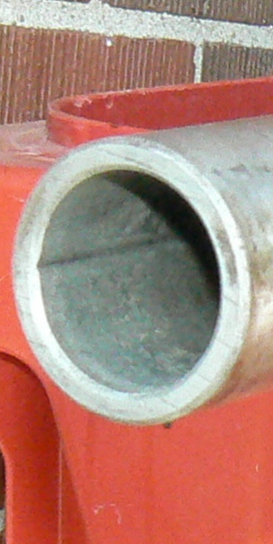

While on vacation the past 10-14 days, I had one 10-e/r way tube soaking in potato soup. Upon returning, it was removed from its container(yes it is reminiscent of working on stopped up plumbing). The outside was red rust free but with some black oxide spots. The inside was however NOT as pristine as I had wished it would be.
I went and purchased some Evaporust and filled the tube(after plugging the other end). It took just over 1 quart to fill it. I checked it after a couple of hours and decided to let it soak over night.

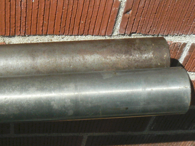

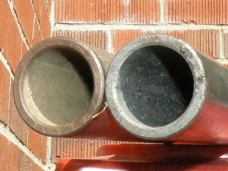

Although NOT a b4 and after, the comparison photos include the other(of a pair) of the way tubes with NO 'treatment'.
[ATTACH]4156[/ATTACH] 4/26 Added after pix of 2nd tube after onite in Evapo-rust. [ATTACH]4192[/ATTACH]
[ATTACH]4157[/ATTACH] [ATTACH]4188[/ATTACH]
I am treating the inside of the second tube tonight with evaporust b4 placing in potato soup. Will add pix to this post as timely!:) 4/25/ added after pix of second tube after onite/evaporust
AFTER such excellent results with the inside of the first tube, I decided to use a 2" pipe(similar to the potato soup 4" pipe) and totally immerse the tube over night in evapo-rust. It required just over 2 quarts. Since I had originally bought only 2 quarts, it was not totally submerged(about 8-10" short). The opposite end is now being 'treated'. If you were to decide to do this, I recommend purchasing a gallon(I predict I will find MANY occasions to use this stuff)!
The surface seems to 'glaze' over rapidly and I suspect this is new rust forming. The evaporust if not wiped/washed quickly turns slightly stickey. The instructions recommend a coating of evaporust to prevent rust up to 2 weeks.
THIS STUFF ROCKS!!!!!
