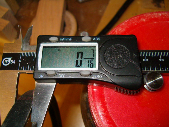

The Diameter of the Gates belt decreased from 15/32" (0.461") to 29/64" (0.447") in approximately 125 hours of use.

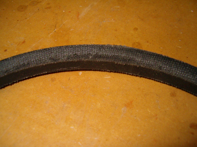

The used belt is on the top - New belt on the bottom[ATTACH]4174[/ATTACH]

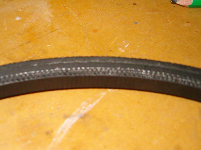

Scuff mark on one part of the used belt
[ATTACH]4175[/ATTACH]

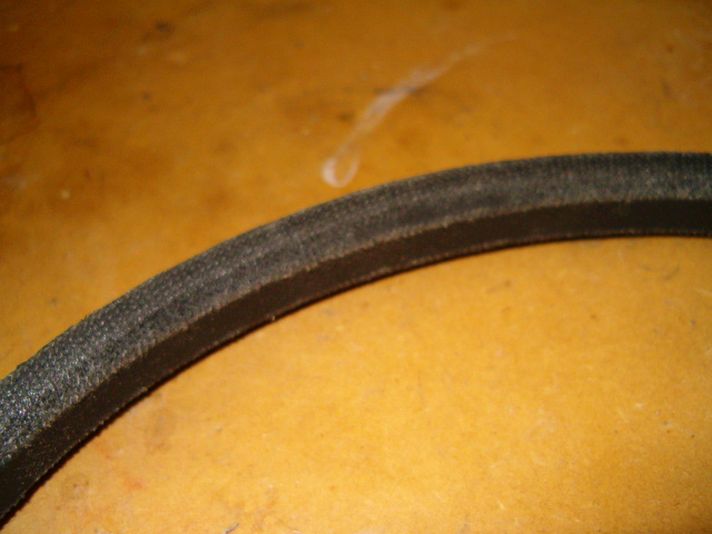

Scuff marks on another part of the used belt
[ATTACH]4176[/ATTACH]
Shiney edge of used Godyear Belt - showing thicker, more firm sides
[ATTACH]4178[/ATTACH]

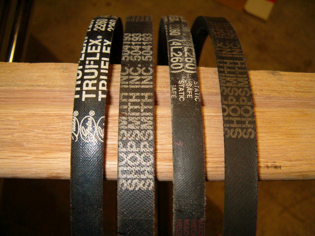

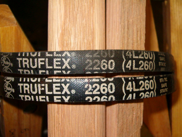

It was interesting to me that both Gates and Goodyear belts are approximately the same thickness from outside to center. However the Goodyear belt has a firm, flat top, while the Gates is crowned.
All 4 belts side by side
[ATTACH]4177[/ATTACH]

Measurements showed the wear on both belts was even from the outside edge to the bottom edge. In other words the sides wore evenly. Although the Gates showed scuffing near the inside edge of one side of the belt, but not the other side.
Cant say that this showed me anything except the narrower belt got narrower (down to a minimum diameter) sooner than the wider belt. This, of course is a no brainer and was expected.
Diameter measurement of Goodyear belt after one year's wear
[ATTACH]4179[/ATTACH]
Diameter measurement of Gates Belt after 8 month's wear
[ATTACH]4180[/ATTACH]
