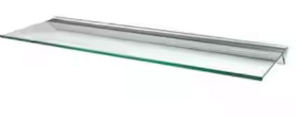

I have four – 30”x10”x1/4” tempered glass. Somewhere I saw a way to suspend these using one or two hardwood strips but can’t find anything on the internet.
It would be somewhat like this picture.
Glass Shelf.JPG (5.95 KiB) Viewed 1255 times

You could us standard floating shelf brackets for wood shelves. Attach a strip of wood just large (thick/wide) enough to mount the bracket and put a groove in the front face to accommodate the glass and epoxy the glass in the groove.
