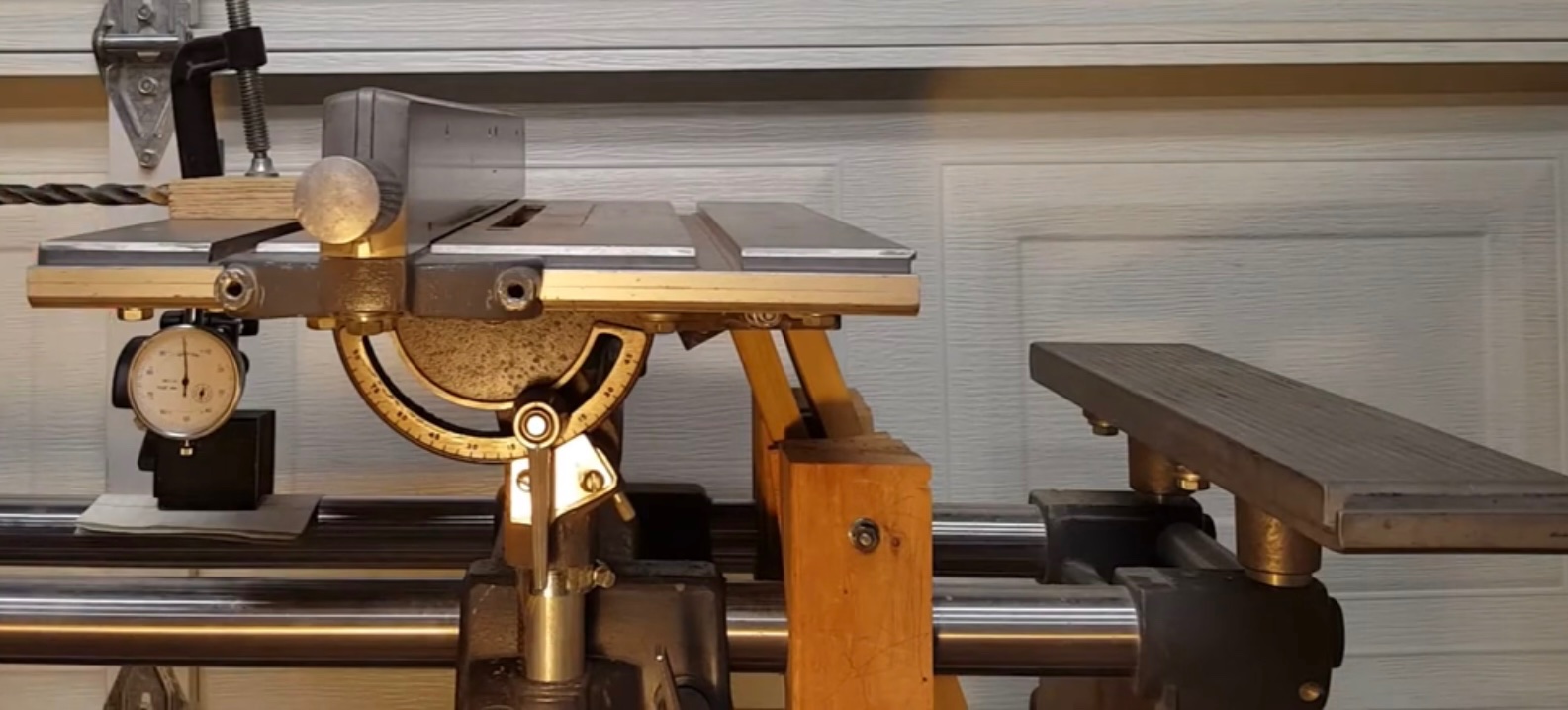

Well I’ve got the lathe pieces accounted for and am working on aligning the table. It appears I have a unit from 1983. model in What I’m running into is the 4 bolts that hold the table when loosened and rotating the table to try and get it parallel to the blade, it comes close, but I’d say 4 thousandths off.
I tried adjusting it per the manual, but there isn’t enough play in the brackets to get it perfectly inline with the blade. I’m thinking of lightly filing a little bit of material out of the bolt holes to give it rotation room. Something might have been slightly tweaked over the years….its only 41 years old lol.
Is that an acceptable practice given the situation?

I shot for parallelism to within .003" and can achieve that if I persist but why. That b{.003") is far more precise than required.ArcticsShop wrote: Wed Mar 06, 2024 11:23 pm Well I’ve got the lathe pieces accounted for and am working on aligning the table. It appears I have a unit from 1983. model in What I’m running into is the 4 bolts that hold the table when loosened and rotating the table to try and get it parallel to the blade, it comes close, but I’d say 4 thousandths off.

That seems like a last resort and you've only just begun the process. Since you used the lathe feature, how well were you able to align centers on the headstock and tailstock?ArcticsShop wrote: Wed Mar 06, 2024 11:23 pm I tried adjusting it per the manual, but there isn’t enough play in the brackets to get it perfectly inline with the blade. I’m thinking of lightly filing a little bit of material out of the bolt holes to give it rotation room. Something might have been slightly tweaked over the years….its only 41 years old lol.

On many early Model 510/520 systems the rear trunnion has smaller mounting holes than the front, which limits adjustment range and can cause binding. A lot of ink has been spilled on this, and not everyone here is in agreement, but solutions range from leaving it alone to drilling both holes out to full size like later production. My preference is to leave one hole small as a pivot, and drill the other one out. IIRC the 'small' holes are ~ 3/8" and the large are 1/2". It is a perfectly acceptable practice.ArcticsShop wrote: Wed Mar 06, 2024 11:23 pm Well I’ve got the lathe pieces accounted for and am working on aligning the table. It appears I have a unit from 1983. model in What I’m running into is the 4 bolts that hold the table when loosened and rotating the table to try and get it parallel to the blade, it comes close, but I’d say 4 thousandths off.

I hadn’t thought about drilling it out, but that seems like a good option. I realized this morning that I slightly misrepresented the situation. The only blade I found the tooling for at the time of posting for was some appropriately 5” blade “looks like a dado blade or something, translating that lack of alignment out to a 10” blade it’s going to be double the misalignment I’m seeing here. And that’s the primary concern.DLB wrote: Thu Mar 07, 2024 9:19 amOn many early Model 510/520 systems the rear trunnion has smaller mounting holes than the front, which limits adjustment range and can cause binding. A lot of ink has been spilled on this, and not everyone here is in agreement, but solutions range from leaving it alone to drilling both holes out to full size like later production. My preference is to leave one hole small as a pivot, and drill the other one out. IIRC the 'small' holes are ~ 3/8" and the large are 1/2". It is a perfectly acceptable practice.ArcticsShop wrote: Wed Mar 06, 2024 11:23 pm Well I’ve got the lathe pieces accounted for and am working on aligning the table. It appears I have a unit from 1983. model in What I’m running into is the 4 bolts that hold the table when loosened and rotating the table to try and get it parallel to the blade, it comes close, but I’d say 4 thousandths off.

This is a photo of an identical table pulled off a YouTube video. My literature is dated from 1982-1983, but it could certainly be an older or newer unit than that-my understanding of the model change eras is imperfect at best, but I’ll venture a guess that it’s a “Mark V 500 series” if I get everything else dialed in properly and it proves worth the extra expenditure I may upgrade to a 510 or later table system.
